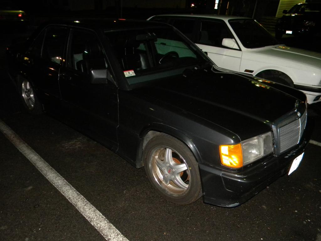

    A couple of better pics from earlier today:
    The car is much better than we were expecting. California car since new, until the current owner drove it over to Boston last summer. Straight chassis without any accident history and zero rust. A compression test showed that the engine makes exactly 180psi across all 4-cylinders. The close-ratio, Euro dog-leg Getrag box is perfect (just needs the shift linkage tightened up). The only problem is the sloppy rear diff, but that would have needed to be strengthened for track use anyway.
    Now we've got some big decisions to make:
    • Factory Gruppe-G springs with custom-valved Bilsteins, or H&R Nurburgring-spec coilovers?
    • Leave the 2,3-16 body stock, or build a full-on 2,5-16 Evo II replica?
    • Run it in vintage racing, or build for NASA GTS?
    The fun begins...

    Now we have a car. It just arrived. Couldnt be happier. Zero rust, engine checked out at 180 straight across all 4 Cylinders... Interior needs work and some minor other things but a perfect car for the plan...
    More pics and project plan to follow...
