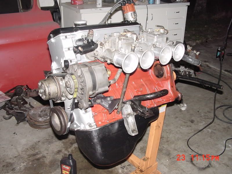

    Well I have been lurking around here for some time and figure I should actually post something up for once. I used to own a 78 320i that I absolutely loved....
    Unfortunately I had to get rid of her as it was my only car and the 4 and 5 year old couldn't stand south Texas heat with no A/C.
