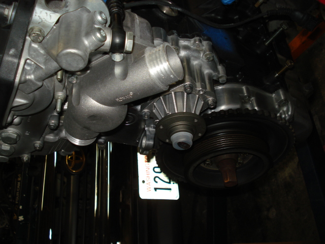

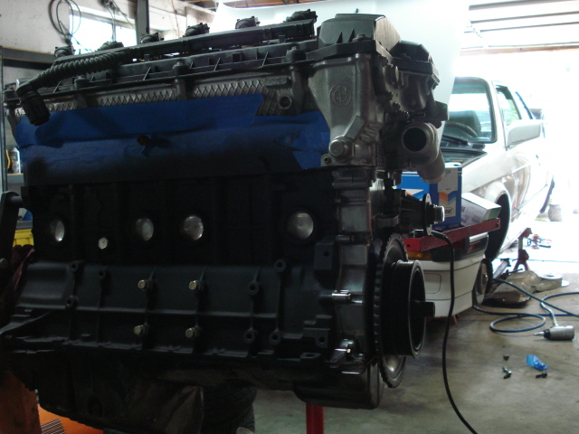

After collecting parts for a few months I am almost ready to start tearing my E30 apart. I will be swaping out the M50NV for a OBDI M52B28. I am also going to clean up the engine bay as I swap the new engine in. I'm hoping that by making a build thread that it will keep me motivated to finish it.

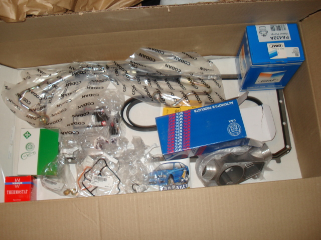

A few things that I have collected so far.
