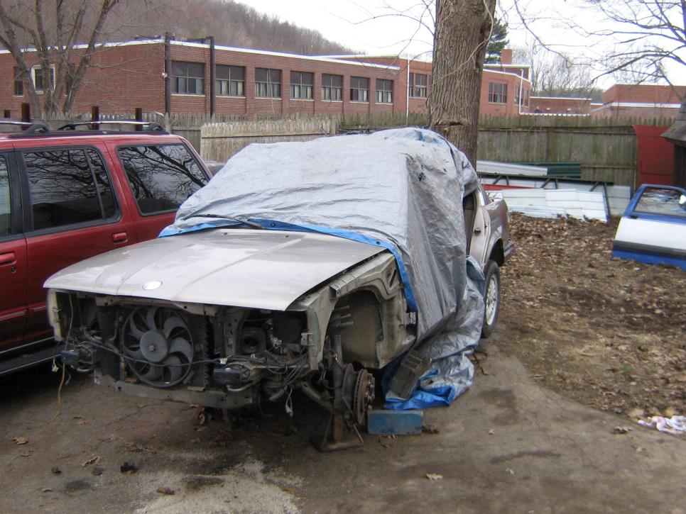

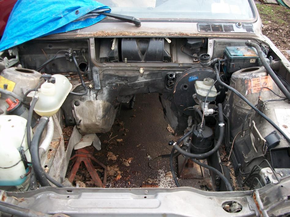

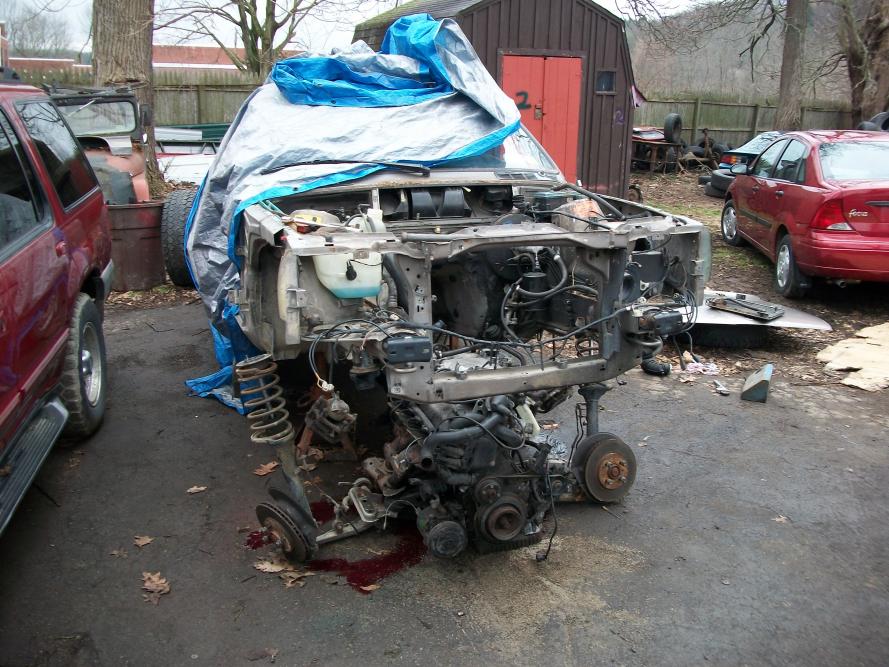

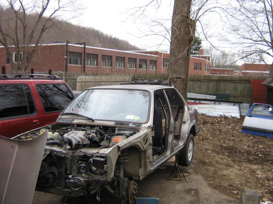

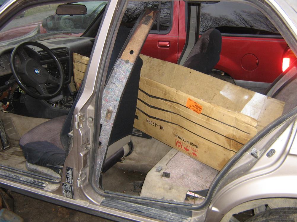

    So I thought I would go over and start some work
    I started by cleaning and throwing away useless crap like the trunk panels and tar flooring. I just wanted to get her hassle free.
    I jacked it up and put 4 stands under it to make life better.

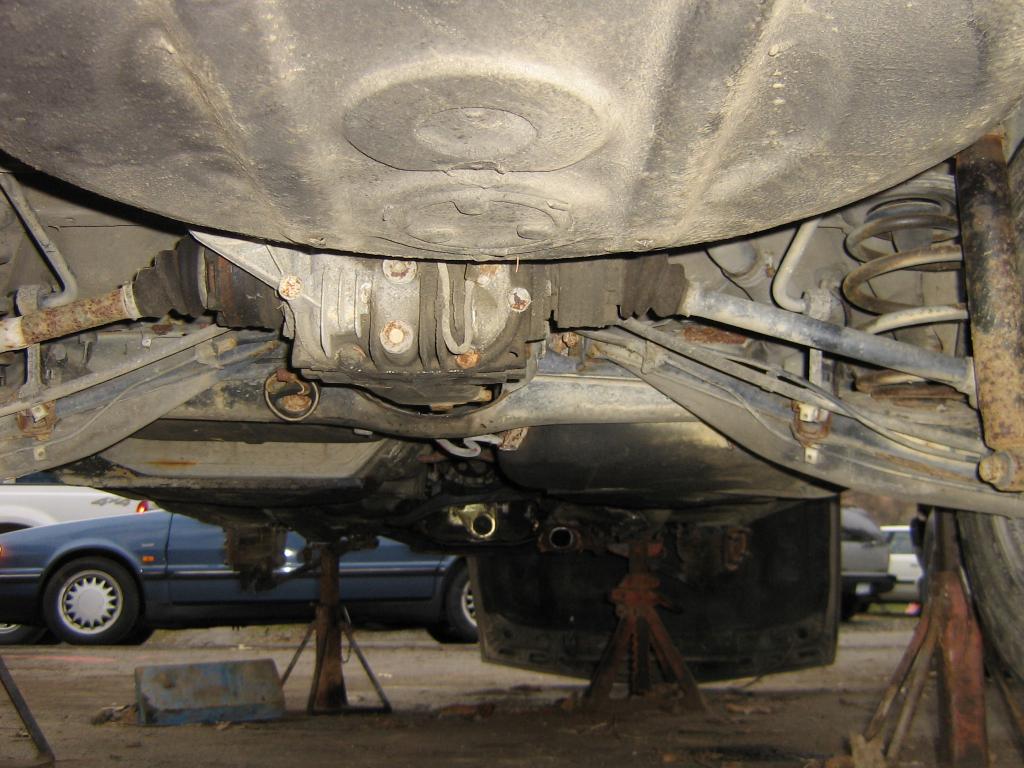

    I then took off exhaust from headers back and the the heat sheild off to work on the shaft and rearend. But got bored so I moved to the bay and took out the SUPER clean radiator, drained coolant and auto tranny lines. Removed the ECU and wiring from inside the car. I also got most of the block free.
    Tomorrow will (depending on rain hold out) be get bolts to put all four doors and trunk back on. The owner before me threw away the bolts but saved the used spark plugs, go figure?
    If it is not raining I will get engine, tranny and rearend out.
    I am really sorry about not having pictures for the start of the build. I will find my camera tomorrow I hope
    On a cool note, from the catalytic converter and radiator I might break in the profit zone! Local guy who buys them will give me 150 easy for the catalytic. So with the cat and rad I am sure I will get close to the 250 I spent on the E30

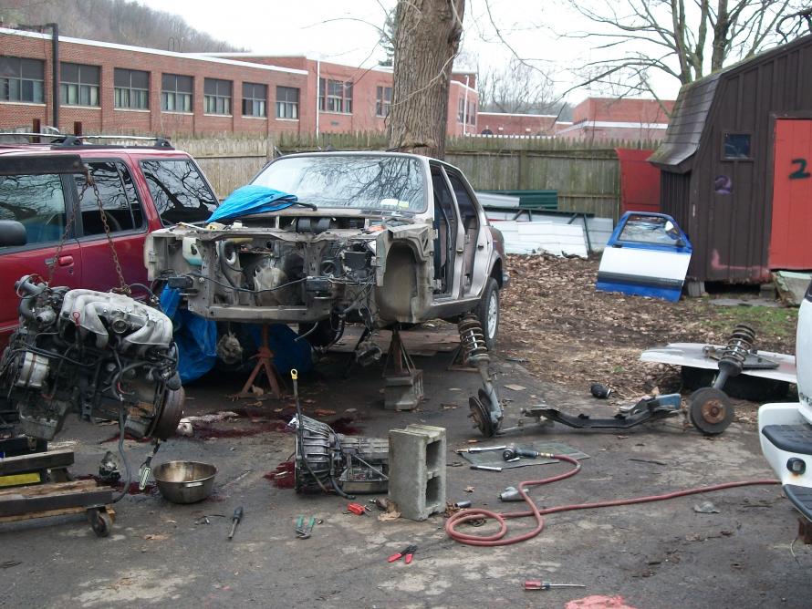

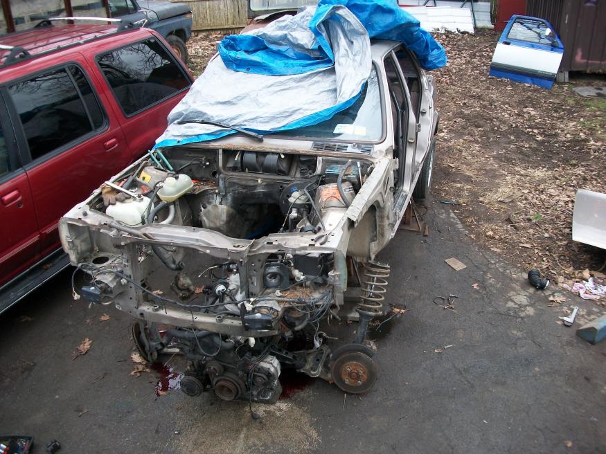

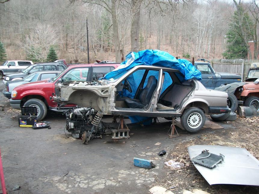

                Update: went for the 260 getrag Saturday, got out all but one inverted trq bolt. Snapped two extensions The yard closed so Monday I'll have that.
                Went and did some more work and found a CAMERA!!!!
                Instagram: @BWeissLeather
                Current cars:
                ~ '87 325 M30B35 swap
                ~ '87 535
                ~ 01 540 Msport 6spd
                ~ '06 X5 4.8is
                • F34R
                  sLaughter
                  • 12385
                  Got some more work done:
