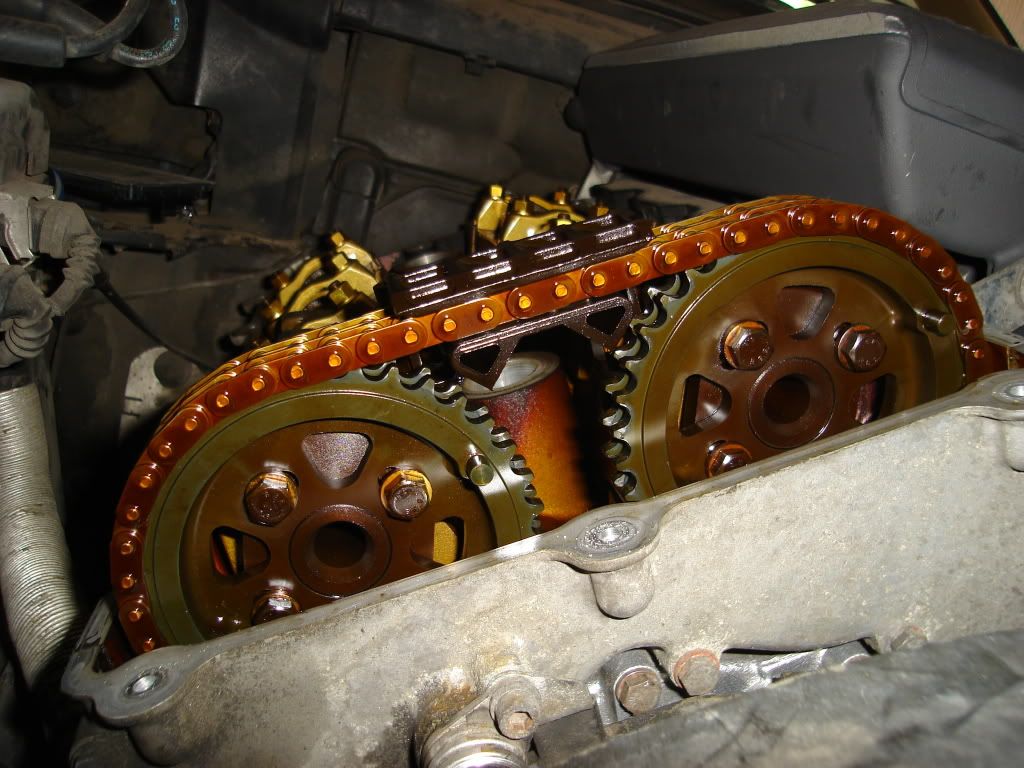

        Unfortunately those sprockets look toast. For refference here's how they look when worn but still OK condition. This engine had about 140k miles at the time.
        Good luck with the repair.

          Yep, those are definitely done.
          Replacement isn't too difficult :)

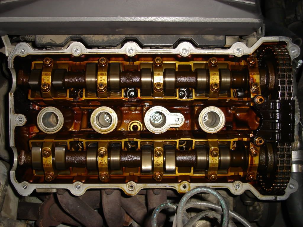

            Does anyone have pictures of some proper m42 cams/lobes to compare with mine?
            Just trying to see how much more abrasive mine are than what they should be.

              They should look more like an upside down u, Not like this: ^
