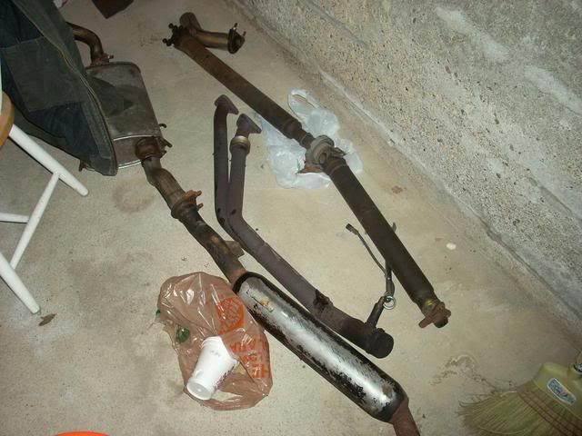

    But, i haven't gotten to the worst. there's a hole in the trunk, I took off the exhaust to get a better look at it, started rubber-maleting away with it and a large amount of rust fell out.pretty much the whole bottom of where the spare tire jack is kept is rusted out.
    which caused massive amounts of surface rust in the trunk.
    now, how do I go about fixing that hole? Not parting the car out, don't bother asking. No rust in the spare tire well surprisingly.

                        -Finally got motherfucking Guibo out, should of used PB Blaster, as one of the guibo bolts rusted itself to the sleeve inside the guibo, making it even moar possible to remove. Can I get rid of that motherfudging metal sheild?
                        The driveshaft just came out with some WD-40, and a 17mm Wrench

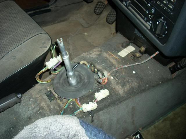

                        Center console out. The PO of this car kept it horribly dirty, it's truely disgusting, the amount of dirt, dust, and Sand (This guys Last name was Beach afterall) that accumilated in this car.
                        Also found some hackage, turns out my clutch safety switch was bypassed....
                        Valve cover needs some loving, along with most of the wiring.
                        I has a question R3Vlimited dudguys. Do I need to support the engine with a floor jack if I'm removing the tranny? And also, how do i get all that crap off around the shifter to get to the bitch clip?
                        Thanks

                          I didn't bother supporting the engine while the tranny was out.
                          Bitch clip?
                          1992 BMW 525iT Calypso
                          2011 Jeep Wrangler
                            you talking about the clip that connects the selector rod to the tranny/shifter? or the little guy right on the end of the tranny that's impossible to get to? my solution was to drop the transmission.. and pull the motor.. and swap M50.. etc.
                            so basically, don't listen to me =P

                              Oh, Thought you did it from up top.NVM then. I assumed it would be a pain in the ass.
                              I can discard that metal shield around the guibo right? Its just a pain in the ass in everyway to install/uninstall the guibo while its in there.
