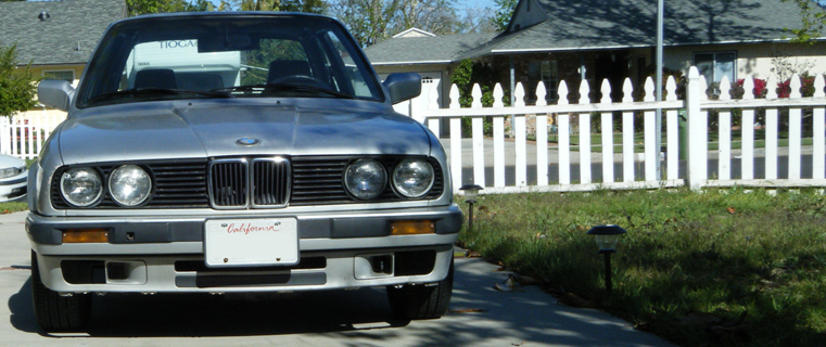

    not much but here it is. bought this back in sept. its got high mileage. 200k+. the front suspension in think is h&r sport springs and bilstein shocks. the rear is stock i believe. beautiful bottle caps. nice missing IS lip. also matching missing Fog lights. slightly bent valence on the driver side. faded paint. thrashed interior. cracked dash. so far it runs pretty well. i had some heating issues but i took care of that by refreshing the cooling system and dropping in a mishimoto radiator. engine is all stock as far as i know. except for cooling. oh the A/C doesnt work and i bypassed the heater cuz my heater valve pissed on my leg...quite literally. i just threw on the euro grills. and i have a ton of parts that i cant wait to start putting in and replacing. as much as the money permits.
    Looks nice for 200k
    It looks like your missing a radiator fan unless its mounted in front of it.
    M42: Because 110 feels like 140 :finger:
      Mishimoto M50 radiator?
        rad rad dude.
        paint sucks

          all e30's have a fan infront of the rad ;)

            the radiator keeps the engine so cool that i havent had use for the fan yet. i ditched the clutch fan and have a mishimoto elec fan that i will install if i need it.
            Mishimoto E36 Radiator. its a direct swap for late model cooling systems. with the exception of the m42 like mine. some mods are required.
            haha. mos def.
