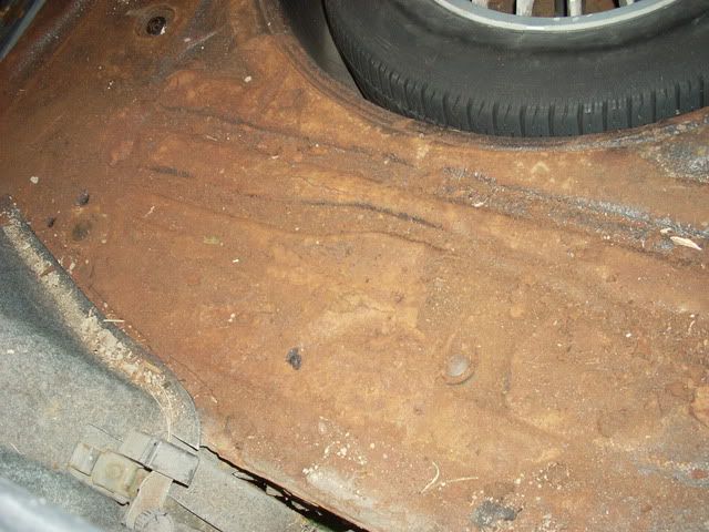

    The hunt for rust. Basically the rear corners need new sheet metal.
    You can see the ground through the battery location:
    Most useless spare tire ever. No air pressure, completely unevenly worn.
    Stripped out the trunk. Hot damn that 'sound insulation' is heavy! Makes me wonder if it's actually a weight ballast. The rust here is purely light surface.

    hahaha yes it is. good score. check for rust under driver side and passenger side under carpet
      I wish i had your trunk rust....
      Consider yourself lucky.

        dont put a spare in there, hit a bump and its gonna fall right through. lol, how would you like to be behind a car on the freeway when that happens.
