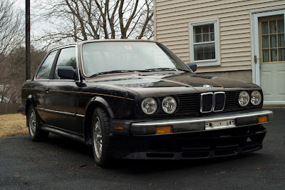

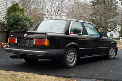

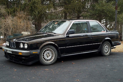

    Thought I was going to use her as a parts car for my '88 SETA build, was convinced over a couple beers to run the 2010 LeMons event at Stafford CT.
    This is what Craigslist and $400 will get you... a non-running '86 ES.

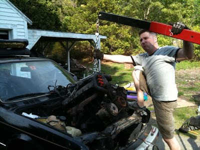

          After about an hour of prep, we jerked the motor out of the car.
          That's Ryan C looking all tough and man-like.
          Waiting on a rear seal and oil pan gasket, so we're in a holding pattern on getting her running.

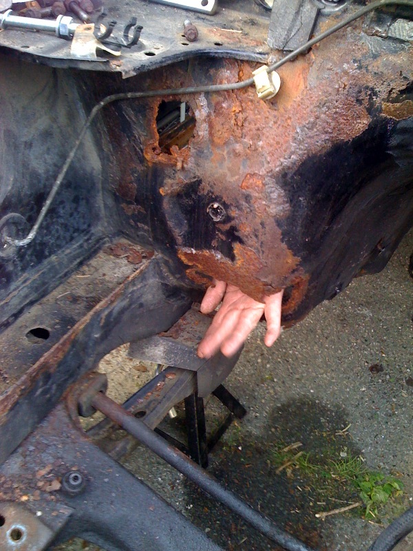

                  Now we know why it's a $400 car...
                  On top on not running, the passenger-side footwell and floor pan is swiss cheese.
                  Knew that the car was hit on the front right, but whoever did the repair did a shit job.
                  Looks like some cutting and welding will be done before the motor goes back in.
                  Hope the chassis is straight...

                            lots of good progress made on the LeMons car today; I got the sunroof skeleton removed, JP removed rot from the firewall and passenger side floor and began the welding by repairing the hole in the floor with about $2 of sheet metal and a piece of the sunroof frame for bracing. That kid's got made welding skills, y0! We also ripped off the PS pump to reduce weight, things that could possibly break, and generally simplify our ride. I can't wait to start getting this thing put back together and out on the track!
