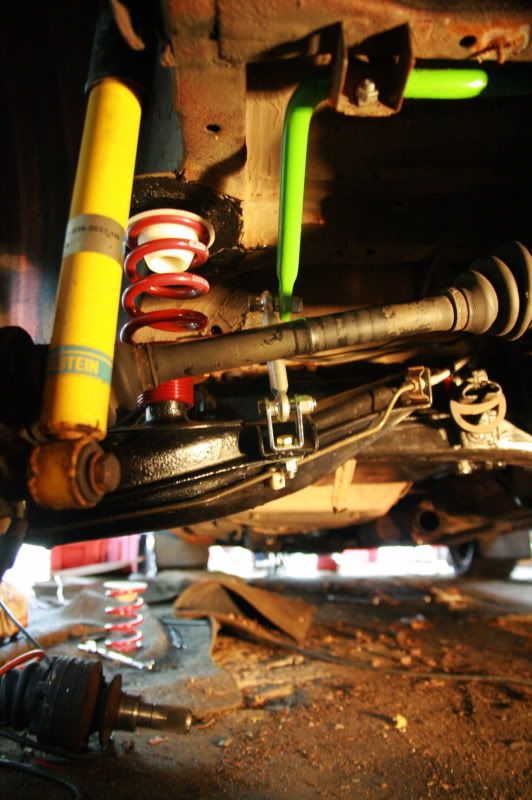

    yea; if anyone has any pointers of where to watch out...the frame rails are in awesome shape compared to my old car. I POR15'ed the gas tank because it was rusted on it's entire surface and POR 15'ed the subframe/trailing arms while they were out. I plan on spot treating the rust then re-undercoating the car after I have settled in my new apartment.

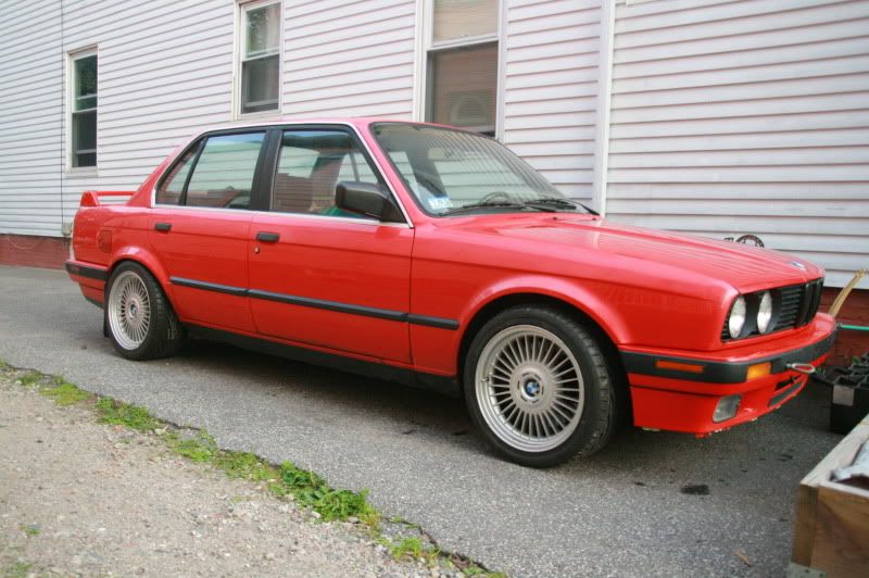

                        here's how the car sits now, in all it's faded glory. The wheel is as centered as I could ever imagine.
                        97 M3 control arms
                        M3 Offset bushings
                        E36 M3 hubs/spindles/knuckles
                        E36 M3 Calipers/rotors/pads
                        E30 Brake lines

                          not sure if i just missed it but what did you do for 5 lug rear? i have some 17x8 style 5s et20 and i don't want them poking out crazy if i go the e36/z3 route in the rear.. could you take some straight on shots of what the wheels look like stance wise? thanks
                          correction: i did read past it lol. so you just got 318ti hubs/brakes and put them on your original trailing arms? or did you just use the whole ti setup? your rear doesn't look bad at all as in sticking out.
                          2003.5 Imolarot M3: daily
                          1995 Alpinweiß M3: hpde
                          • psyber_0ptix
                            • 904
                            i was going to do the whole bearing spindle swap on the original e30 hardware, but it would have cost over twice as much as I payed for the ti stuff. I just used the entire trailing arm/hub/brake setup off the ti to get it done fast.

                            • unloadedak
                              • 1197
                              so no fender rolling? what does the offset look like as well?
                              • psyber_0ptix
                                • 904
                                Rear fenders are rolled a bit, fronts are untouched.
                                It's going to be rainy this week but i'll try to take a pic from the rear and straight on to show caster. Just been busy lately with stuff; i'll try to update more soon
