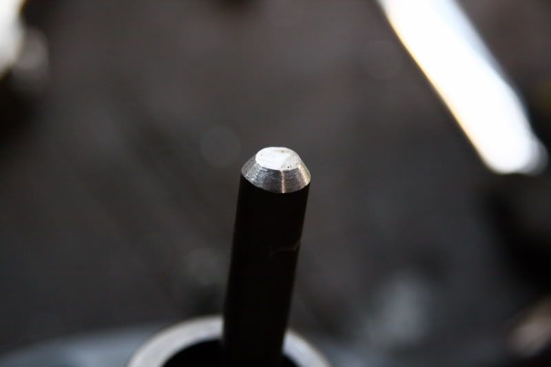

    because i was using a 320i booster, i had to cut the pushrod which was m10 at the clevis...but the shaft is m12.
    cut and beveled
    threading
    drilled the clevis out and tapped to 12mm (old on right, new on left)
    shortened and all set!

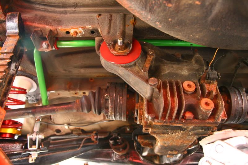

              just catching up on some other maintenance stuff while i'm waiting on the proper injectors to be sent.
              Replaced the driver front brake hardline and installed a braided line to caliper
              Lowered the rear diff and subframe a little to access the bushing
              Used a small hack saw to notch through the bushing sleeve in two places and slowly hammered the bushing out.
              Next to the AKG 75d rear diff mount
