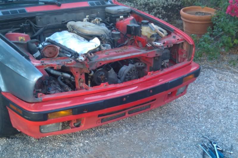

    Core Support Damage

                            Finals wrapped up and I tore into the eta shell. The m20 had broken a Timing belt and the valves and pistons got together for some sweet sweet loving. Only picture I have of that progress.
                            Yes being the broke student that I am, without an engine hoist, I dropped the subframe and engine together. Only took 3 hours and a black widow or two for me to get it out, but then I had to wait for my friends bronco to pull the pallet out from under the car. This front suspension will go on the 325i and the 5lugzzzz will go on this. The 325i's motor still runs like an industrial strength sewing machine. I'm not sure of it's fate yet.
