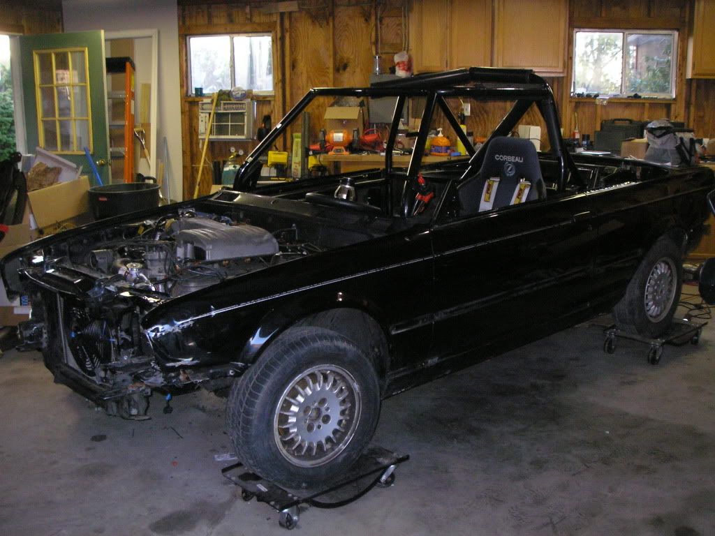

              It started on the 14th with the final push to get the car out the door and on the track for a test session during the Import/Kit Car Nationals at the Carlisle Fairgrounds on May 21-22.
              A long list of tasks was made, and the team got to work on making that list disappear.

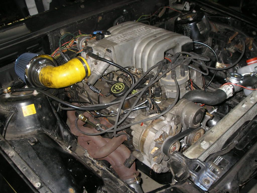

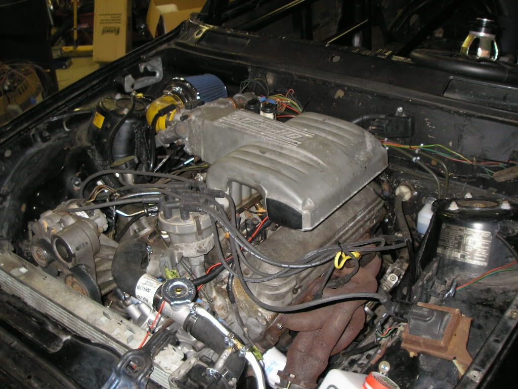

              First, the engine had to come out to make some room for the clutch fork. The team is pretty proficient at this now, and it only took a matter of minutes. The hammer came in, and the appropriate beating began. Within an hour of the start of the day the engine was back in its (final?) resting place.
              A new fuel filter and rubber lines were installed, and the chassis hard lines were attached to the engine hard lines. The clamps were double checked for tightness, and the fuel system was complete.

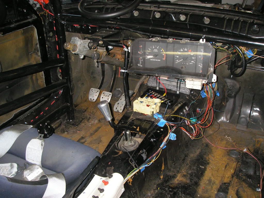

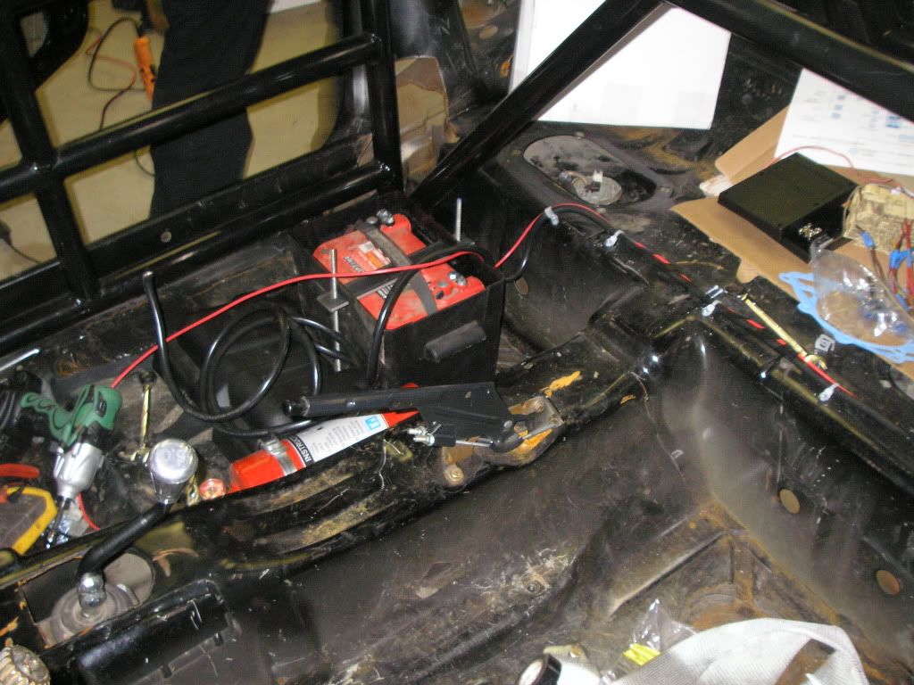

              The electrical system was next. The battery is to be mounted where the passenger seat used to be. This allows a shorter wire run, and doesn't leave the battery vulnerable to hits, as it might be in the right rear quarter as was stock on other E30s (but not the convertibles for some reason).
              Even though a sealed battery is being used the battery was mounted in a marine box. There is a 1/4" thick steel strap under the floor, and one on top of the battery that are bolted together with threaded rod. The lid is then attached with the supplied strap. The battery is now a part of the car, and is going no where.

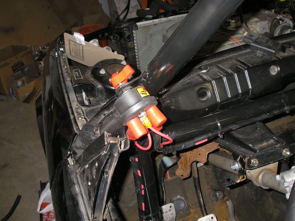

              A wire was run from the battery to the kill switch, then to the starter solenoid. The other circuit in the kill switch goes to the ignition/ecu/fuel pump/any other electrical system. Rubber boots were installed on all terminals, and we moved on to the more complex part of the wiring. (There are now boots on the smaller terminals as well, they just weren't available when we did the initial wiring.)
              A distribution center, and fuse block (factory Mustang part) were installed on the transmission tunnel. The ECU will be installed further forward, on a foam pad. The relays were mounted, and the switches wired. It was intended to be completed on this work day, but as these things go it took much longer than expected.

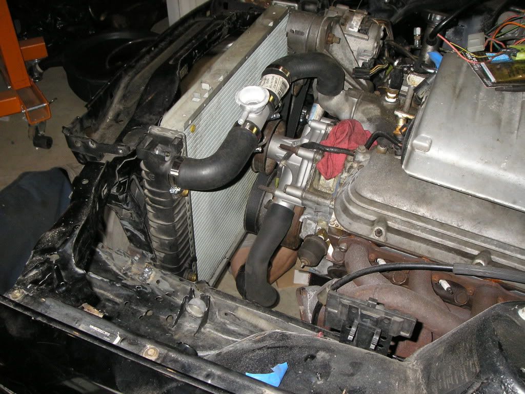

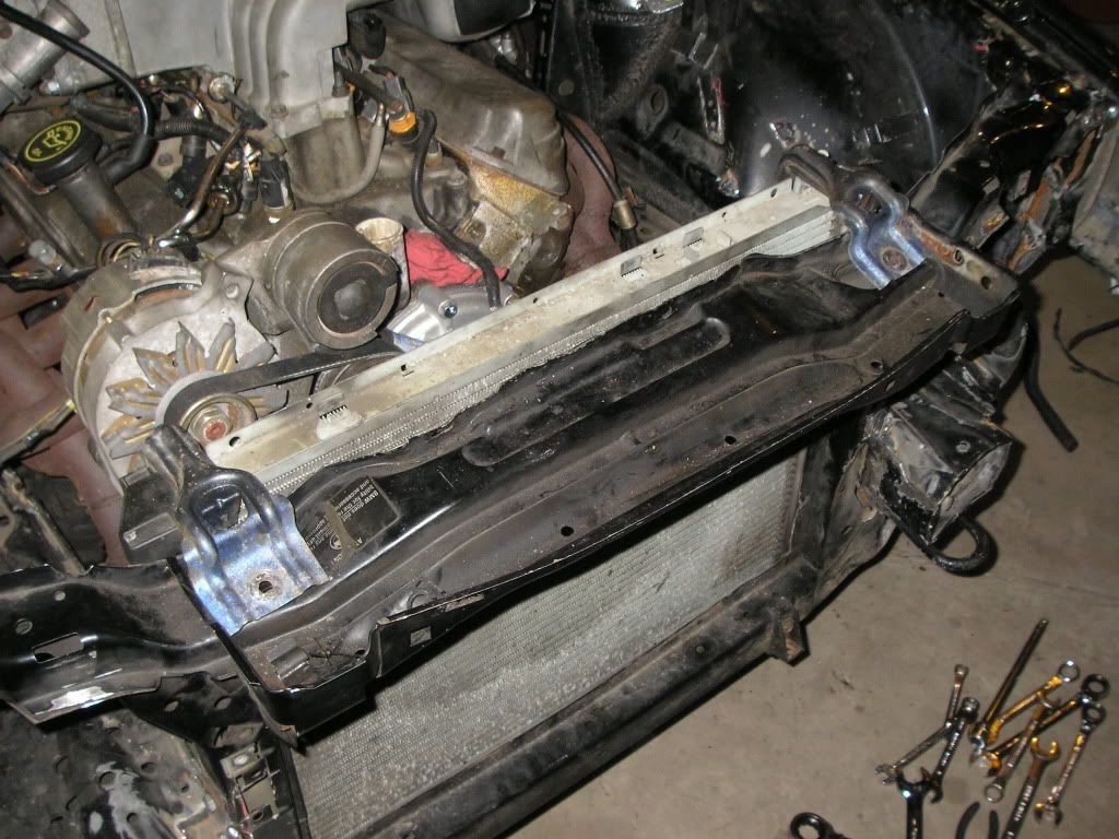

              The cooling system was the next thing on the list. We found two hoses that looked like they could be cut to make our mismatched radiator work. We are using the stock E30 radiator. The bottom hose was made from 4 pieces of the radiator hose, and 3 pieces of pipe (steel roll cage tubing). The hose was zip-tied to the radiator support. This should give us room to run the exhaust behind the radiator hose.
              The upper hose was made of two pieces of hose, and an inline filler neck was added, as there isn't one on the radiator itself.
              We used the Mustang upper radiator mounts as the BMW ones were missing from our car.

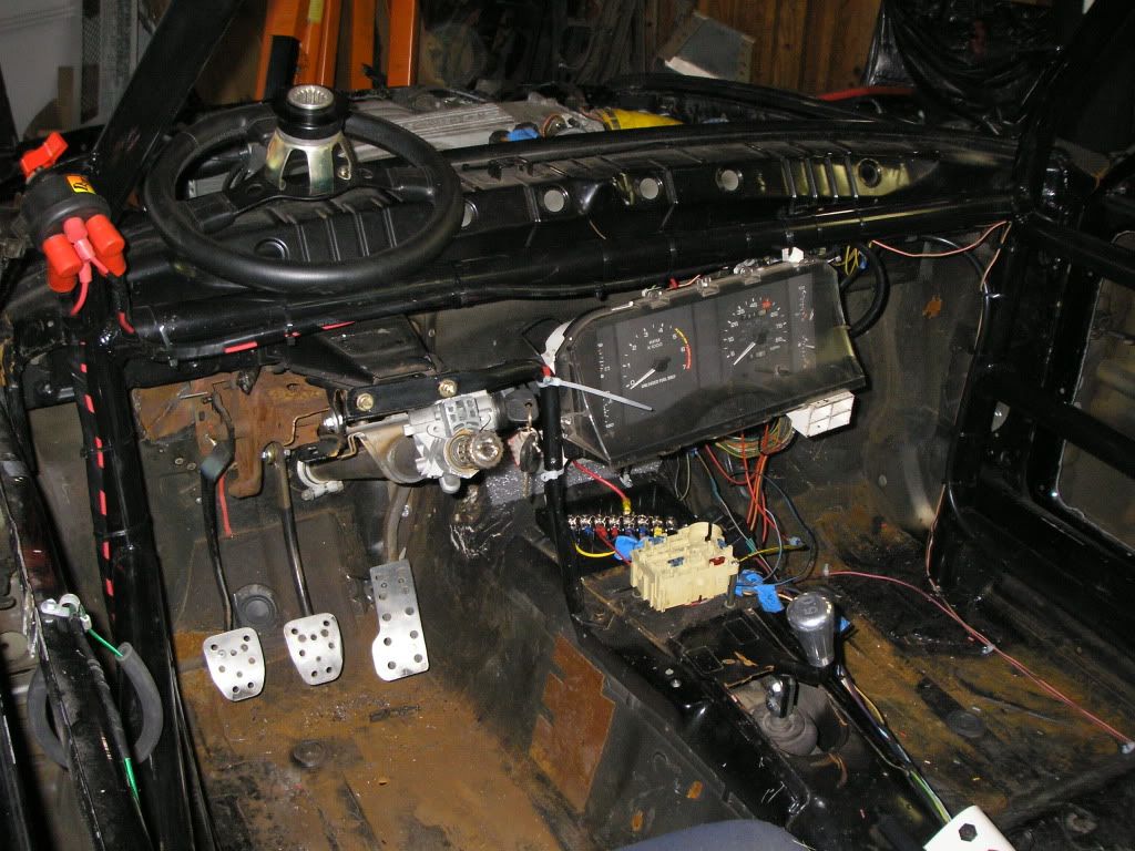

              We are re-using the stock Mustang instrument panel. It has all the gauges we need, and the wiring is fairly simple. The fuel gauge will read backwards (BMW is high resistance when empty, Mustang is High when full). The only logical place is in the center of the car attached to the roll cage and the steering support. It seemed weird, but Jim drives a Prius so he is used to it. We don't have the heart to tell him that we won't be installing a backup camera.

              Throughout the week the team worked on getting the wiring done. The final result is pretty clean, and will be better when the wire conduit is put back on. It will remain unwrapped until everything is proven to be working.
              Wiring was run to the fuel sending units, and the pump. Extra wires were removed from the harness, and everything was bundled together to clean up the harness.
              We had to make a dipstick tube to plug the hole in the oil pan. The old dipstick was left in place to plug the hole in the block where it used to reside. The dipstick is there, but doesn't do anything. The new dipstick tube is a piece of fuel line, and a bracket that was found on the garage floor (we think it was for the fuel lines on the Mustang engine) was used to keep it in place. We also made a bracket to keep the fuel lines in place as they now are routed along the valve covers.
              The ECU was mounted on the transmission tunnel on a piece of foam. Zip ties secure it.

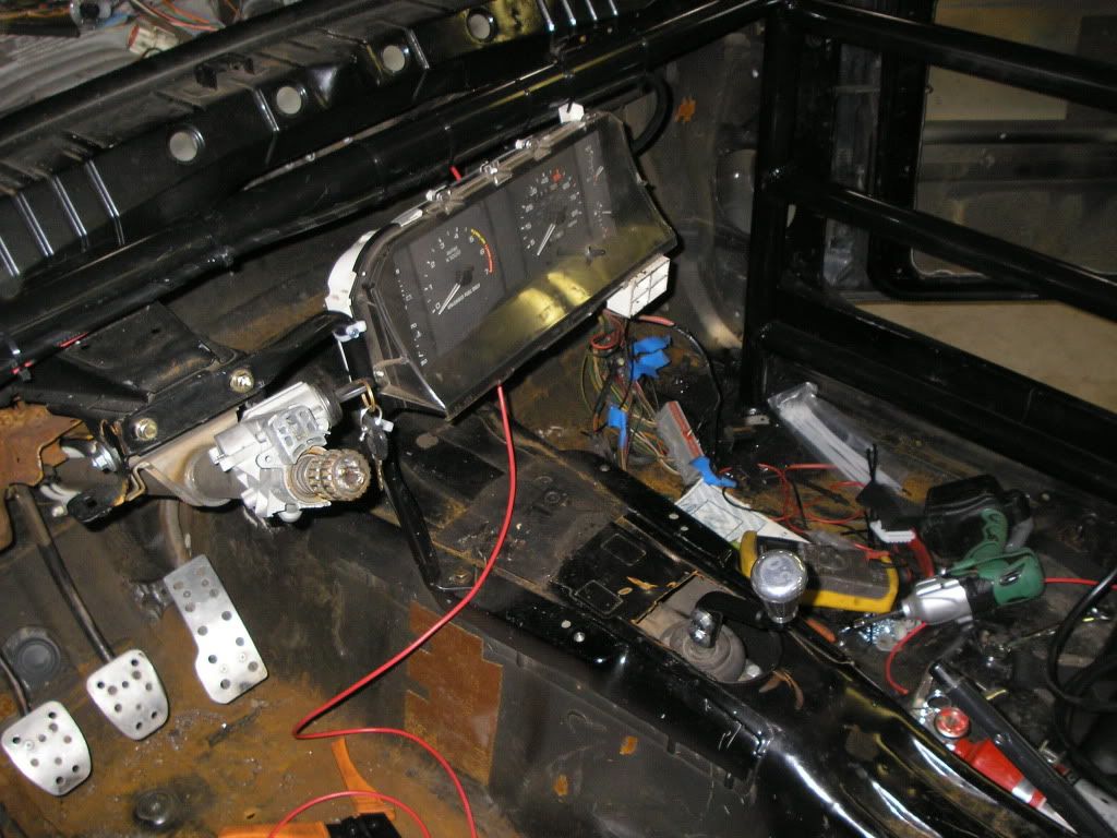

              Ryan and Dan began working on the car Friday evening not knowing the marathon that was in store for them. Finally after the distributor was installed, wires run. The engine was ready to come to life.....Well not just yet. Three or four more tries of distributor timing (one tooth this way, two that...) and finally the engine roared to life at 3:30AM Saturday.
              The harnesses were then installed, the seat bolted down, and final checks were made. The instrument cluster was wired and mounted again, and small details were finished.

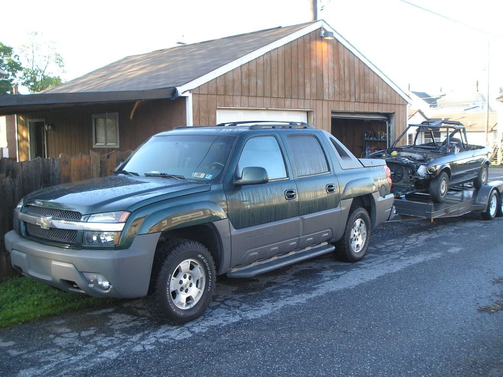

                The car was loaded on the trailer about 7:30AM for a 8:00 departure for the Carlisle Fairgrounds.

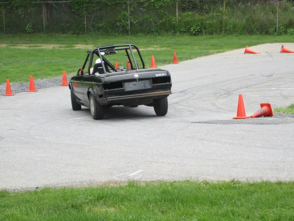

                The car took to the track during a lunch break, and made a handful of successful laps with no known issues. When the car pulled back into the paddock there was water spraying from the radiator. The vacuum cap was blown up and doing its best impression of a balloon. Another cap was added on top of the first, and the car was parked for the night, as there wasn't any more time to test the car in the normal autocross.
                The team was finally able to go to sleep.

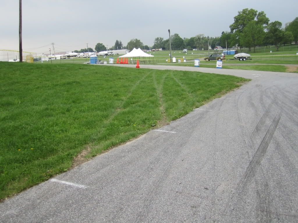

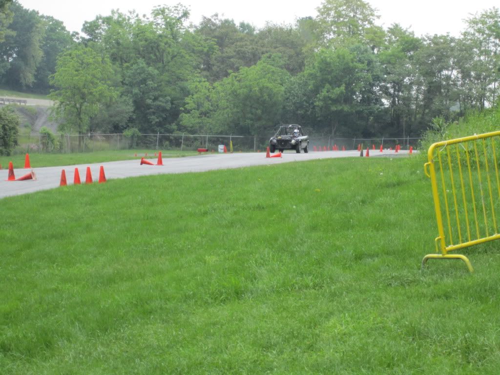

                Sunday morning brought with it lots of promise. The car was on the track before 9AM and everything was going well. After about 15 laps, Ryan ran out of talent and the car slid off the track. It finally came to rest after mowing over several large cones, and a fire extinguisher. The unfortunate sight of water spilling out of the bottom of the radiator was a sad but expected result. The bottom of the radiator support was unsupported, and bent back into the radiator breaking one of the mounting studs.
                Here you can see the tire tracks through the grass. The timing truck was about 15 feet to the left of the tire marks, and the cones and fire extinguisher were obviously right where they stop.
                The radiator was removed and dried, and JB Weld was used to fix the crack. The stud wasn't broken off, just bent over and cracked at the base. The rubber mount was placed back on top of the wet JB Weld to aide in sealing.
                The radiator was reinstalled, and filled, and no leaks could be found so the car took to the track for the final time of the weekend.
                Everything worked without a hitch (including the camera for the first time of the weekend).
