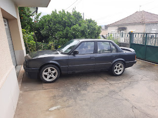

    And the engine from hell
    The idea is to put a m57 engine (3.0 diesel) and tune it to 250/280hp
    What i have:
    e36 coilovers
    5/120 16inch 8j et10 rh rims like my 15inch in the pic
    e36 compact rear trailing arms 272X10 discs
    e36 front nuckles 286X22 ventilated discs
    complete e39 530d for parts
    25% LSD typ 210 for the big case 530d diff 2,32 output
    325ix fender flares and side skirts
    mtech2 front fiberglass bumper
    big intercooler
    Right now i am taking care of the 5lug swap, rear is easy but the front needs 96/99 control arms and they are hard to find!

        i knew the wheel would stick out a little but i didn't expect that much :oops:
          Whoa! That is some poke. I don't know how much that can be remedied with rolling and stretching. Should be a cool project. You don't see to many diesel E30s.

                  Original 5 series e39 rims 7j 16 et20
                  i really thougth those would easally fit
                  now it's 4.5cm off the fender
                  i will now be looking for original discs and hubs that i can fit to the front to bring the wheel back to the inside
                    Azev A 16" ET20 7.5j rims
                    M3 e36 '96 control arms
                    E30 M3 bushings
