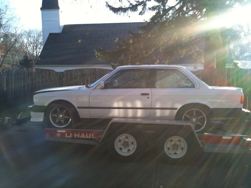

    Getting my car after 7 months :)

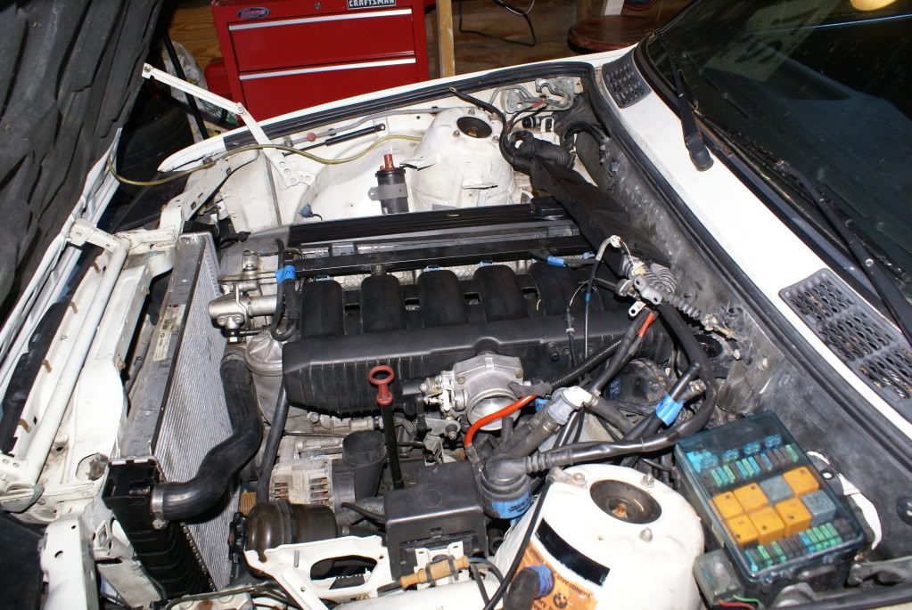

    Whats under the hood
    Deer guts from a collision somewhere between NJ and OH
    A better under the hood shot

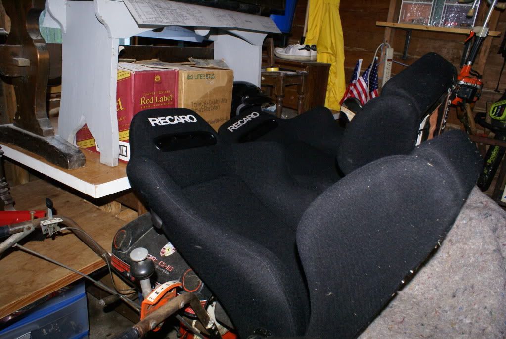

    These will take their place

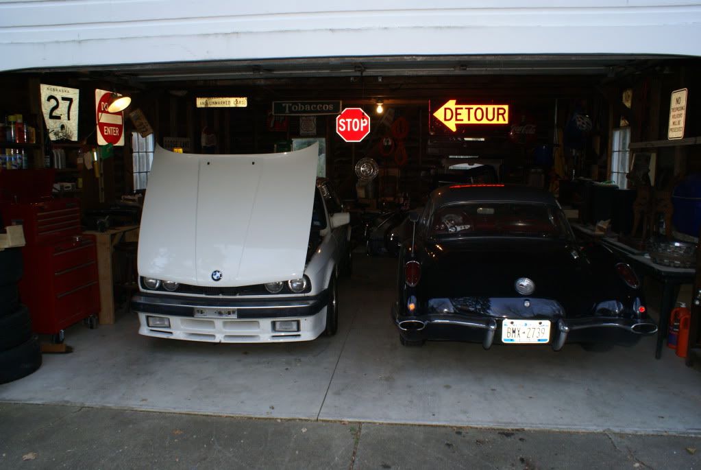

    Home sweet home.

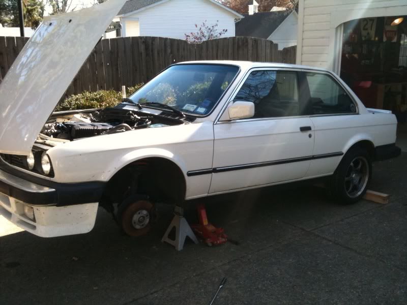

    Steering rack swap attempt...
    I spent about 2 hours trying to get the tie rod end out with no luck. That F*%ker is in there like no other. The car is still in this state, very frustrating. Any suggestions on how to get the damn tie rid ends out???
    That is all for now. Im going to try and pick up a few parts today and get back to work tomorrow/this weekend.
