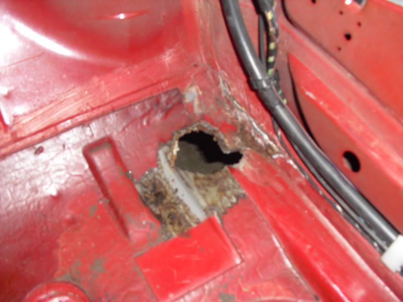

    Jack Pad rotted thru. Was but minor rust from the inside, but after some digging the whole pad is shot.
    Fire Wall, this was discovered behind my sound deadening panel. Get rid of the crude asap if you drive in nasty weather. Rot irks me so guess it's time to cut it out and weld in some small patch panels.

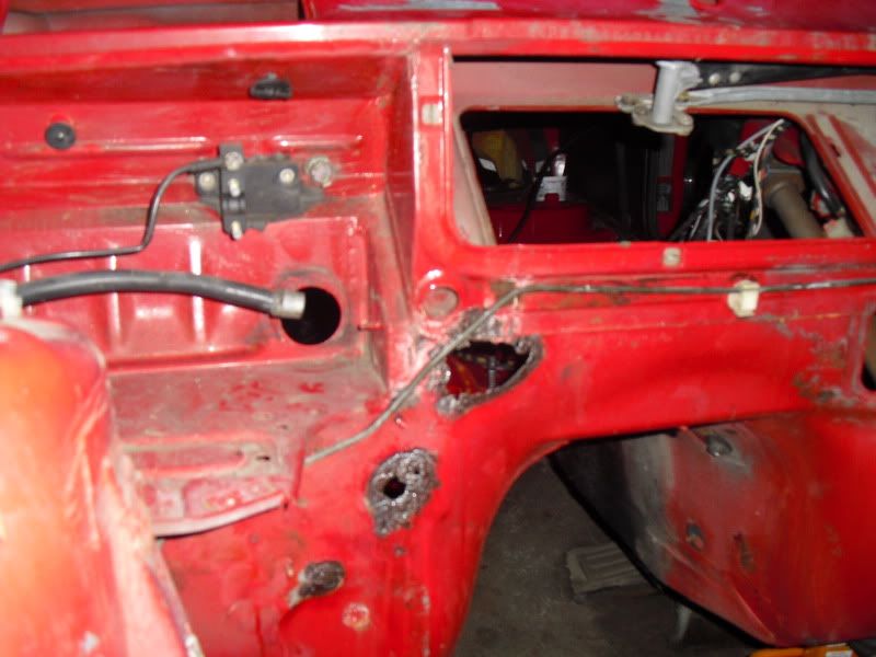

        Cut out the rot holes today, now to prep and weld in new patches.
        Need to work at my cutting skills

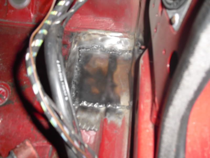

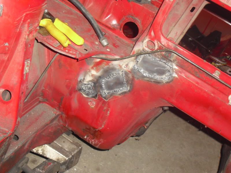

                        So MikeDay drove out from Providence yesterday and welded up the holes for me in exchange for a S52 flywheel for his turbo E30 pickup.
                        Once again thanks Mike. Appreciate you and Josh coming out. I have to put the the body plug back in for the AC lines.
                        Need to get some seam sealer and some under coating. Will be cleaning the slag up today and prepping it.
                        • Huff
                          • 2488
                          You using a mig welder? I've been thinking about getting the Eastwood Seam welder and trying that out.
                          • M-technik-3
                            • 18946
                            Wire feed Lincoln Mig welder. Mike day came over and did it for me. Cleaned the slag up today and prepped the area.
