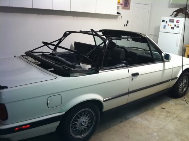

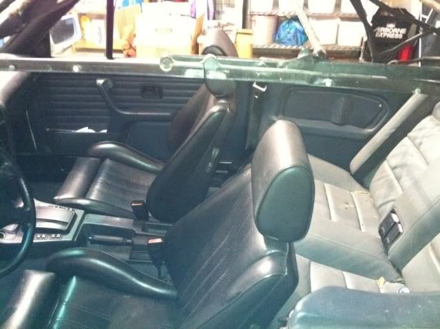

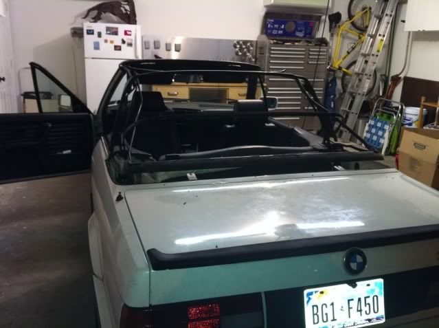

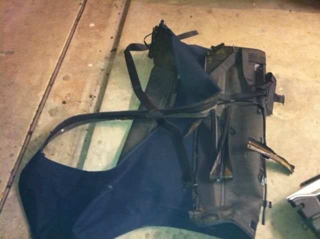

            I said I'd keep up with my e30 convertible top replacement on here - so here's some photos of the top gone:
            Note the tri-color interior:
            Removing the top was a btch. It's been replaced before - and apparently by hacks. There was silicone slathered everywhere and the rivets were occasionally replaced by crappy screws. Having that said, I'm fortunate that all of the gaskets were salvagable. Up tp this point nothing has been particually difficult - just follow the instructions from world uph. Today I'm going to remove all of the adhesive from the frame and hopefully install the top.

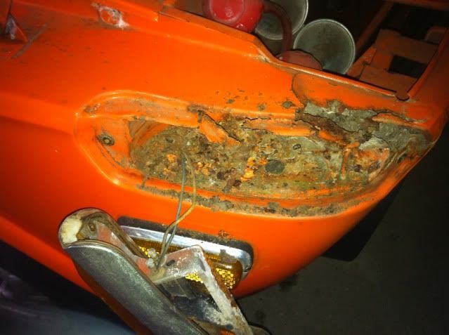

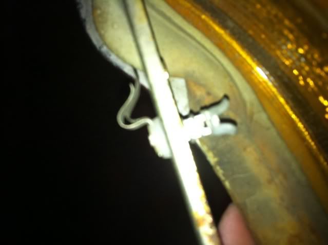

              Originally posted by PSloan
              So, this isn't good. Fortunately I already have another fender.
              Did euro turn signals come equipped for running lights? Because this set has em.

                UPDATE:
                The convertible top is on. I did it by myself and it is not especially difficult.
                Some tips that I have learned in retrospect:
                When the old top and tension straps are off, put the boot cover back on and make your adjustments to the frame. It's much easier than doing it later and extreme adjustments can result in slack in your cloth.
                If you suspect that the top has already been replaced, get your hands on some extra screws/hardware. Specifically the ones that hold the tension straps down. A lot of my hardware was replaced with CRAP.
                Buy lots of various sized rivets.
                Use brush on adhesive. The spray shit is VERY messy.
                When removing the side cables, be VERY careful when separating the bracket. It will snap readily. Perhaps even order 2 new ones - I wish I had!
                DO NOT COVER YOUR WINDOW IN MASKING TAPE like the instructions say. I have a ton of adhesive to remove off of my brand new window as a result.
                Buy two bottles of adhesive remover and 24 cheap towels. I used all of it.
                Last but not least, don't do this all at night like I had to. (I work at night and am therefore awake at night)
