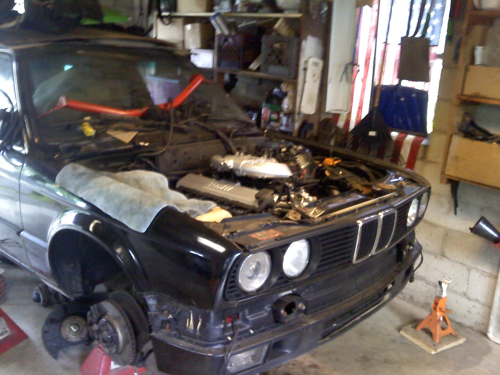

    Well, as i began work the car was ticking, nothing bad. Went to adjust the valves and found a stripped head bolt, so it began.
    Bought a block from a good friend [same guy letting me abuse his car] for $50, 114k on the block. Took the head in for a complete rebuild. Picked up some no name long tube headers fo' free! Freeflow cat, Magnaflow muffler. Stripping the suspension off of my current DD/autocrosser once this car is ready.

    Mocked up the headers while i was driving the exhaust studs. I think they are some IE knock off ebay headers. Look fine, have some rust so i wont be wrapping them, just some high temp paint so they look good for for a couple months.
    Started to weld the down tubes but my crappy harbor freight welder died, for the 8th time in the last year. I bought another one, for what i do it does the trick.
    Started to work on the motor. One of the head bolts wont torque, im a little annoyed by this

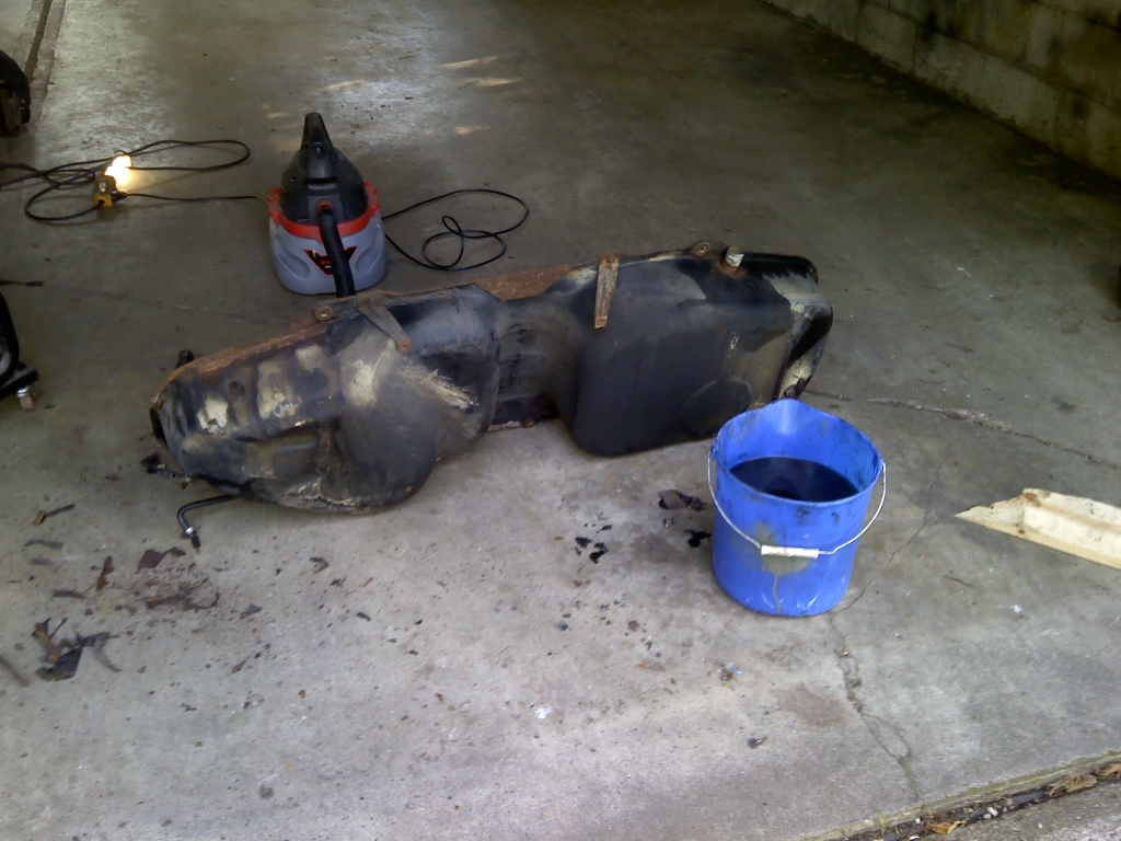

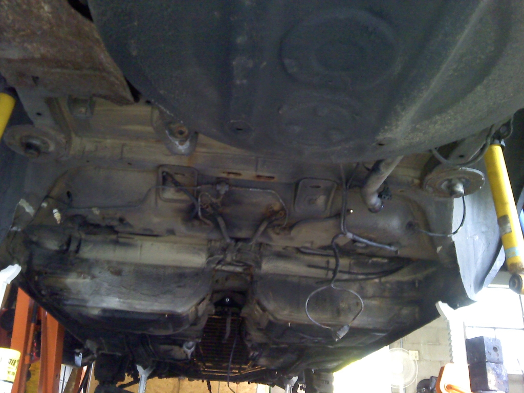

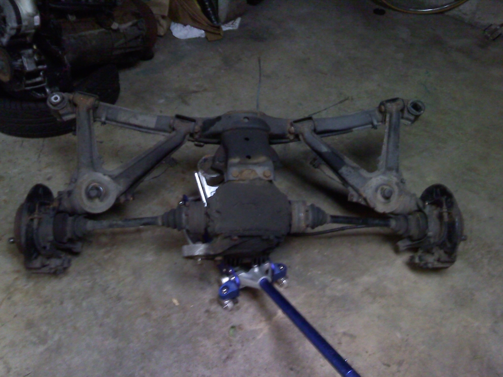

      I knew i had a leak in the gas tank, but i was not sure where. Dropped the subframe to do the diff seals, subframe bushings. Dropped the gas tank to check it out. The typical places are rusted, but its got a bad spot on the seam... Bill H has got a tank for me, thankfully.
      Burning out the old mounts. Suprisingly one was still in good shape, and the subframe has clearly never been out in 280k, and 20 years. BTW this was not done anywhere near the gas tank.
      Reinforce the trailig arm tabs, they love to break off with anything bigger than a 14mm bar. Also made beefy mounts for the chassis bracket.

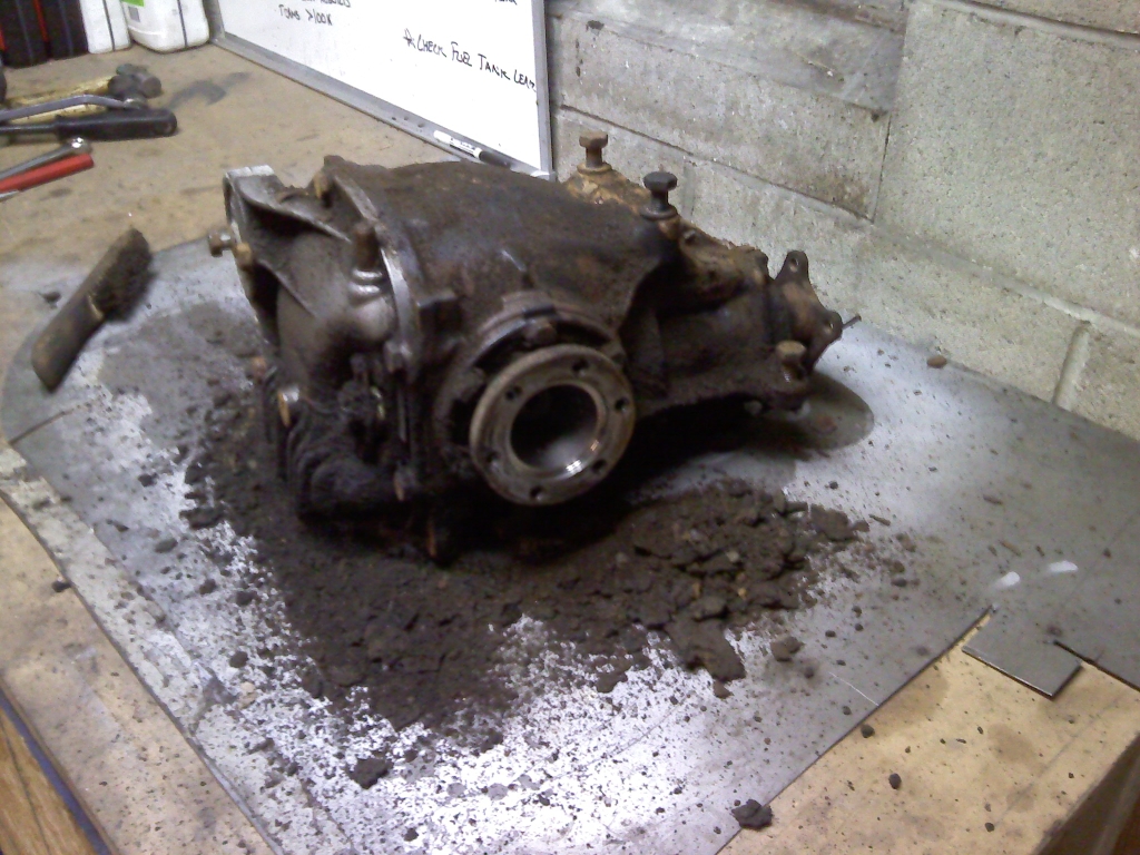

      Cleaned off the diff... i would guess there was at least 5lbs of drt and grime all over it.

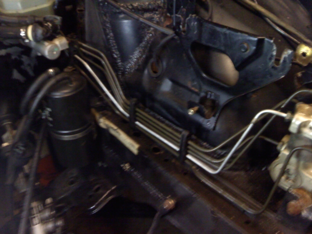

      A friend lent me his badass brake line bending tool and bubble flair tool. The line from the ABS pump to driver front needed replaced, as well as the lines in the back and the brass T for the rear line.... AND... the trailing arm lines.

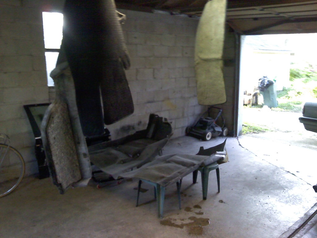

      Garage looked like a smoke house, power washed the carpet and floor mats around the corner. Dried out by the next day in 90+ degree heat, if theres any 'pro' of this kind of weather.

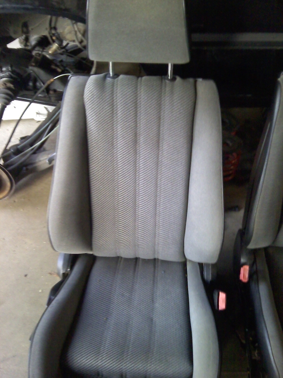

      Heres the new seats, its called Anthracite, not Houndstooth like i wanted/was told. But its different, and thats what im going for.

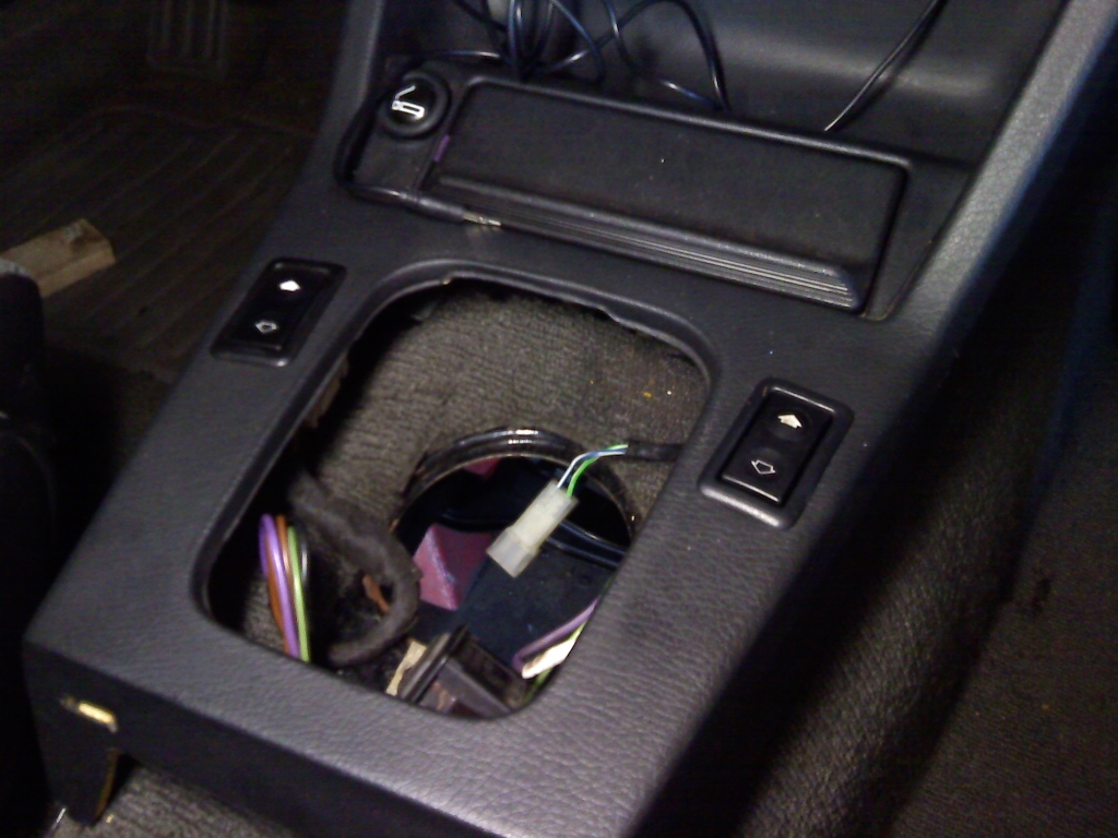

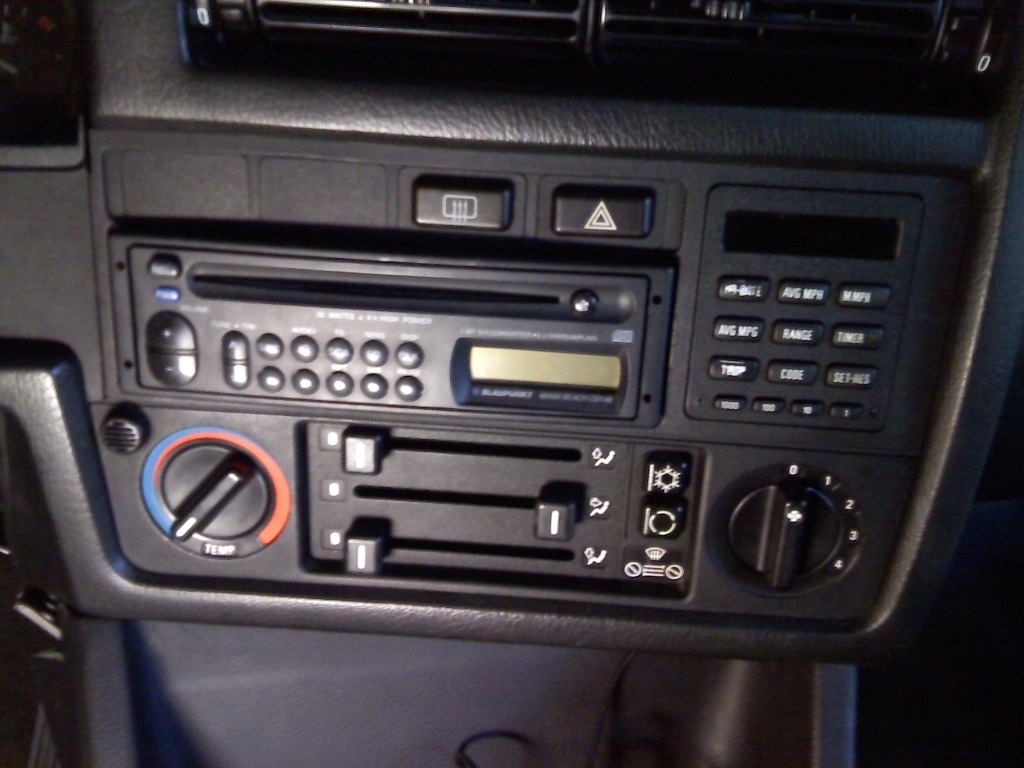

      OLD Blaupunkt head unit, 1992ish... has a friggen Aux-In jack! Sounds great, now i have to rewire the illumination with some LEDs, the OE incandescents all burned out, and are not the right color.

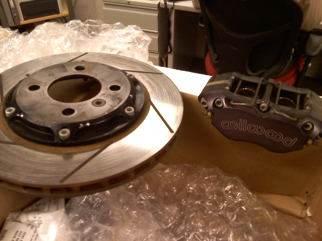

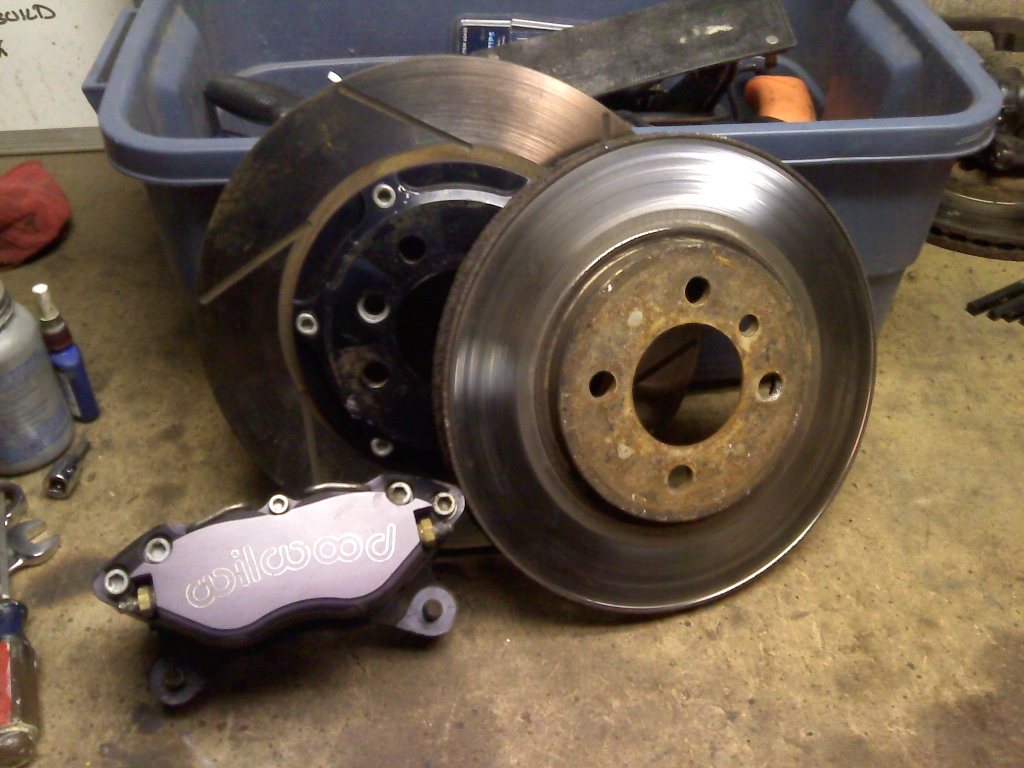

        Put the BBK on last night, so the car is almost done.
