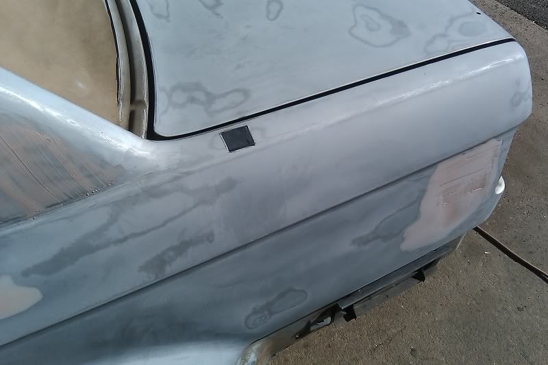

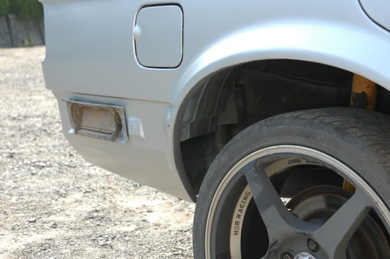

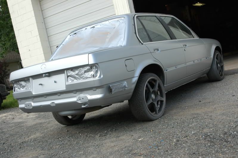

        Been busy working on a couple of e21's, but today I was able to do an antenna delete and we started bodywork and sanding the whole car down

          Lol, electrical tape antenna delete. I rocked that for a few months...
          • metalsoul
            • 871
            No, LOL...that's a patch of steel I welded in!
              Hahaha yeh the cell definitely made it look like electrical tape. Good work!!

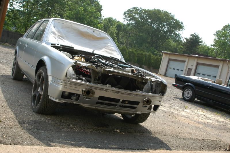

                I haven't updated in a while cause I've been so busy, and I've been working on this project solo since my brother got a new job, while taking more classes, but I finally finished all the rust repair, got the car in primer a couple of days ago, and I laid 3 coats of Polaris Metallic tonight. I hope to have time to lay clear tomorrow and cut and buff this weekend (HOPE to at least :)
                First off I got everything squared away with the motor, new gaskets, seals, belts etc. and I painted the valve cover and intake manifold, and we dropped the motor back in.
                A picture of my brother after we dropped the drivetrain back in...and a couple of friends "supervising"

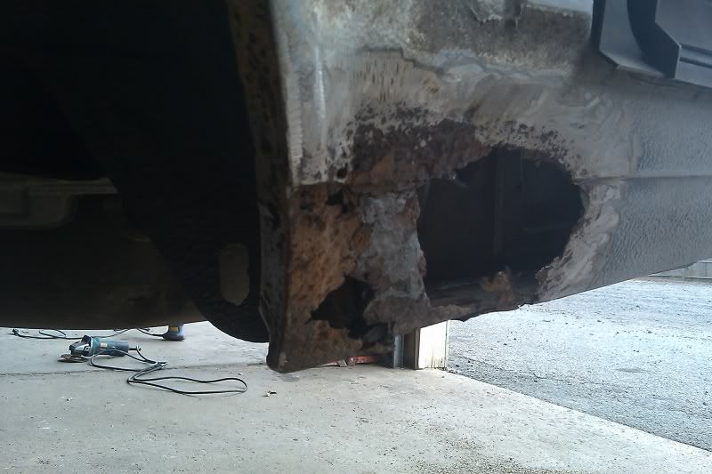

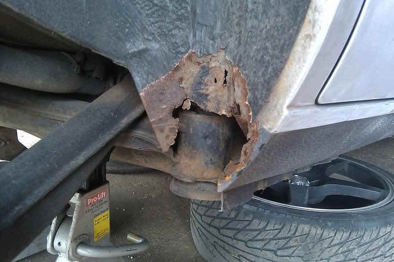

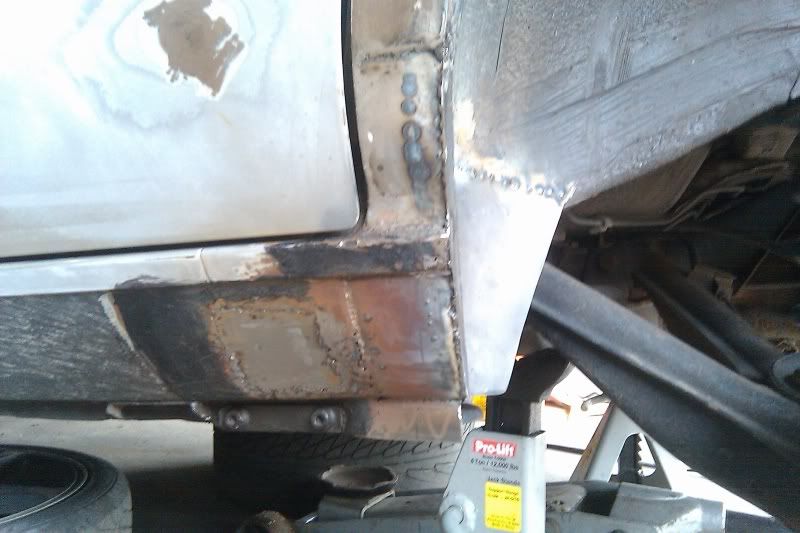

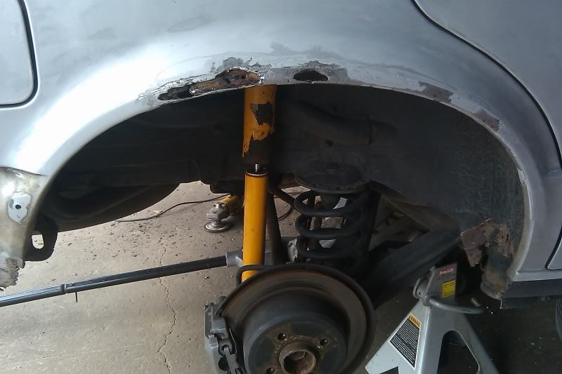

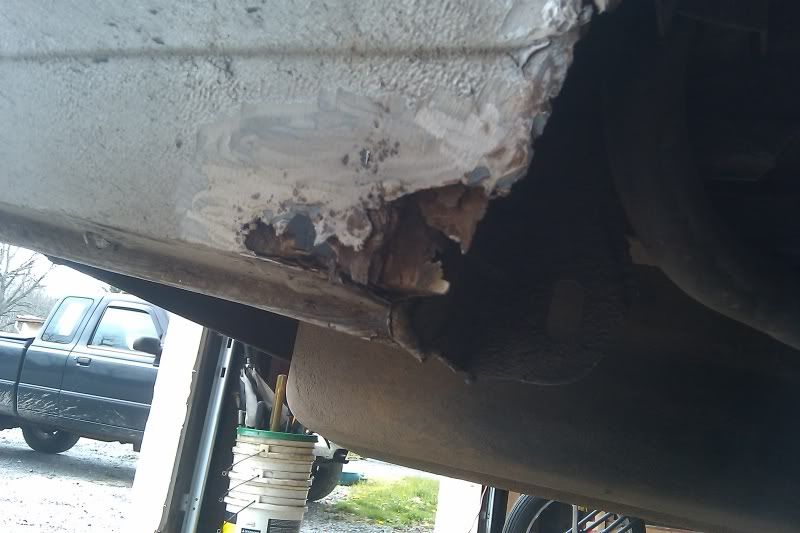

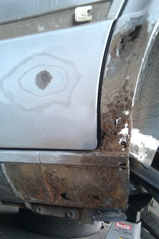

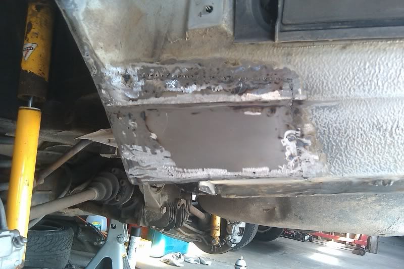

                Next came all that nasty rust and rot removal, I patched in all new sheet metal everywhere I found it...and there was A LOT!
                Before
                After
                Before
                Midway
                And there was a bit more but I'm terrible at taking time out to take pics while working!

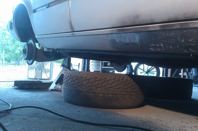

                  Then came smoothening down all the rubber coating around the bottom, I opted to grind then sand it down rather than fill and sand...

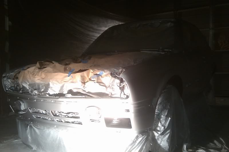

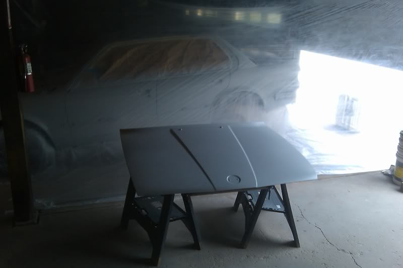

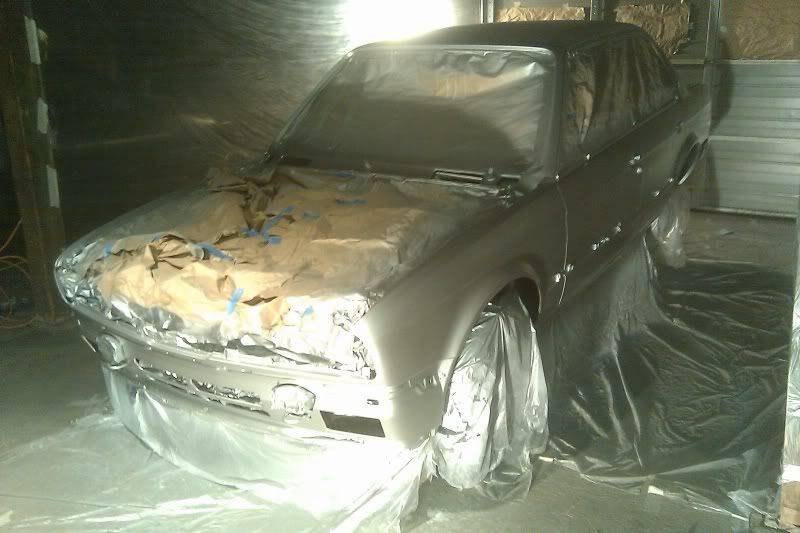

                    After I got everything patched up with new metal, applied a skim coat of filler, I sprayed filler primer, then laid a full coat of gray primer in my make shift paint booth...it's far from ideal but it's all I could get away with...

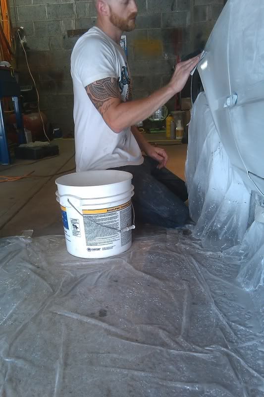

                      Then wet sanding...and more wet sanding...

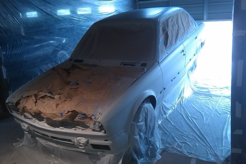

                        Then FINALLY...PAINT...BMW Polaris Metallic...I know the pics suck for now, but my cell phone is all I was going to use in a poorly ventilated room full of overspray!
                        After 1 light coat and 1 medium coat...
                        After a 3rd coat wet...

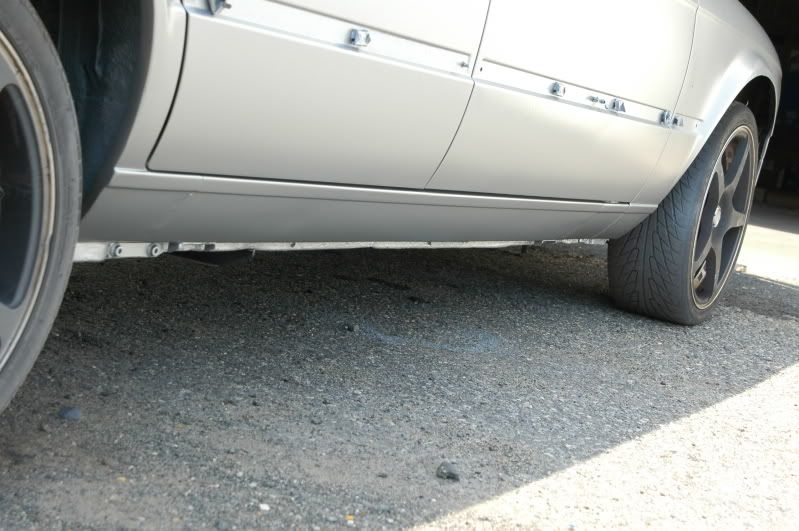

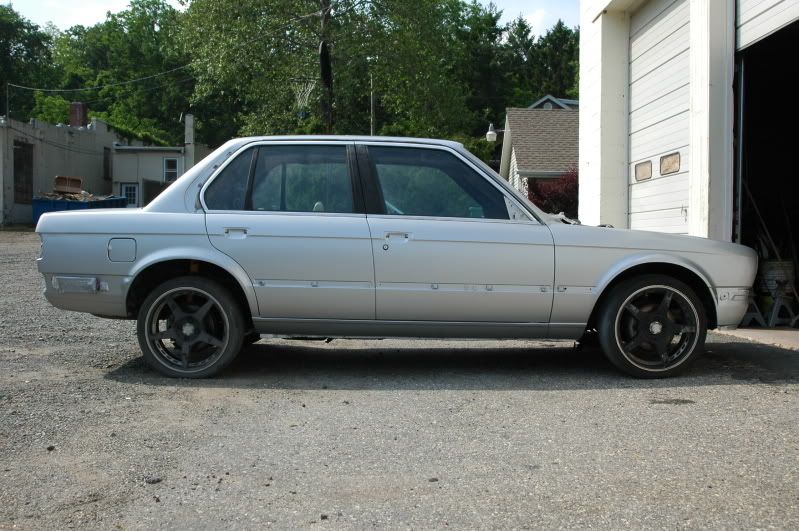

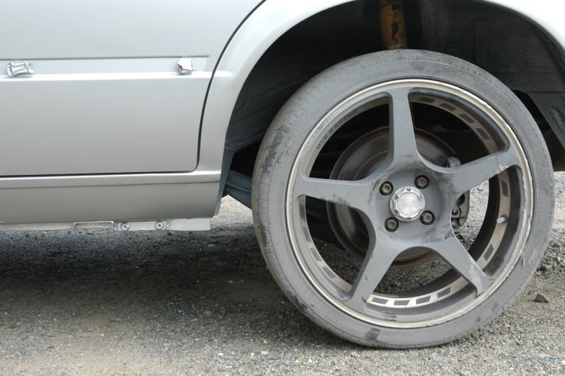

                                I laid the clearcoat yesterday afternoon, and put it out in the sun to bake...
                                Passenger side:
                                Remember what this wheel well arch and corners looked like before:
                                Drivers Side:
                                And the drivers side before:
