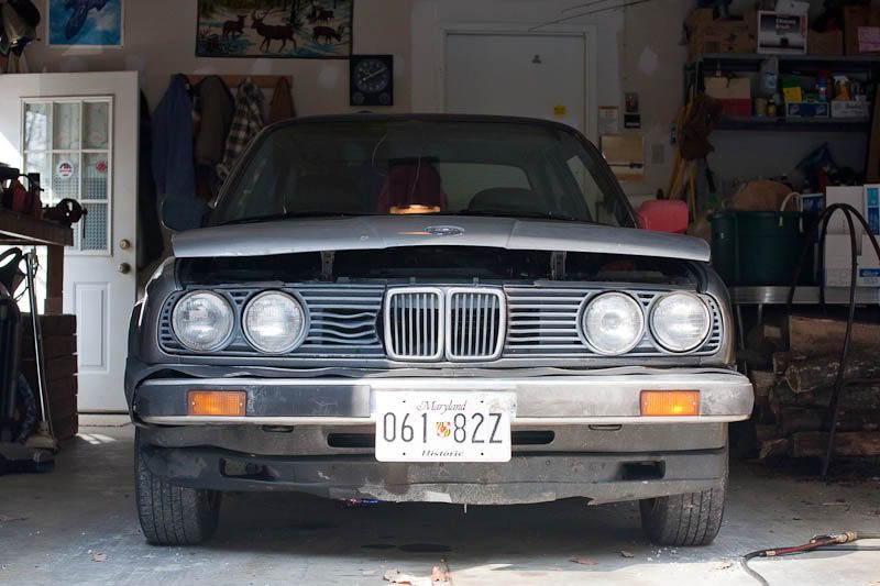

    (Note, there was a slight incident with a tree after I killed the motor which is why the hood is bent :shifty)
    The worst looking, yet running turbo setup you'll ever see
    Obligatory shot

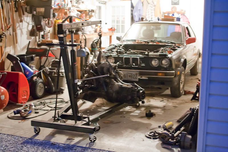

    Awaiting removal

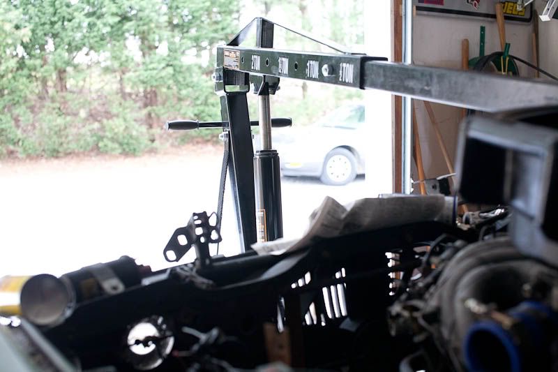

    One day later, we have this. I have friends who volunteered to help, but I ended up doing it all myself. My thought process was that I'd start on it and call them when I needed it help, but that time never came.

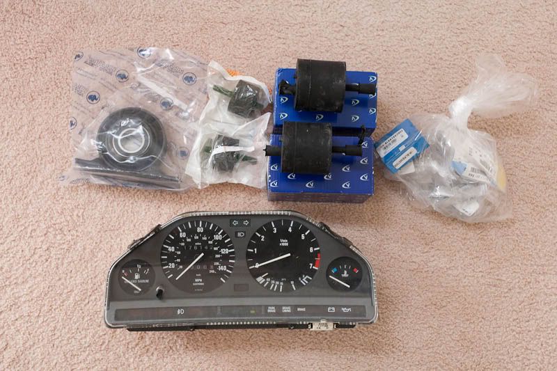

    Also got a delivery. Yay 24v swap parts! That includes the CSB, e28 m5 motor mounts, e21 trans mounts, 7k rpm cluster, and everything I need to rebuild the shift linkage and convert from the early e30 sheet metal shift console to the aluminum style linkage.

          LOL, yeah... the car came like that. Apparently it had a slight engine fire in the past. All the fuel lines are dated 2003 and the fire extinguisher is partly used. And yes, I'm planning on boosting the m50 but it won't be until summer. My wallet needs some recovery time plus I need to sort out the rest of the car. It was $400 and needs some cosmetic help (obviously).

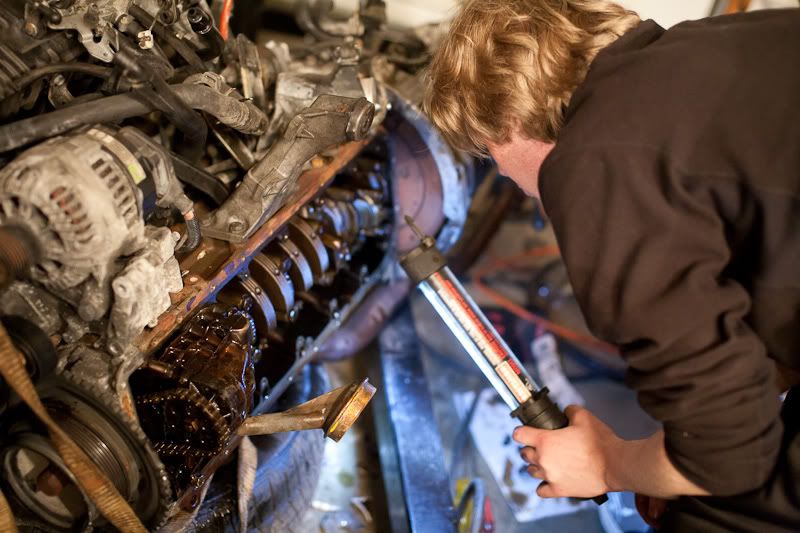

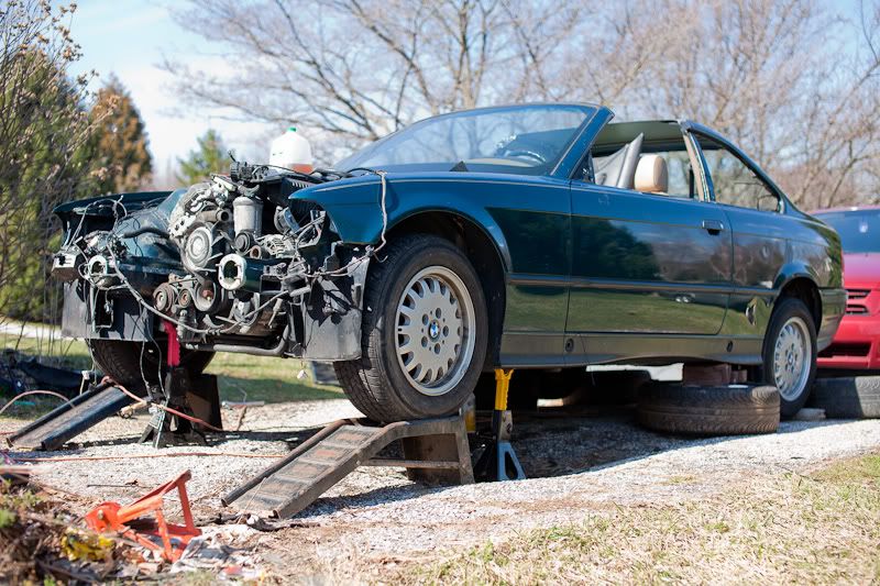

            As of my last post, the m50 was still in the donor car. It rained for a couple days and the weather dropped from 70* to just above freezing. I guess I was so busy with pulling the motor I never even noticed how cold it was outside because I was comfortable. Anyway, the e36 proved to be much harder to work on than the e30, mostly due to logistics. My friend's driveway is on a slope as is his entire block. Just trying to get the car jacked up was a problem and our first attempt actually ended up with the car falling off of six jack stands, rolling back, and one of them went through the floor. Yay. Note this was at the top of his driveway which is the flattest portion. After that incident, we abandoned using jack stands and instead went for rims, junk yard style. Of course, to even attempt getting the car back in the air meant we needed to get the car back up to the top of his driveway. The e36 was no longer running so it was a pretty serious issue. My friend decided to use his e34 535i/5 as a push vehicle and it worked quite well with no damage done to either vehicle. We were then left with this:

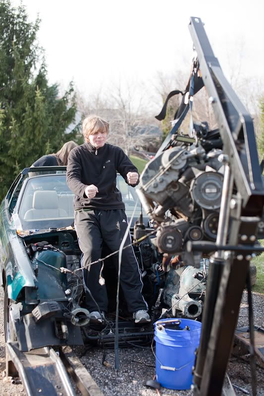

            Now that it was finally somewhat safely lifted in the air, we began the process of actually removing the engine and trans. Again, this actually proved harder than the e30. His e36 was never touched so all the bolts were solid. We hit the bolts/nuts with liquid wrench, ATF, and acetone which allowed us to remove the engine mounts, trans mounts, and drive shaft bolts. However, the exhaust just wasn't cooperating, so we "sawzolved" it. As the day wore on, it wasn't the only thing we sawzolved :D We were pretty much ready to start pulling the motor so we took my 540 out to lunch, then went to my house to pick up the engine hoist, trailer, and tow vehicle.
            After some sawzolving, the engine slowly came out
            And some fun was had
            Baller status (yay coilovers! that was a hot e36 before it was rear ended :()

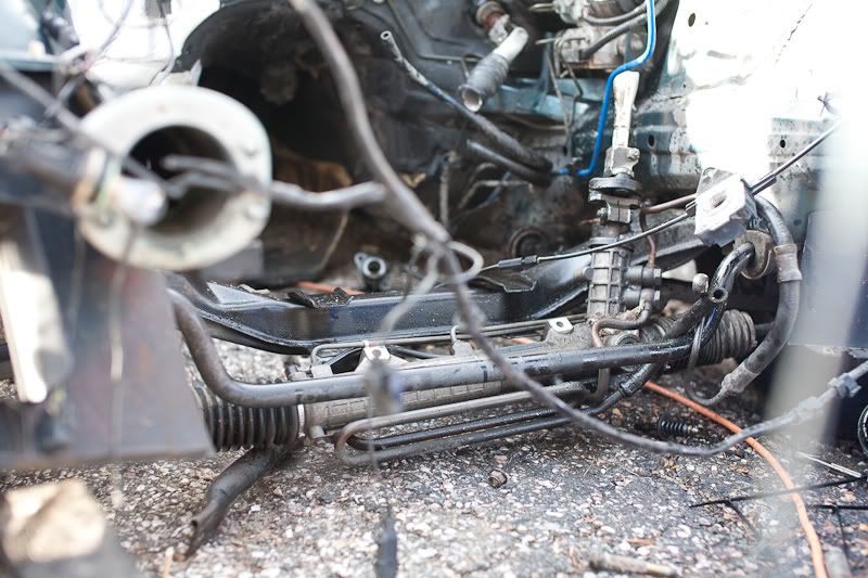

            We also had to get the car out of the driveway, but if you'll take note, we sawzalled the steering linkage... oops. Solution? Steer the wheels by hand! It worked and we backed the car into his yard for now.

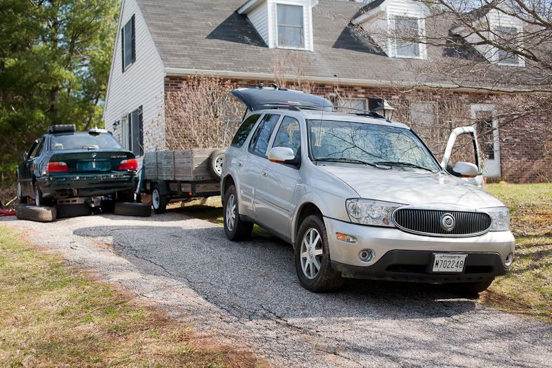

            Finally we got the engine into the trailer and brought it to my house where the e30 was waiting with an open engine bay. Of course, as this motor was from an e36, we first had to swap the e34 oil pan on. I also deleted the p/s and a/c.
