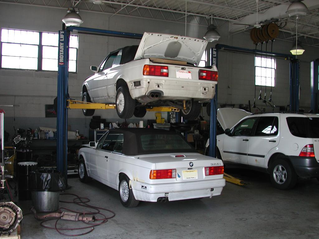

    Here's an in progress pic with the 92 in the air and the 89 on the ground with panels being test fit on the 89 before going to paint.

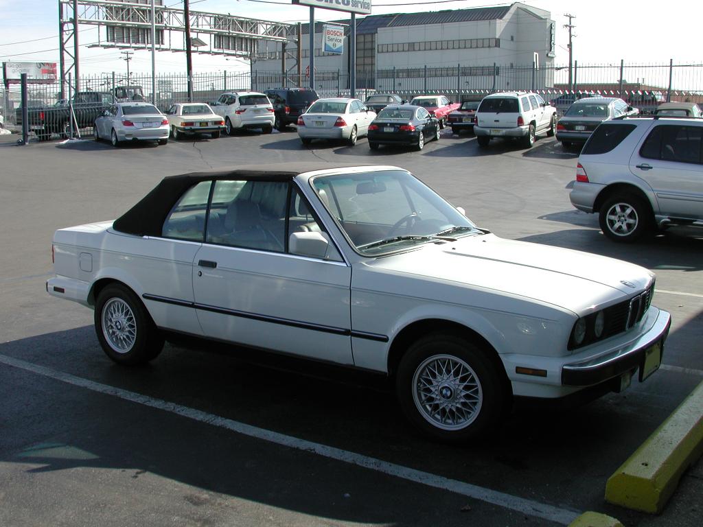

    Here is the 89 before the Frankenstein maneuvers began

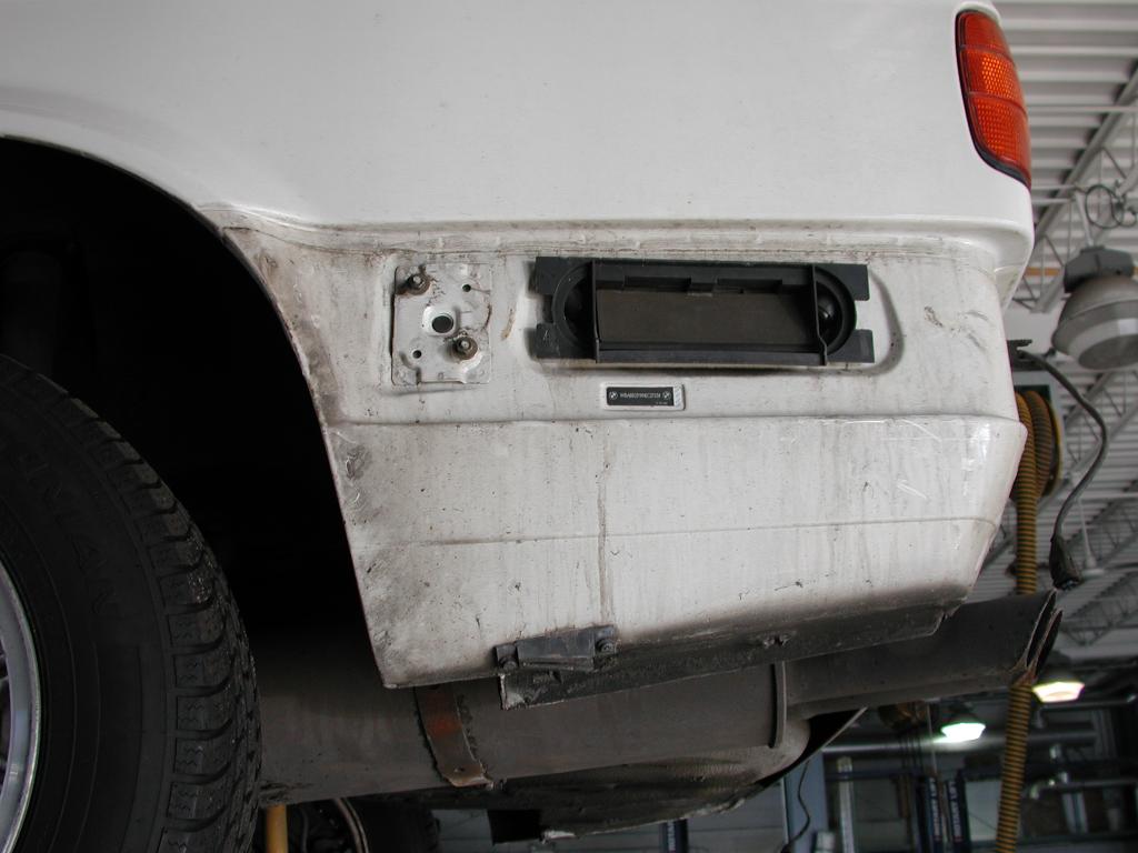

    Here is a shot of the rear fender recess on the 92 which extends all the way to the wheel opening.
