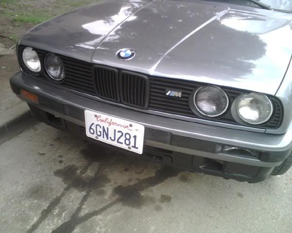

                  heres some inspiration
                  after paint

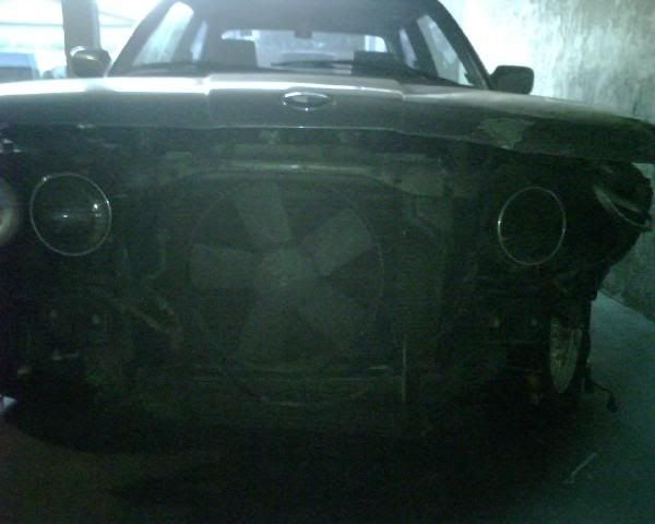

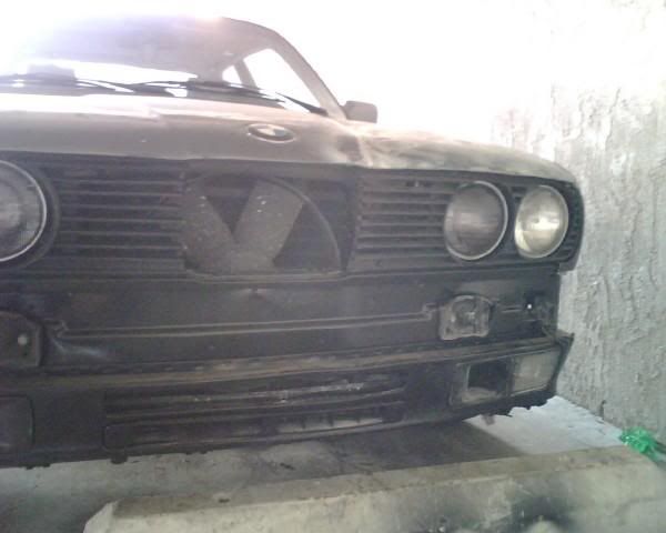

                    What it started out like:

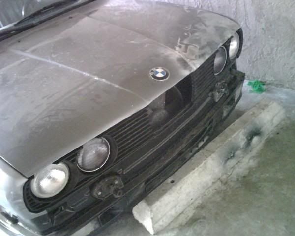

                    After first coat, still needs a lot more:

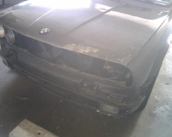

                          12 rust stopts sanded to the metal and filled, and half the hood sanded down to the metal, pulled and filled in buckled sections of hood, and sprayed with primer and paint.

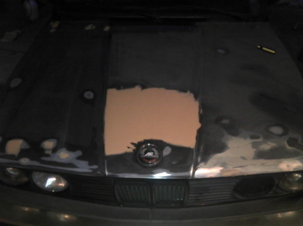

                            Starting in on the hood:
                            There's a replacement fender I finished up as well. I've got some door dings and misc. "waves" to smooth out but all in all each area of bondo has less than 1/3'rd of a 1/16".
