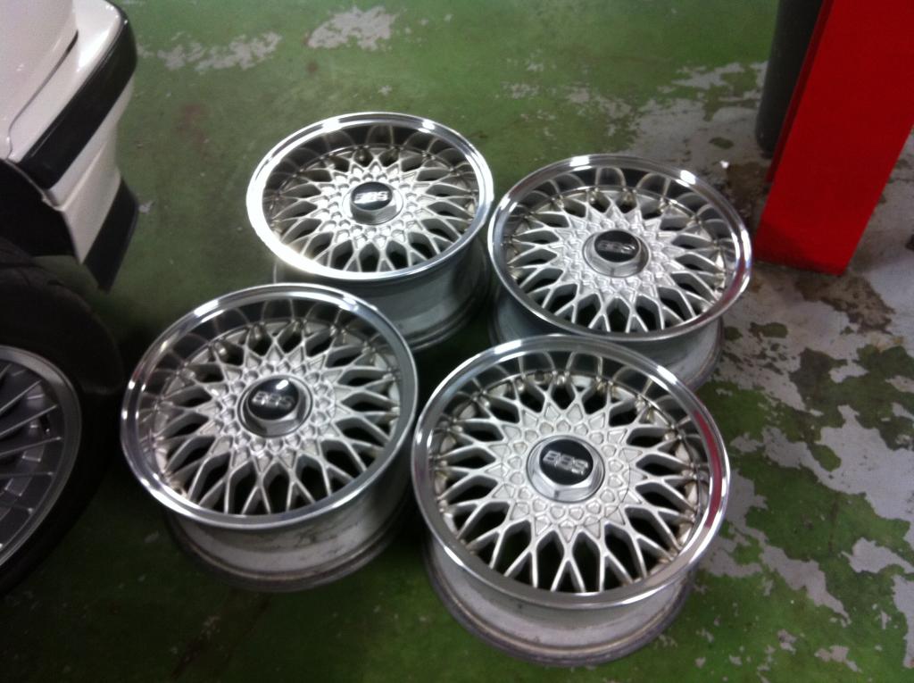

                here is a minor update...:D
