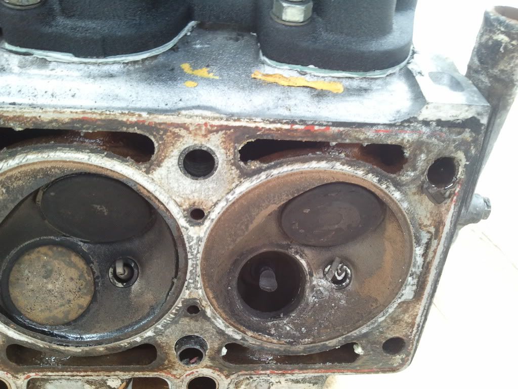

    Hey guys/girls I have decided to build a strocker for my vert 1988 325i. Here is a picture:
    The reason for build is I screw up the engine broke a valve.
    F
    In addition while doing some parts swaps, I discovered the previous owner intalled a 2.7 eta wtf! down grade. One of the reason why I am doing a 2.7 strocker. I already have block and an I head 885 casting. I will keep you all posted. Furthermore, I was thinking on doing a good write up on this build to make as a stiky if not already done.
    I will be doing eta block, I head, larger ss valves, low compressio pistons Ross, h beam 135mm IE rods, 19lb injectors, miller maf sensor,war chip, cold air intake, adjustable fuel pressure regulator, and a surprise. :D
