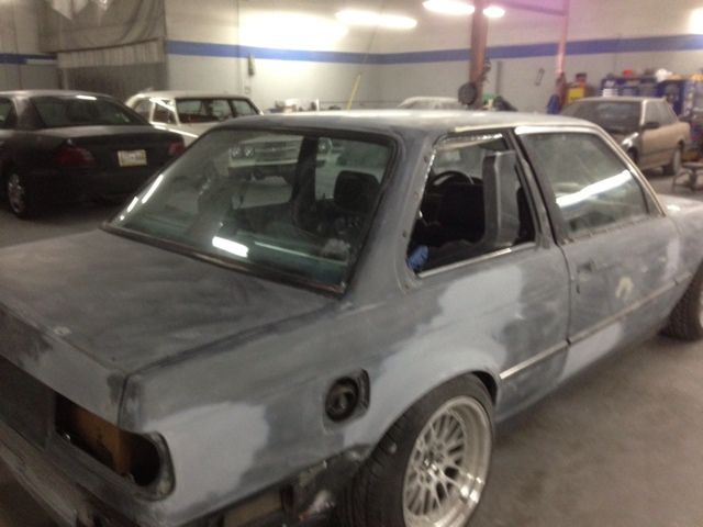

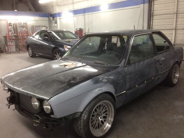

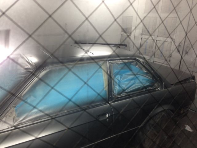

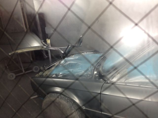

                              Well I drove it to paint week and a half ago, should be getting it back soon then ill take more vids!
