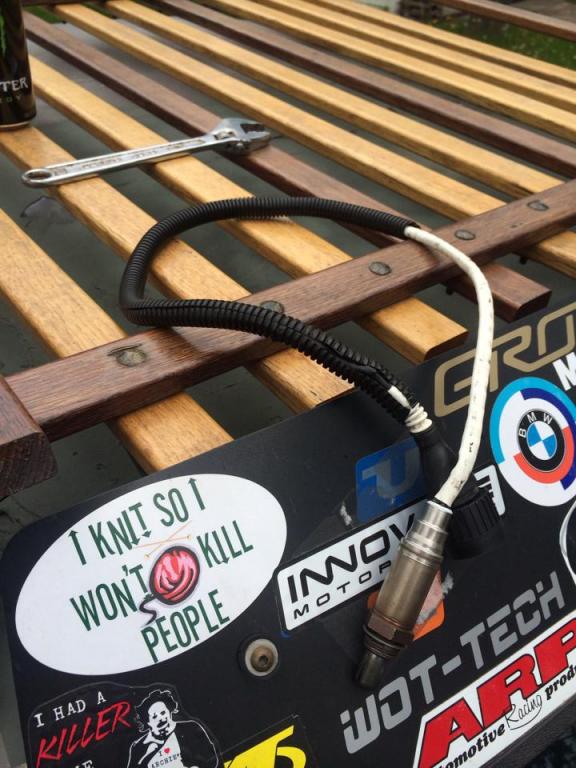

    After rushing to refresh the M30 for Gfest '13 I neglected things to just get to the event, this year has just been going over everything and redoing last minute rushed work. Bought a rebuilt Bosch 140amp alternator and got a new Bosch 02 sensor to resolve the rich running issue. Had to add about 10" to make it from the header bung to the drivers side harness plug. Soldered the splices and heat shrinked the connections, then added a ribbed plastic tubing to keep the bare wires safe from vibrations.
    Cured the rich burn ratio from the lack of an O2 and got to route a bunch of wiring from the last minute install of my M30 for last year, long term I want to pull the M30 out and install a b25 harness I have laying around.
