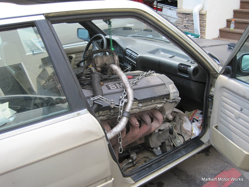

    So it was time for the M20 to go. I decided to completely budget build a 24v swap. I do it right for all my customers but wanted to see if i could do it wrong/cheap for mine:
    M20 Out with carnage. Clutch was brand new ~1 year ago.
    So because i had one laying around i chose an M52. I fixed up a chopped to shit parts OBD2 harness and grabbed a random S52 ECU. I kept the 260. Moved the stock booster wayyyyy over, M20 throttle cable, radiator, etc. Repinned the harness like i do for my customer cars tho ;)
    And the result!:
    And the first start/run vid:
