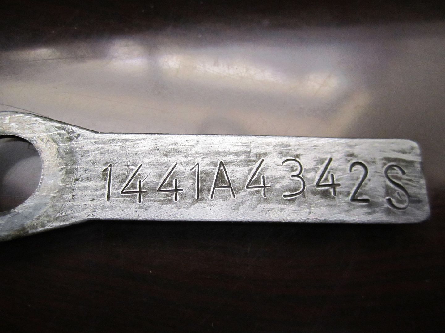

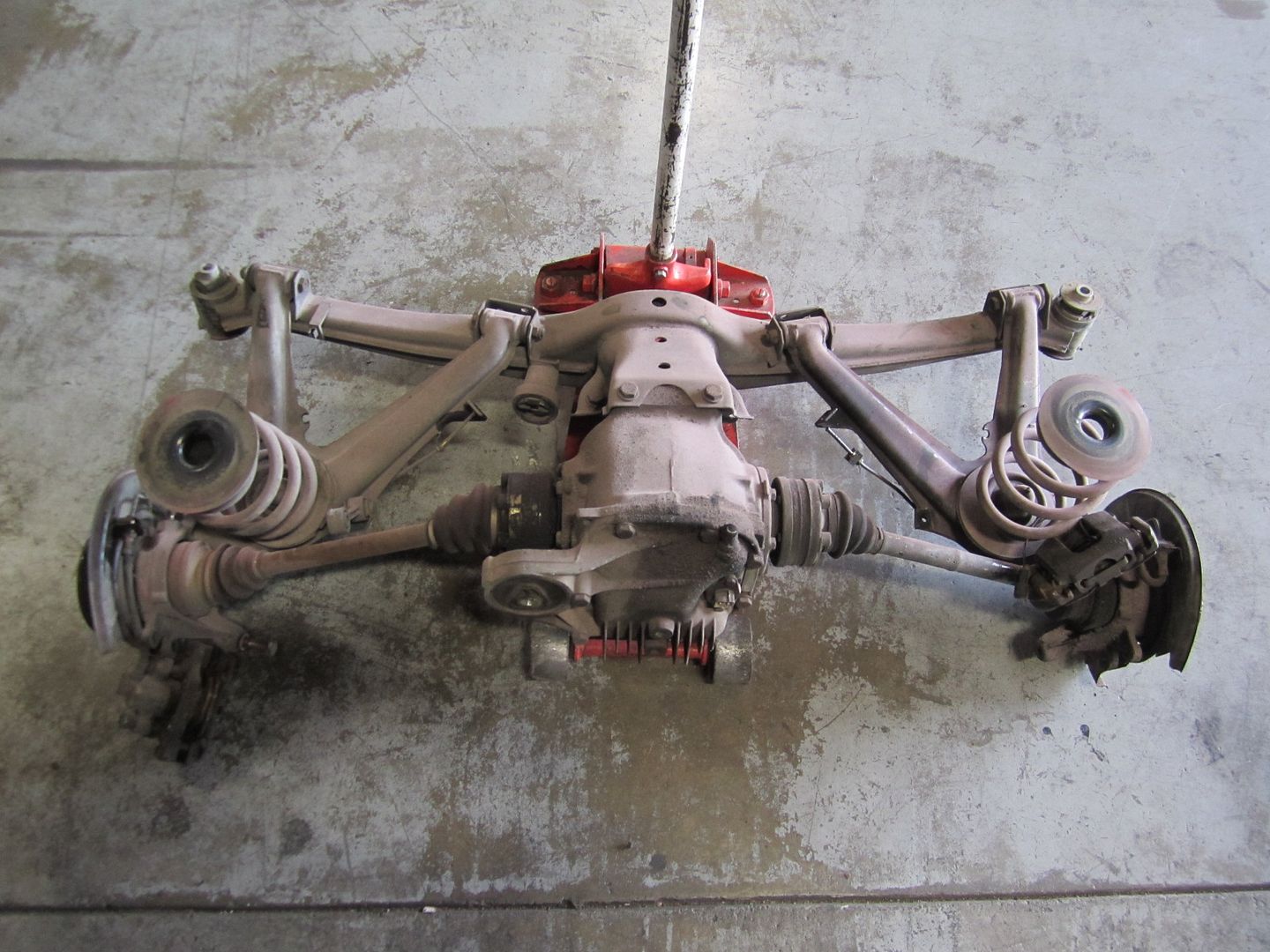

Originally posted by catuned View PostAny one know what this E30 Diff is?
1441a4342s
It's a 4 something posi/LSD but not sure. It's off of a 88 i car.

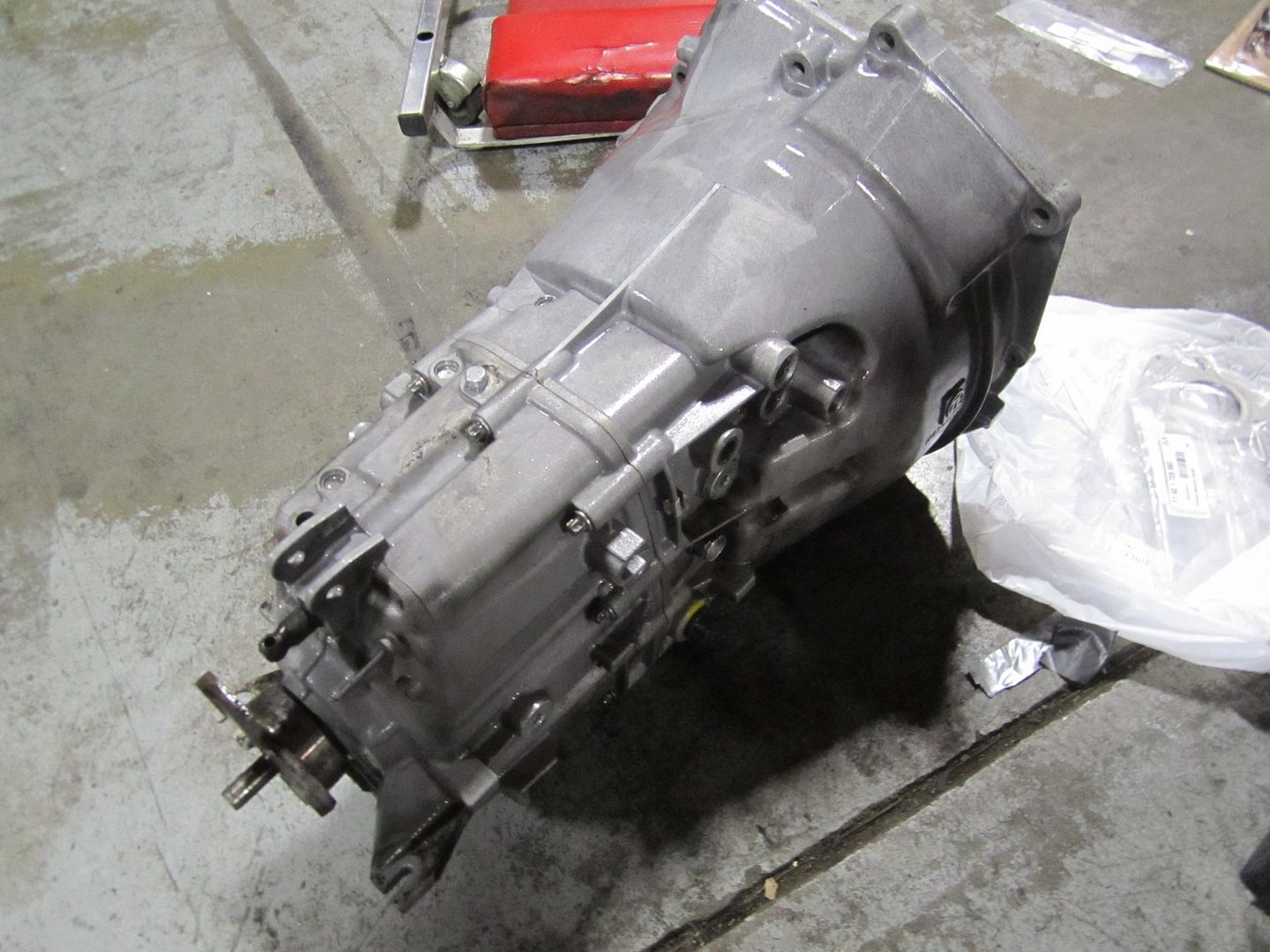

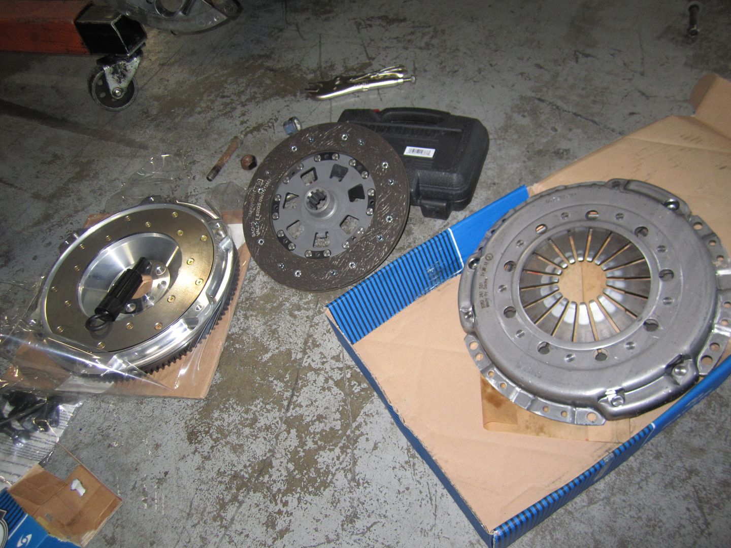

while its apart have your trans guy fit fresh discs and add a dog/disc. much more fun :)OBD1 M54/M52TU swap as a M50b25
Z4 non powered steering rack fits e30
Euro e46 2005/6 320d 6mt gearbox into E30 with M20 hardy and beck 1985 327s engine

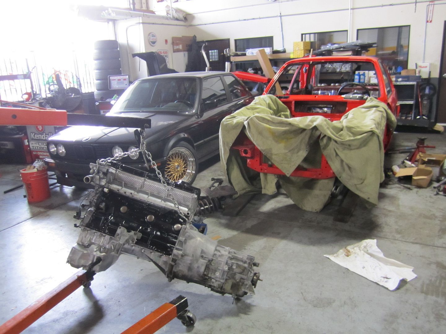

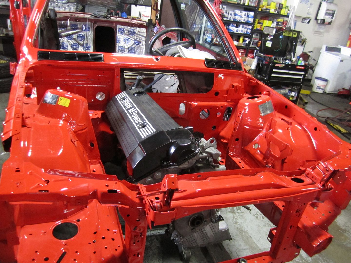

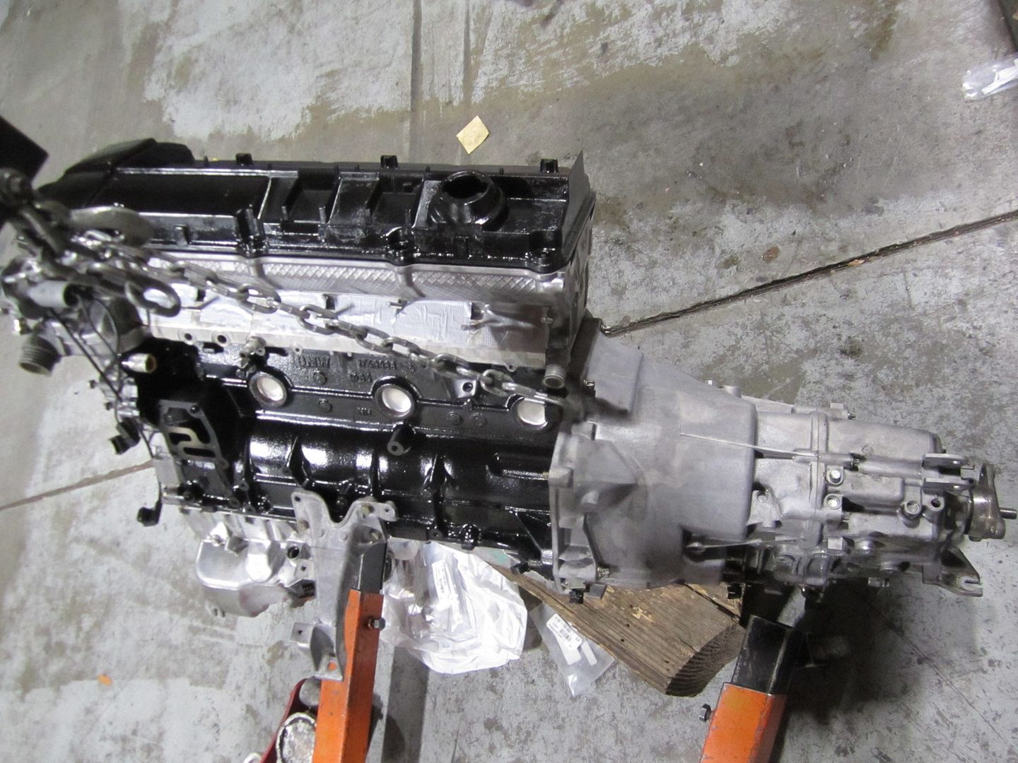

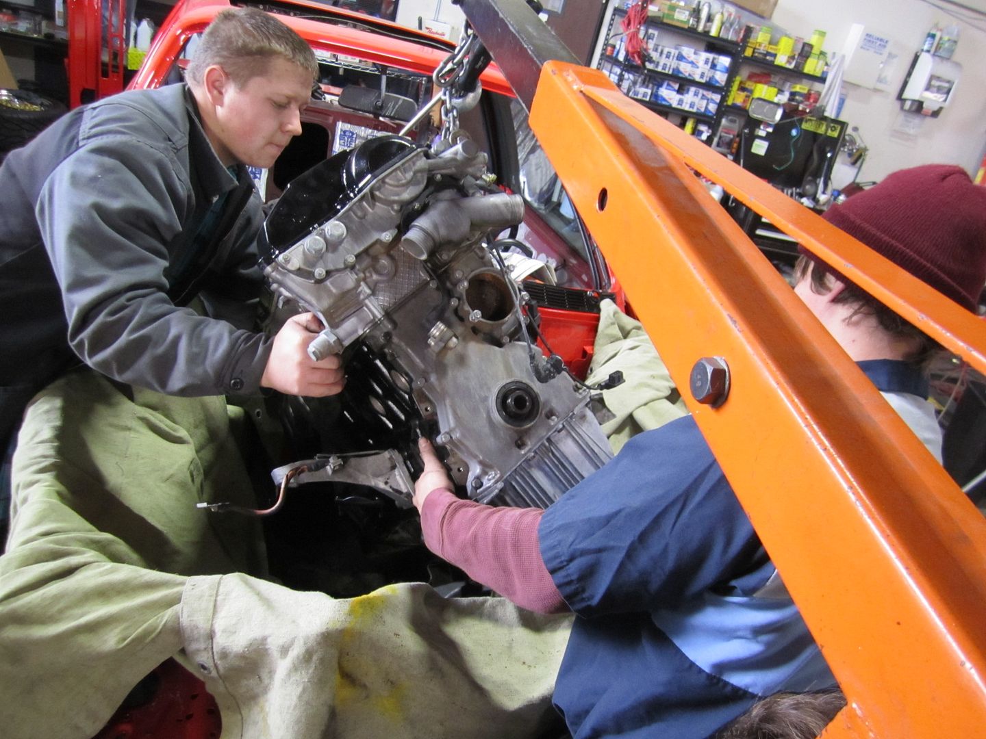

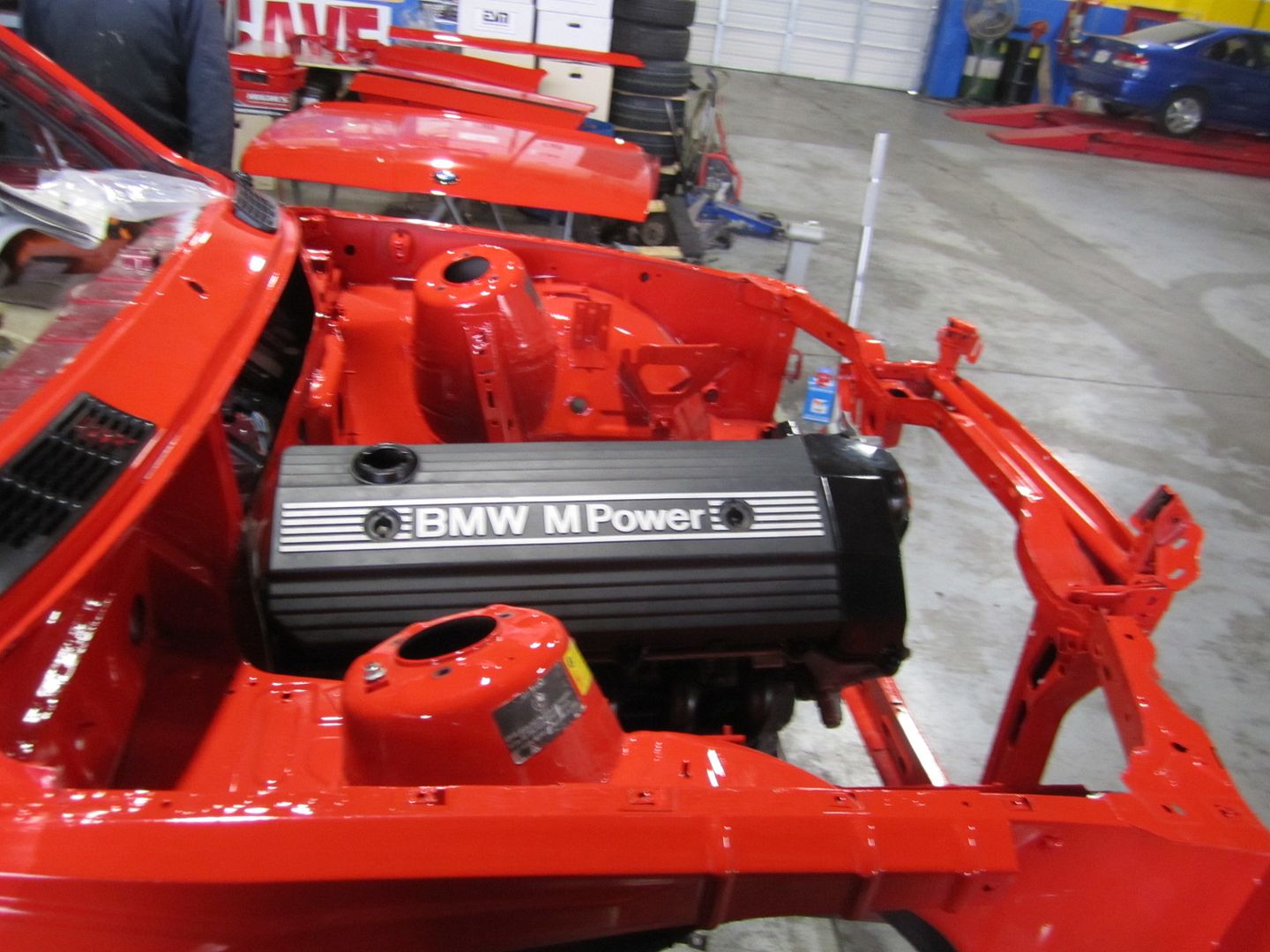

Not much of an update today. Been working on the S50.
Inspected Rod and Main Bearing- Like new! :)
Changing out oil pan gasket
Stripped the old paint off the valve cover gasket (on a OBD1 metal cover it is a Pain in the ass to do) and repainted.
Installed new Knock sensors.
Looking forward to getting the engine all complete to install in to the car next week.
Diff is a 3.42 LSD.SEE THE MOST BORING M50NV BUILD THREAD HERE: http://www.r3vlimited.com/board/showthread.php?t=288275

I thought the last 3 digits and an "s" meant the ratio and LSD. Im a noob.SEE THE MOST BORING M50NV BUILD THREAD HERE: http://www.r3vlimited.com/board/showthread.php?t=288275
