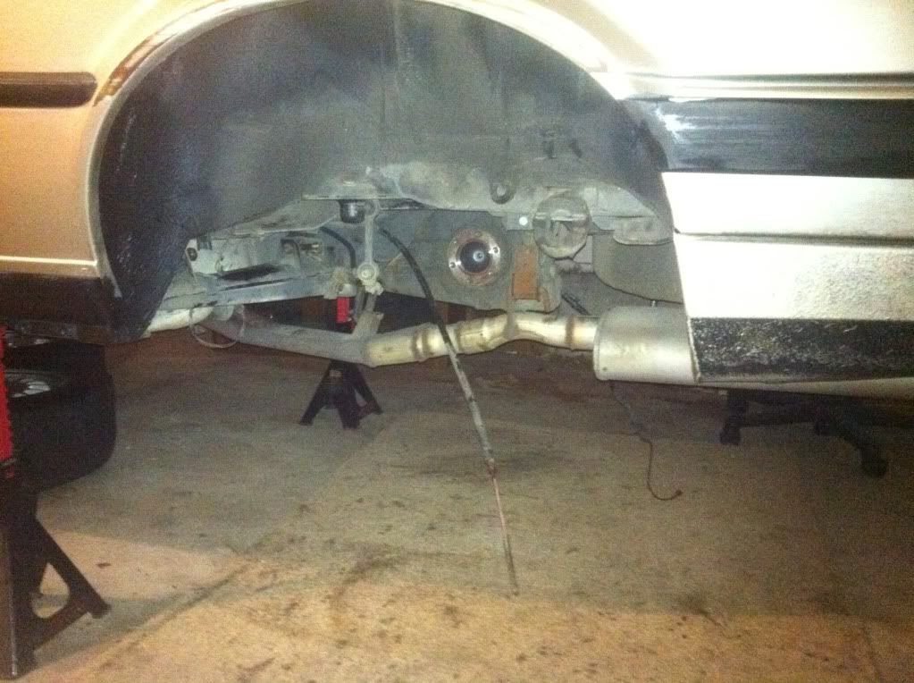

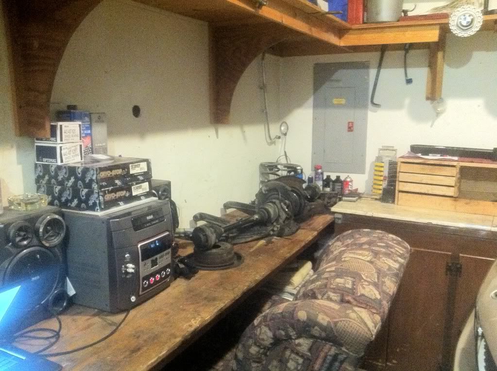

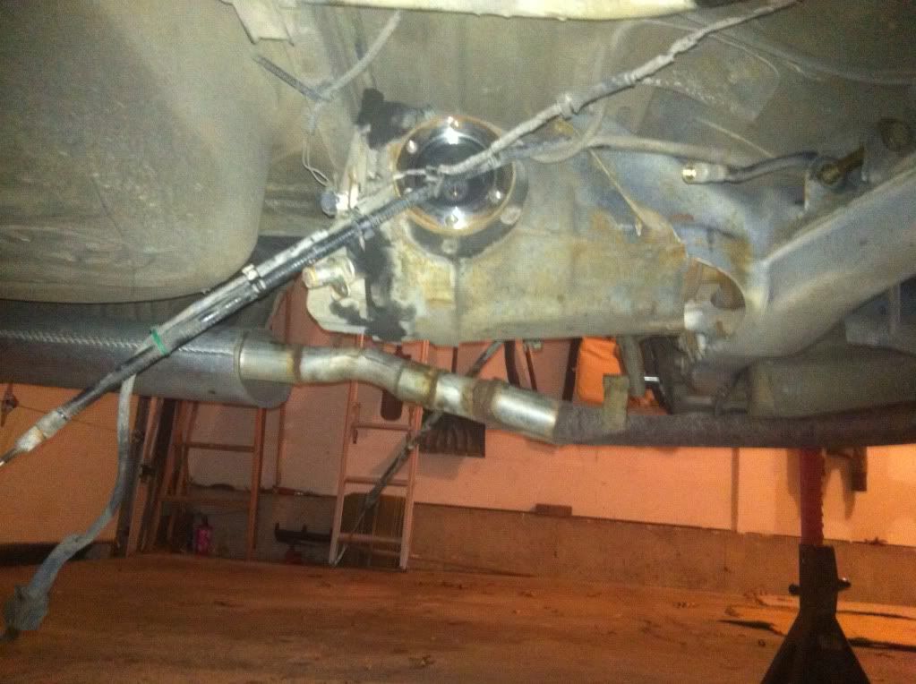

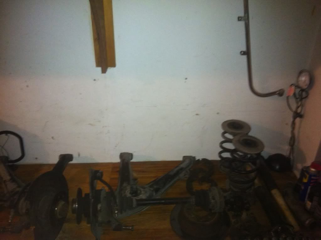

I then started on the rear end, originally i was going to drop the sub frame, but didn't want to remove the exhaust as i have no means of drilling out the old studs and putting new ones in. So i bypassed that and just pulled the trailing arms. this is where i first discovered that my e-brake shoes were 22 years old missing half of the pad and had cracks all over them, and that my shocks are blown ( I can compress them by hand with EASE). i got both of them out in like 3 hours but didn't take any pics as i was working, and didn't want to stop. I did take pics of the after math though.
And the other side
After cleaning the garage and putting everything on the shelf i have, and organized. I couldn't get the 30mm nut off so I'm doing that tomorrow at a buddies house, and then the rear end should go together.

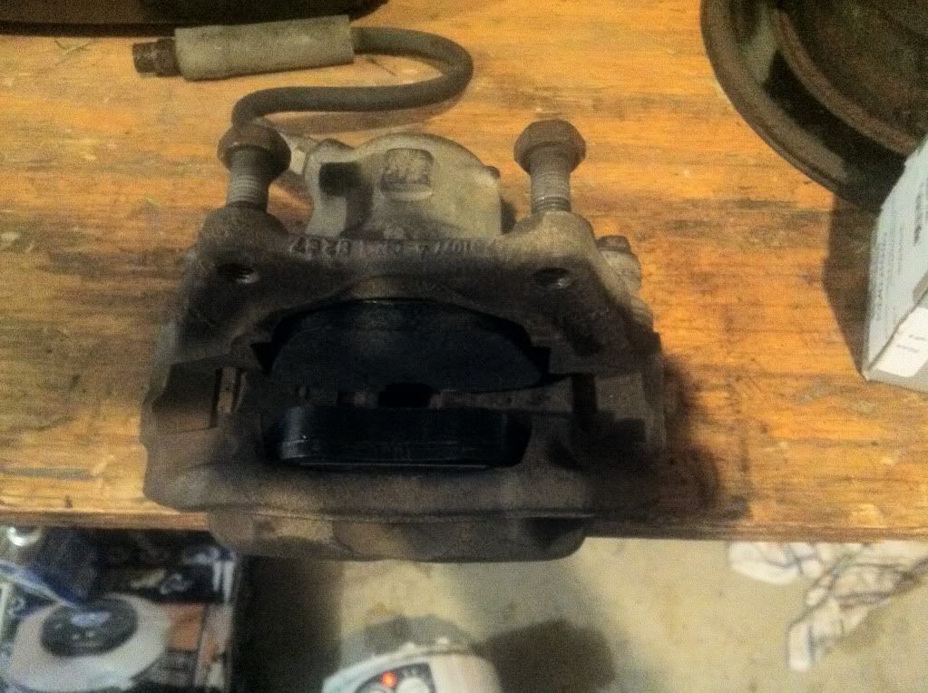

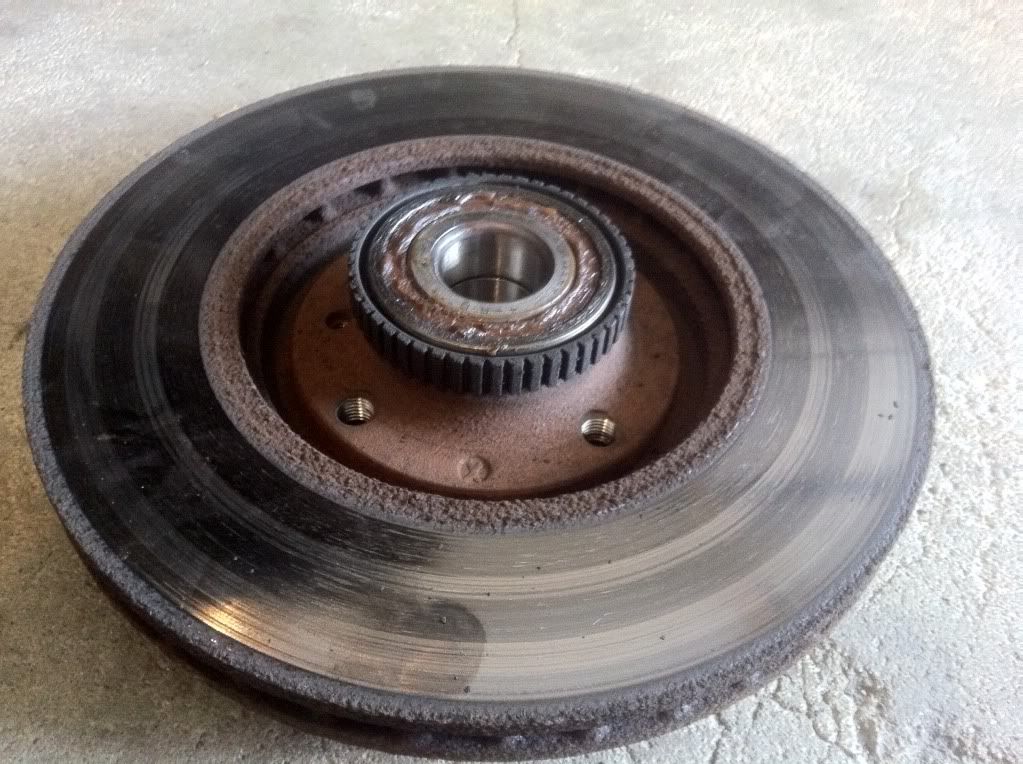

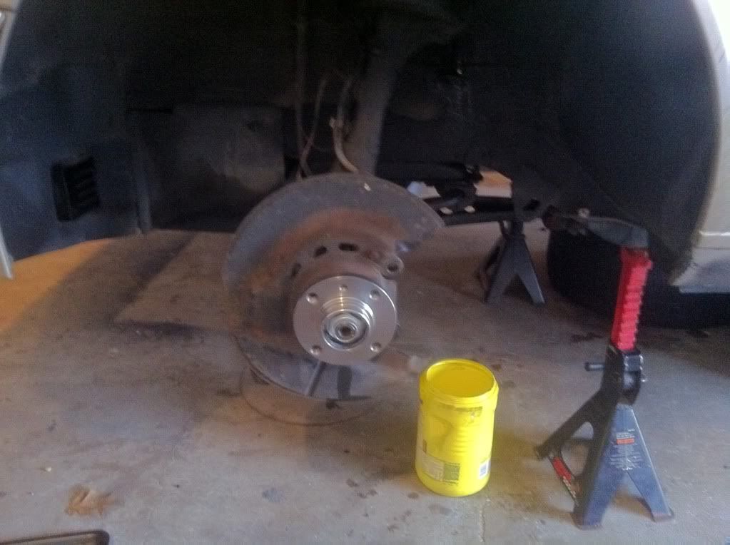

That concluded friday night, then i started on the front, my goal was to replace everything up there today and I did it. First thing i did was remove the caliper with the brake like attached as i am going to bleed the system. I then went to remove the rotor to get the my hub/bearing gave the rotor a good tug and got this.
easy enough, don't need to pull it off with a 3 jaw gear puller like i thought i would. the other side was the same way, extremely easy. i then decided to cook lunch, and was hungry for bearings. i tried to heat them up as i read on here it lets them slide right on, but it didn't work.
once that was done, i put both of them on and then the rotors.

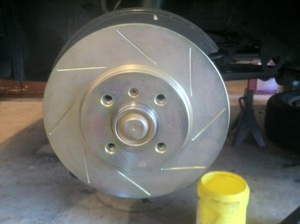

I went with slotted brembos, they were on sale and i have been meaning to upgrade my brakes as well.

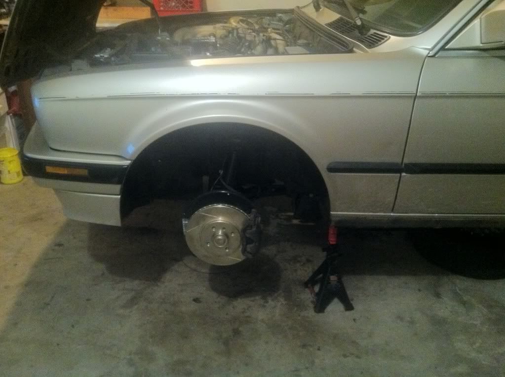

once that was done i did both of my tie rods, I unfortunately didn't take any pictures of this. but oh well, new tie rods and boots. i then put my pads into the calipers and put them back on the car. and then i was done.

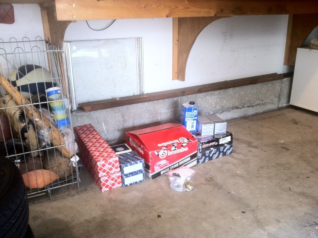

Here is everything that I will hopefully get done tomorrow, the rest of my parts and rear end components.
