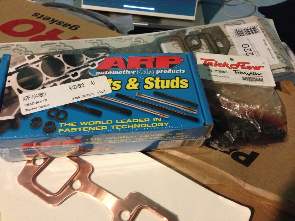

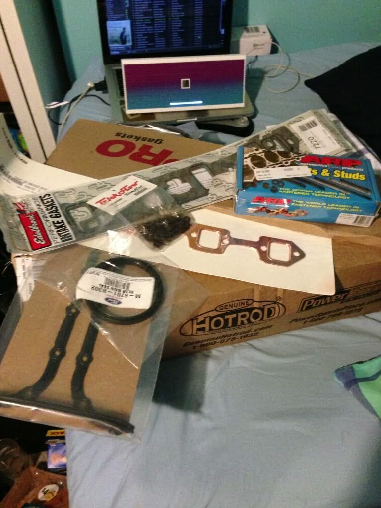

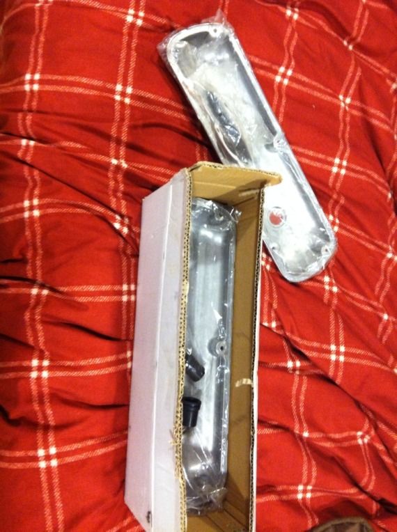

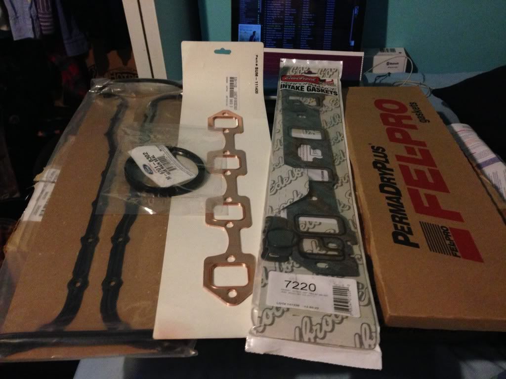

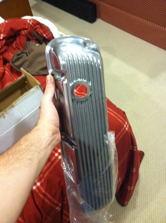

            Some parts came a few days ago.
            ARP Head Studs
            Trick Flow Valve Cover stud conversion
            Ford Racing rms
            Ford Racing oil pan gasket

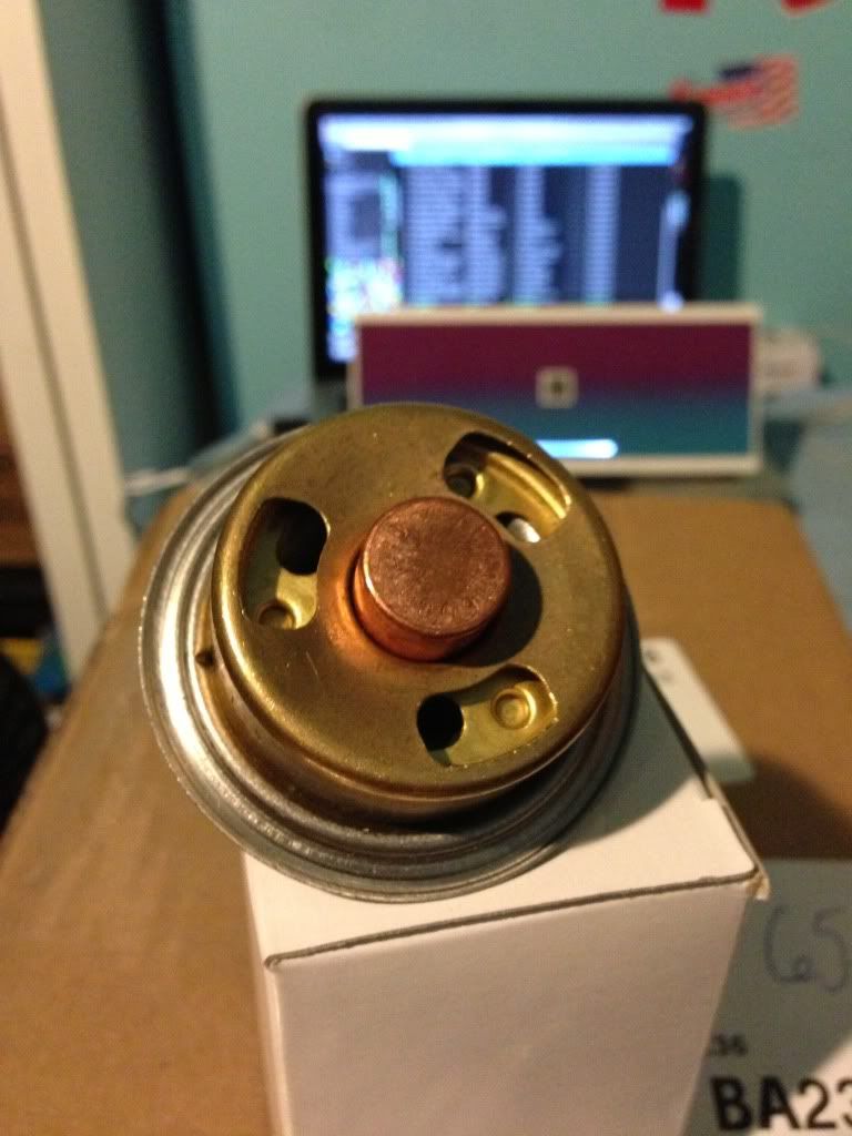

            High-end racing thermostat
            Copper exhaust gaskets
            A few other gaskets and stuff I can't be bother to look for in the box 3 feet away. I'm tired, deal with it.

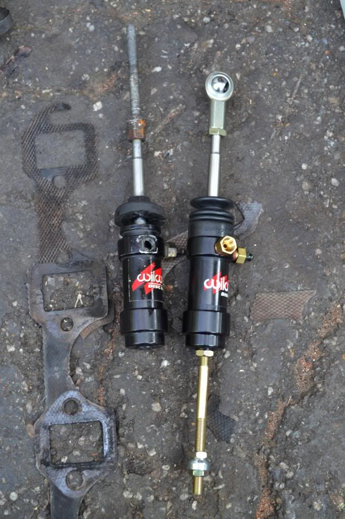

                        Had to order a new $70 slave cylinder because they don't sell the rod individually

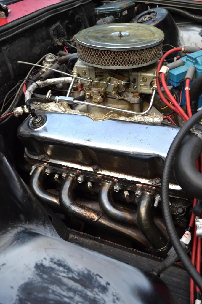

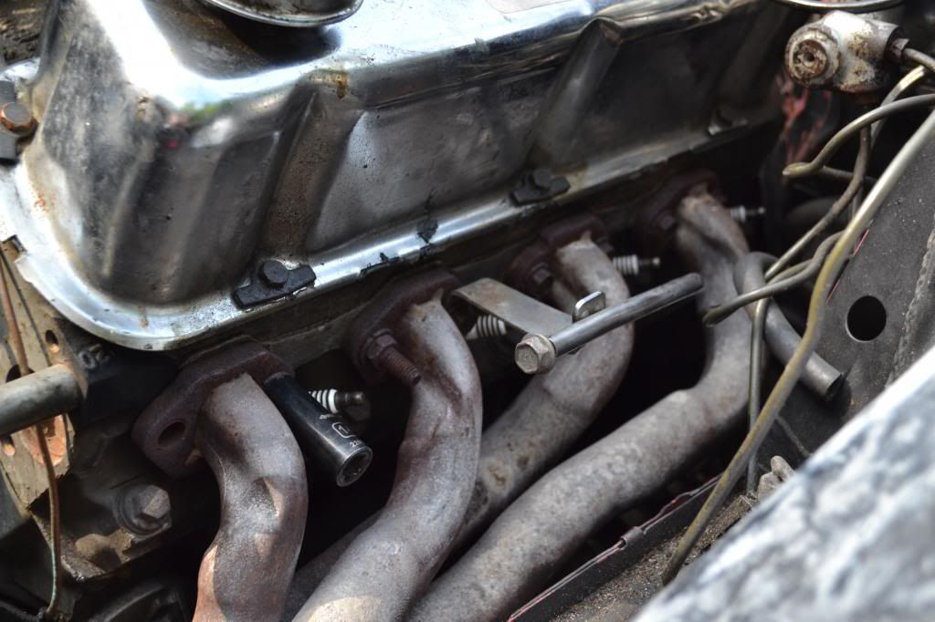

                          So I actually had a day off between my 50+ hour work weeks to get some work done to get the car back on the road. I needed to put my new clutch slave cylinder on and I also wanted to get my new headers on. Since taking the headers off makes the path to take the slave out, I figured I'd pull those off first.

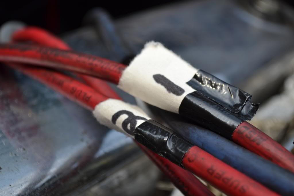

                          first I pulled the plug wires off after labeling their order.
                          Then started unbolting and pulled them off

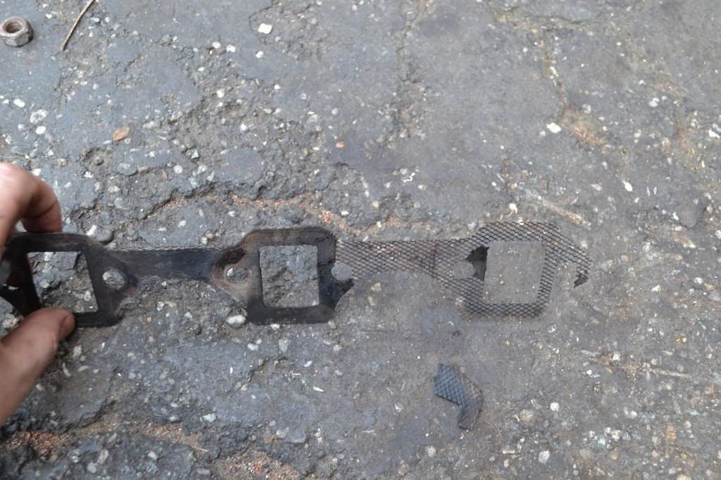

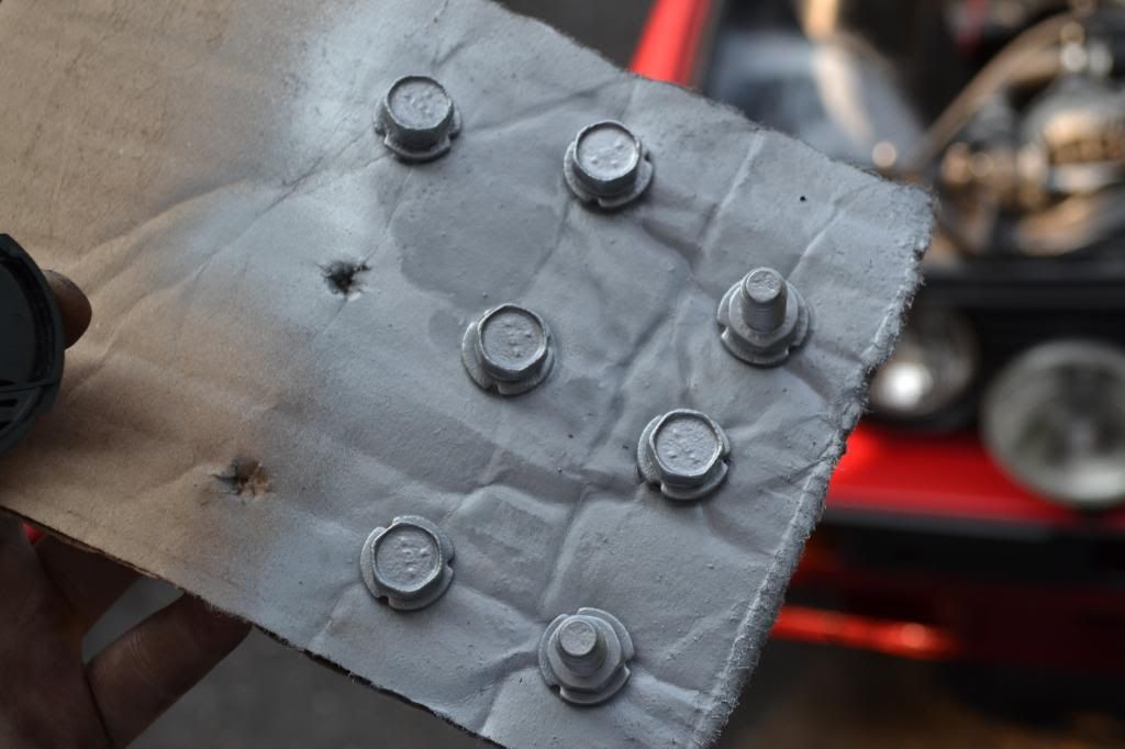

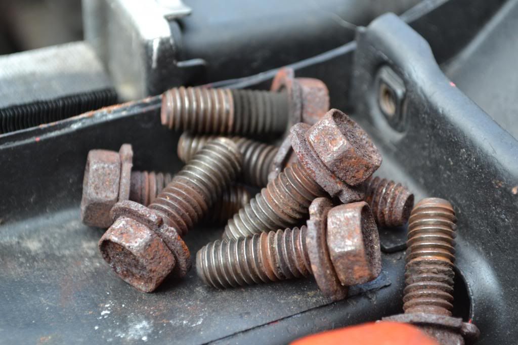

                          Now, I had been warned not to use paper gaskets for the headers, and today, I learned why.

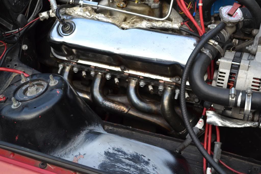

                          Here's a comparison of the new to old headers, and the new copper gaskets I had to put on.
                          While I had the rusty bolts off, I figured I'd wire wheel them and give them some primer and engine enamel paint. Before/ after

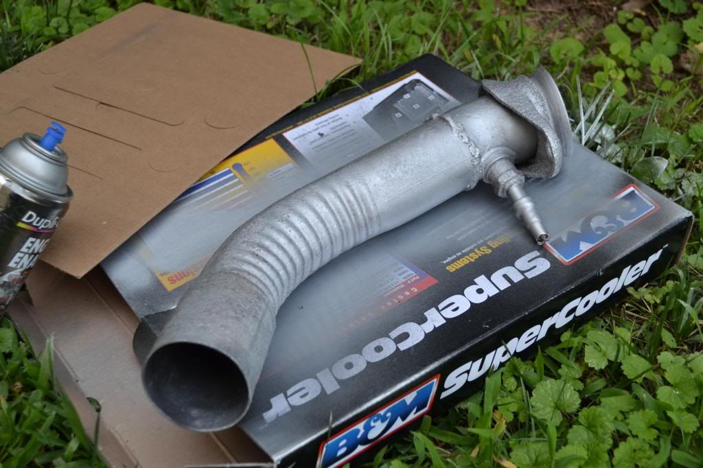

                          Also gave the "exhaust" a quick coat.

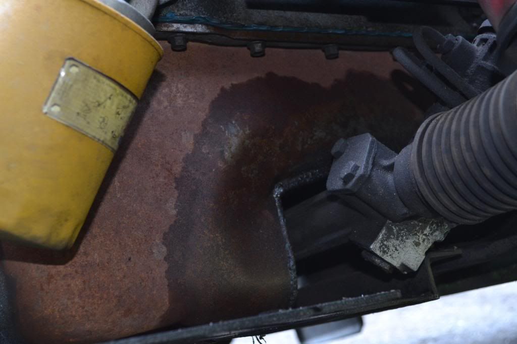

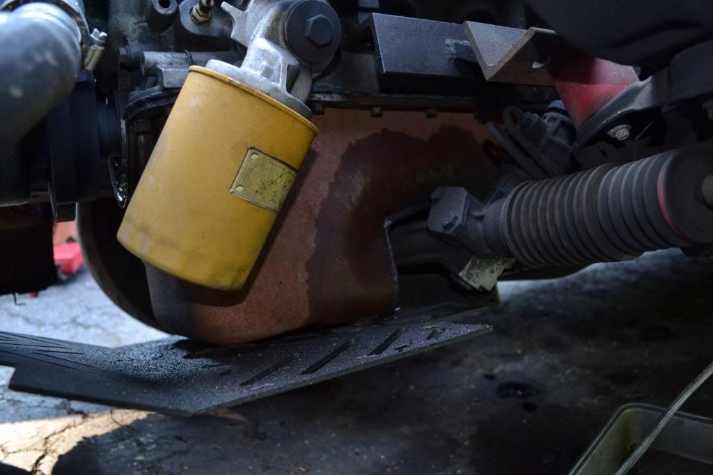

                          Now, while I was under the car I had another look at my tired, barely hanging on skidplate, and noticed something weird about the oil pan. I'll let the pictures do the talking, but the sides of the pan *use to* be flat.

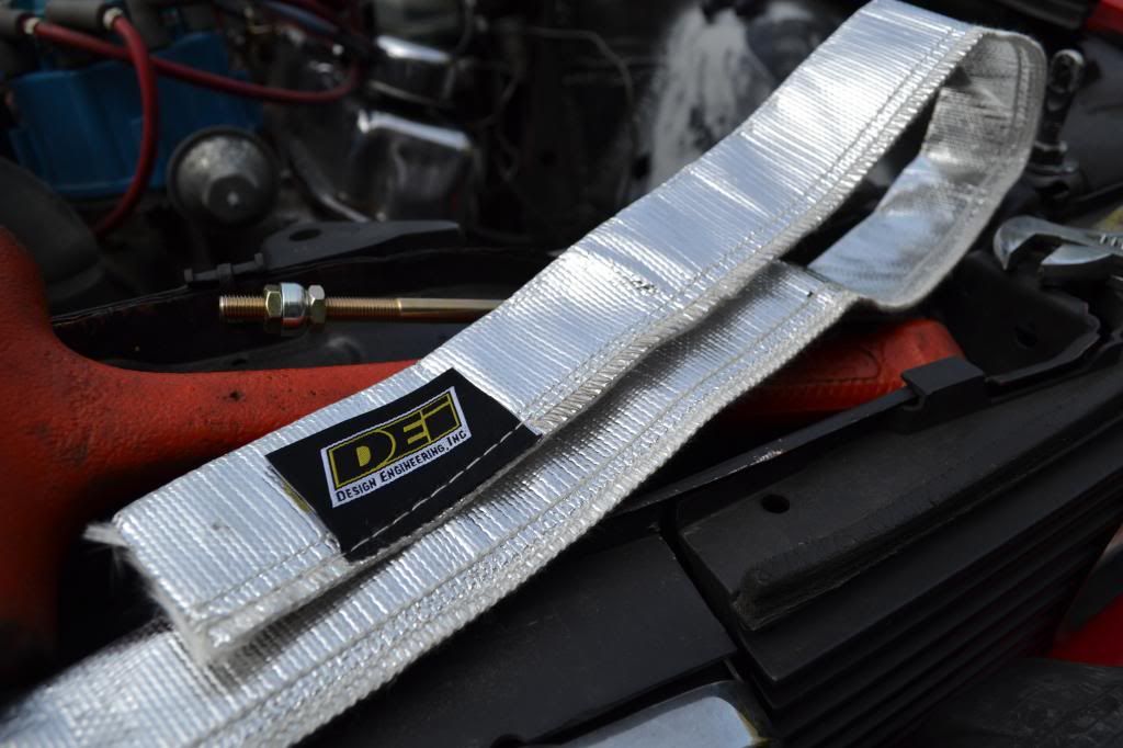

                          Now it was time for the clutch overhaul of a new slave cylinder, DOT4 fluid and a heat sleeve for the braided line.
                          Got that finished up and bled, we bench bled it and held the slave high in the air to rid the line of any more air pockets. Got it back in and adjusted, and I'm still amazed; there is so much more feel and clutch engagement linearity than ever before. I love it!

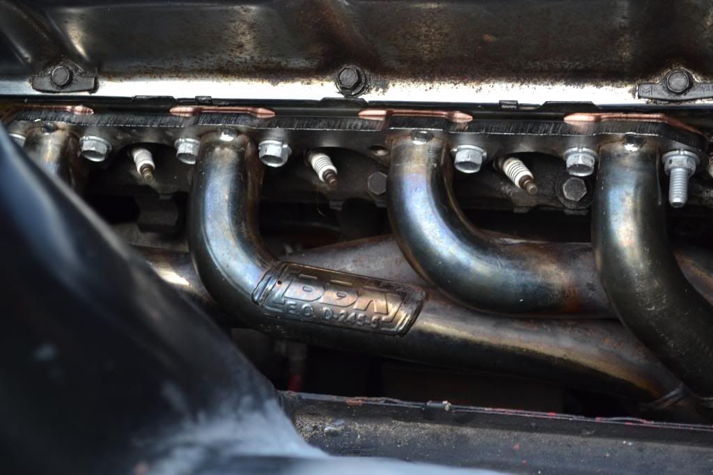

                          So now some pics of the headers on. Would look better if the rest of my engine/ bay didn't look like trash. But that will be fixed soon!
