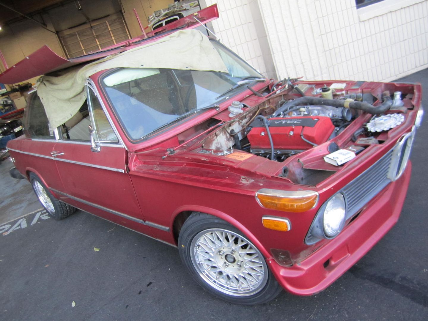

Catuned *** 1976 BMW 2002 Project F20C Swap NOW TURBO 400HP

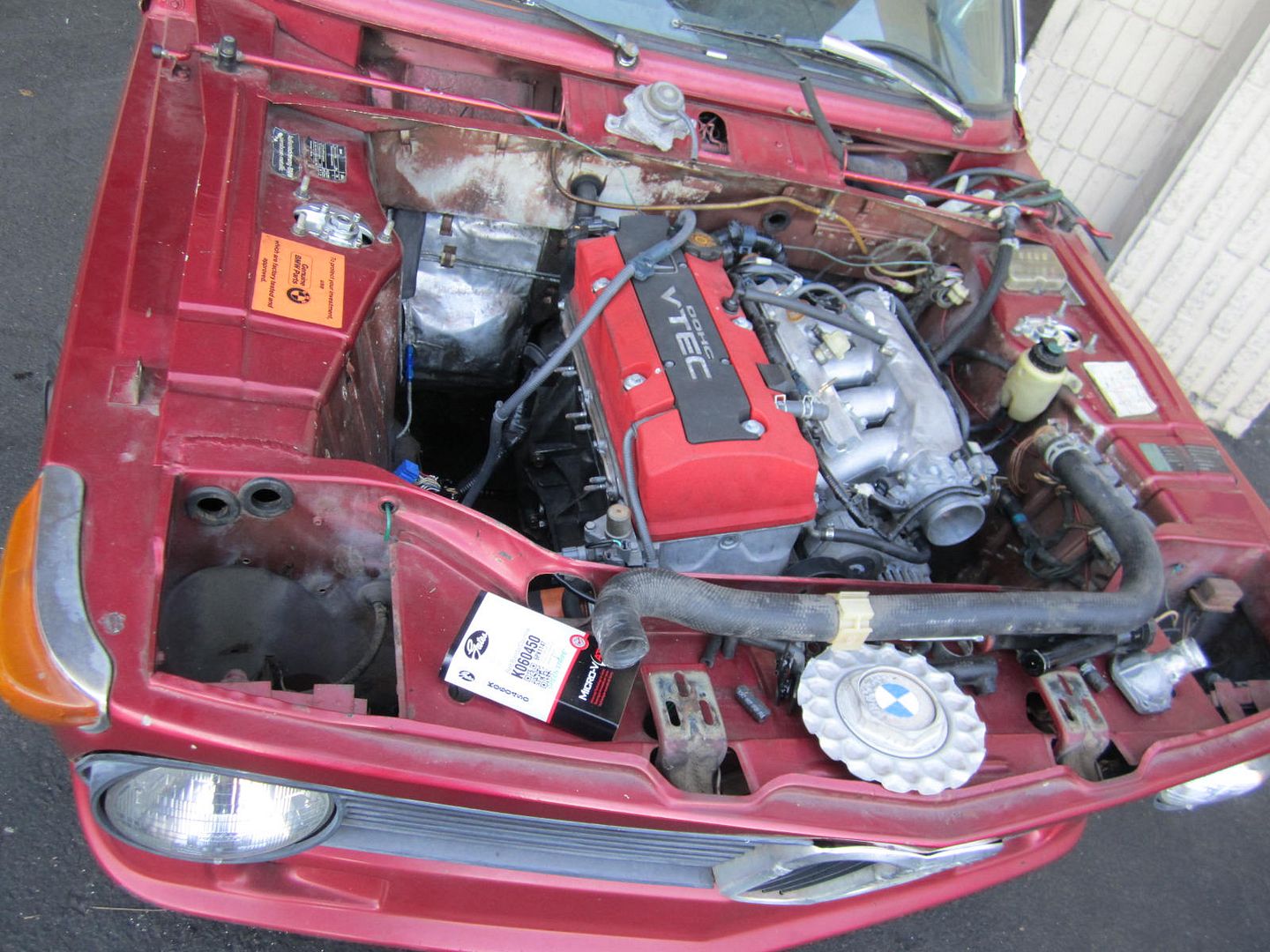

This is an insane project. I didn't get to read the entire thread, but do you guys use the same tranny from the s2000?sigpic
Yes we are using the stock F20C transmission.Comment

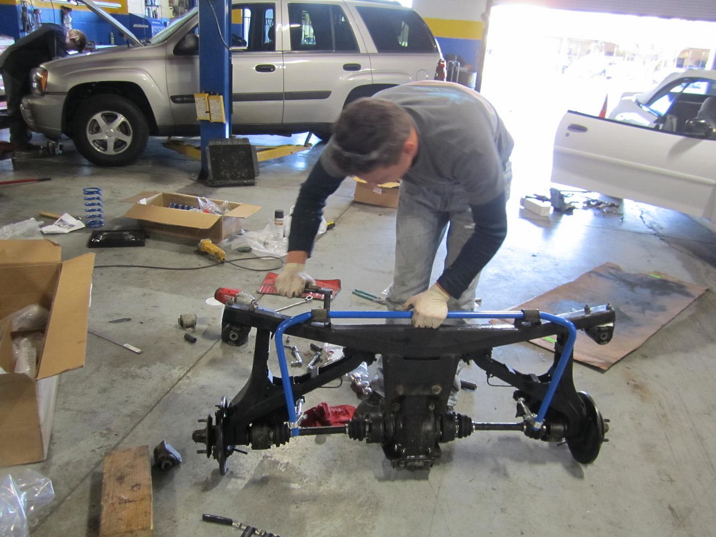

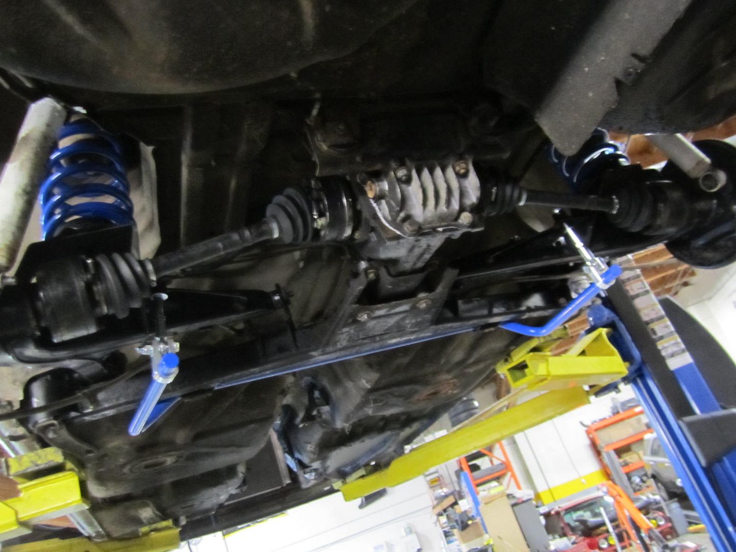

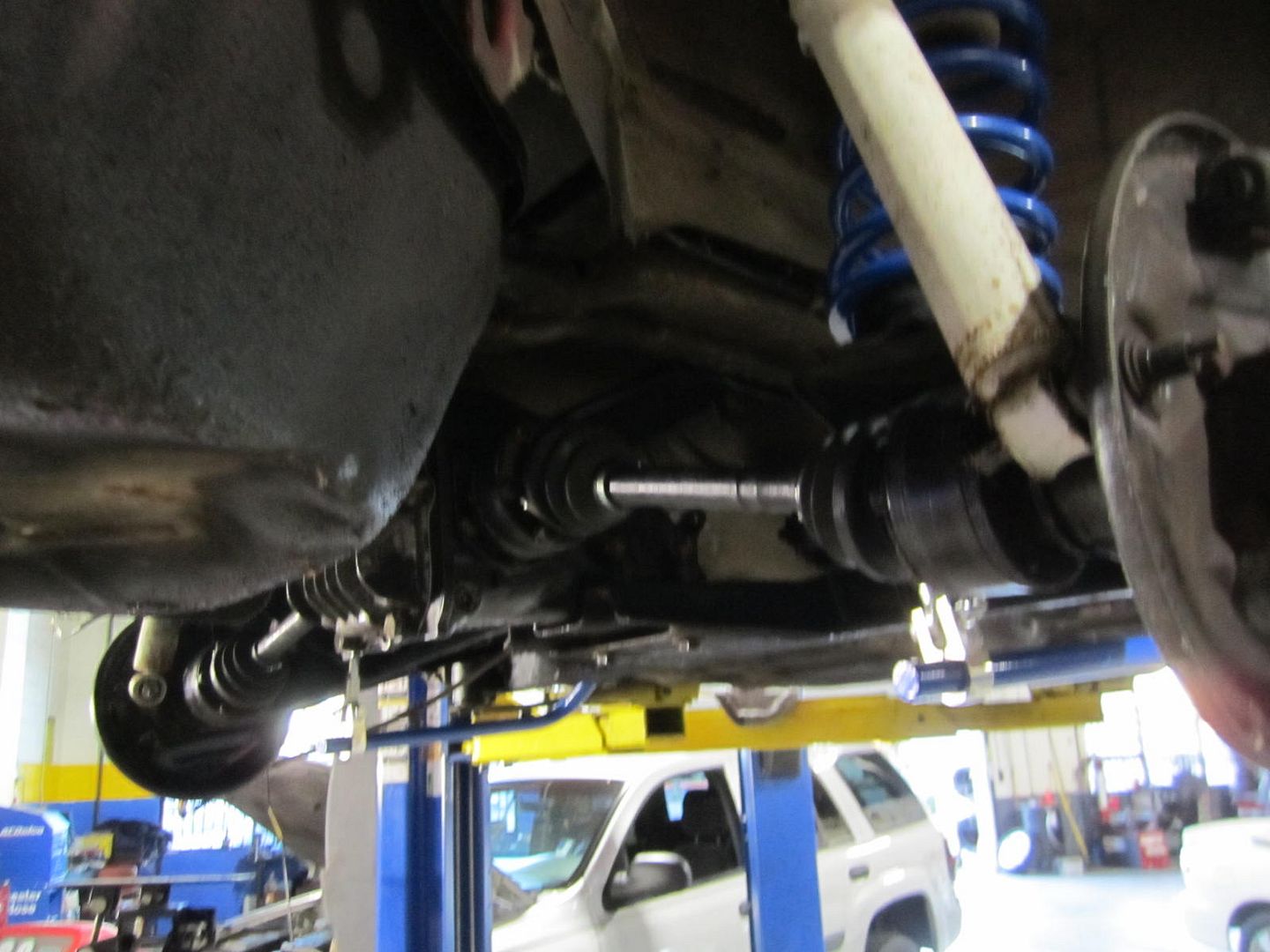

Sorry for the delay in response: We used the E21 320LSD w/ 40 locking and 391 gear ratio. 320 axles w/ 2002 axle ends.Last edited by catuned; 03-13-2012, 07:37 AM.Comment

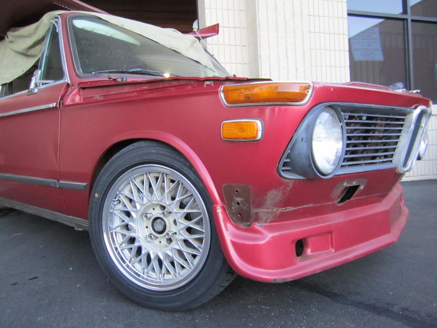

Looking good!. Keep the updates coming. What color are you guys going to paint the car?sigpic
Actually I think were keeping it like it is. It looks aged.Comment

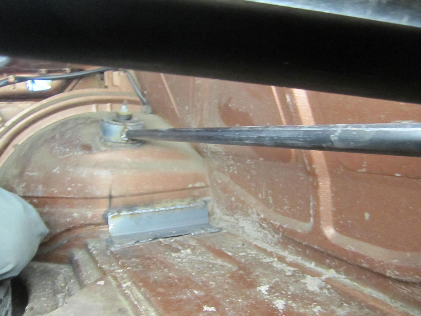

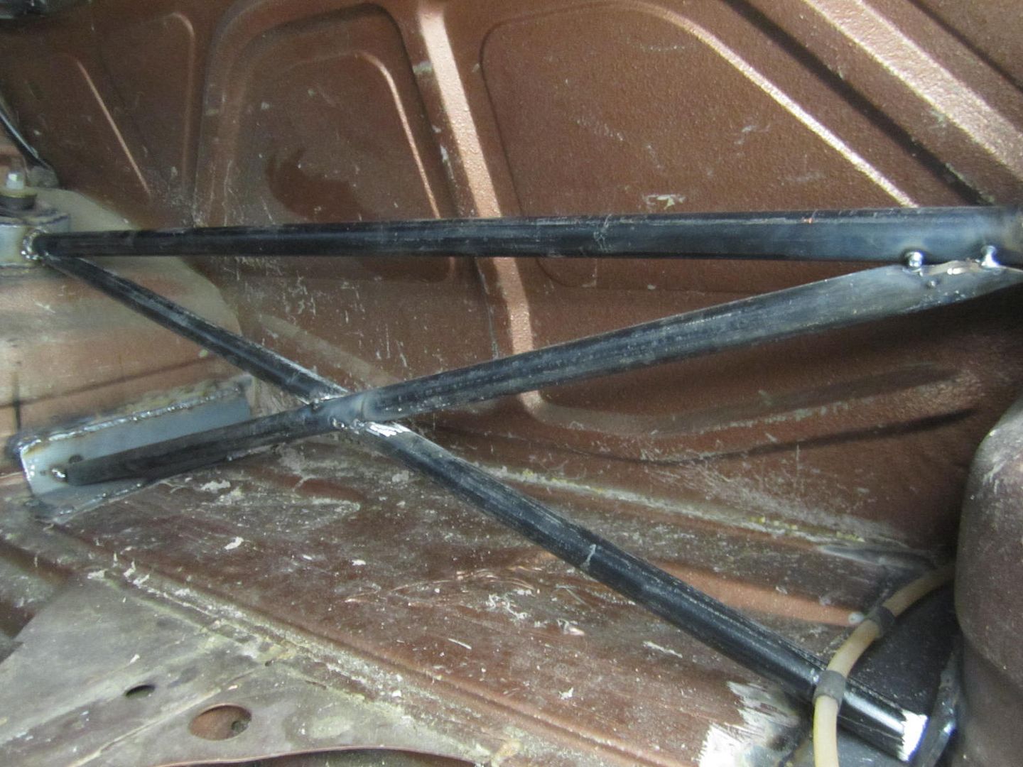

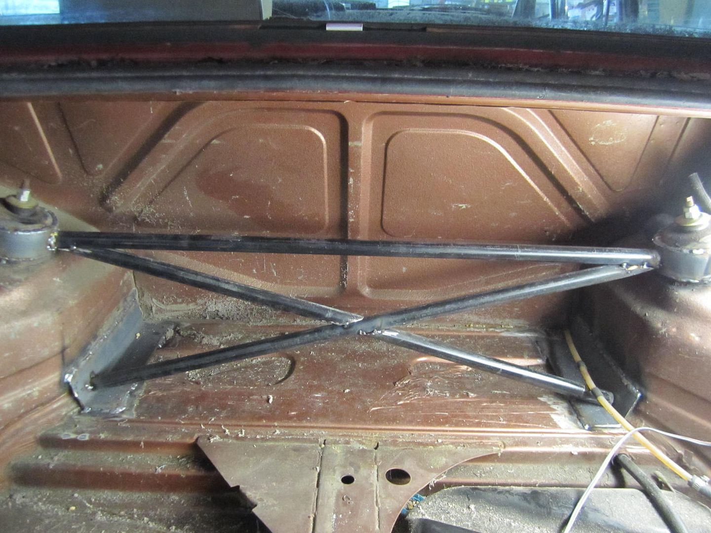

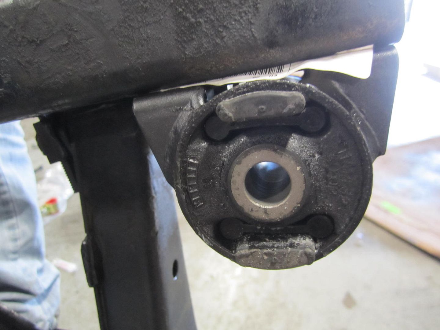

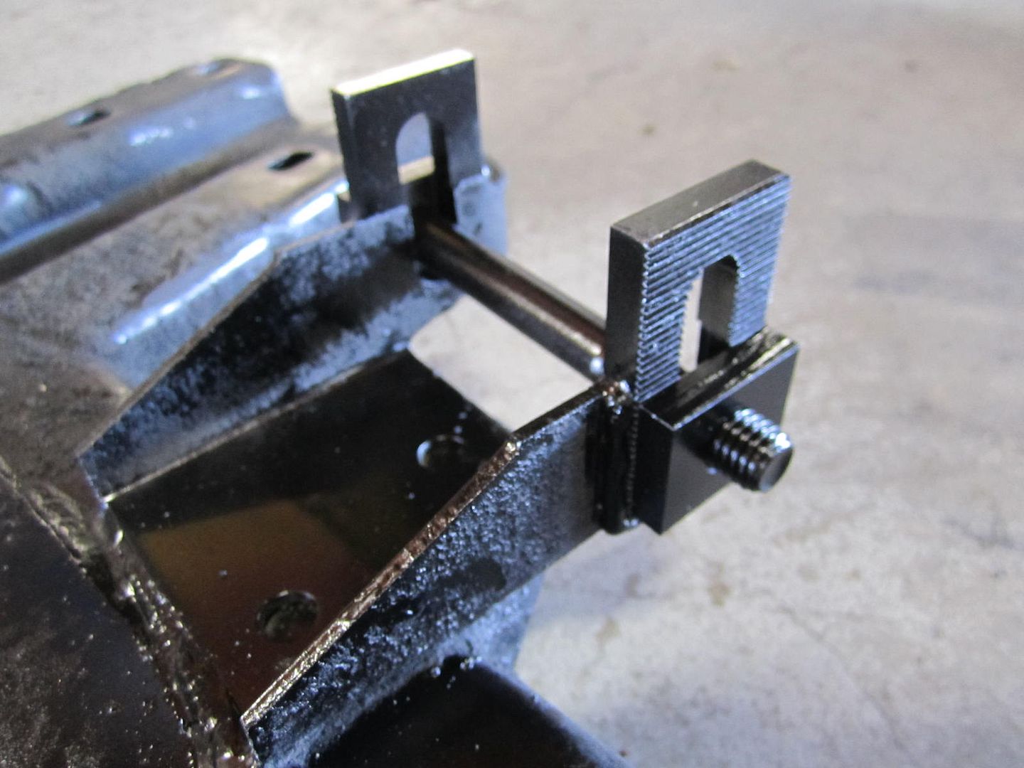

They are just ghetto drilled in house. It will still work. We will weld in for support. It's just for the time being.Comment
