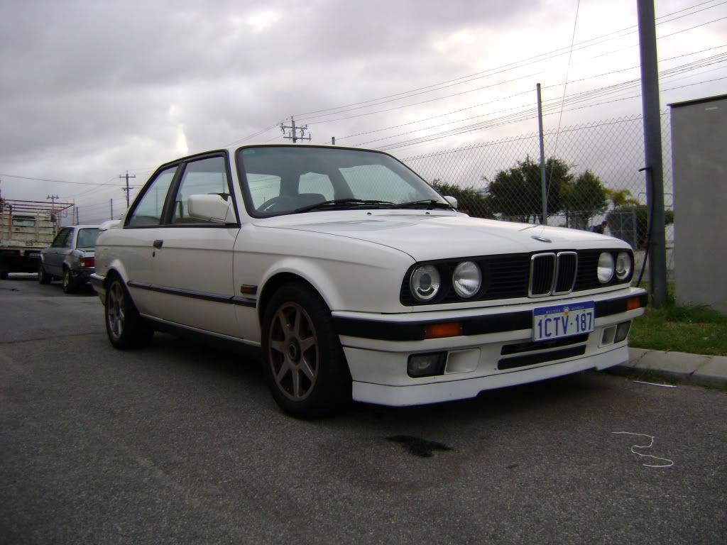

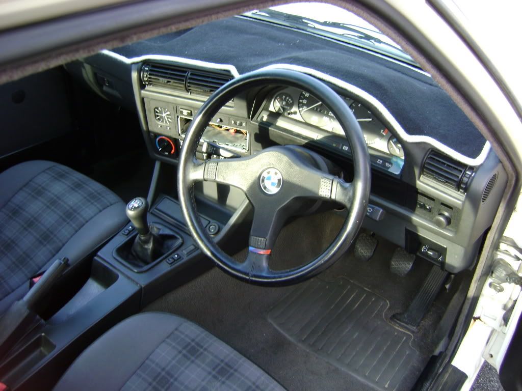

a couple of years ago i got my first car - an alpine white 1990 318is. brilliant.
The day it was purchased:
After a quick tidy up, I removed the double-decker spoiler which, IMO, looks absolutely terrible. Got an mtech-1 spoiler and swapped out standard interior for black E30 M3 leather sports seats and installed the 2 1/4" supersprint exhaust out of an E30 M3.

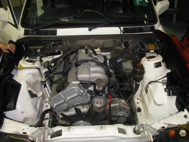

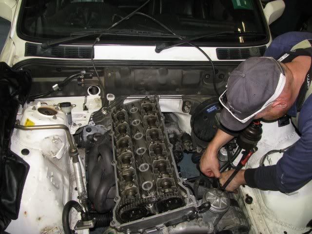

Getting ready to pull out the old M42..

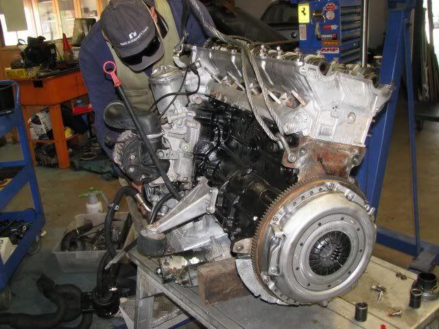

Assembling long motor. HD M20 clutch kit/lightened flywheel

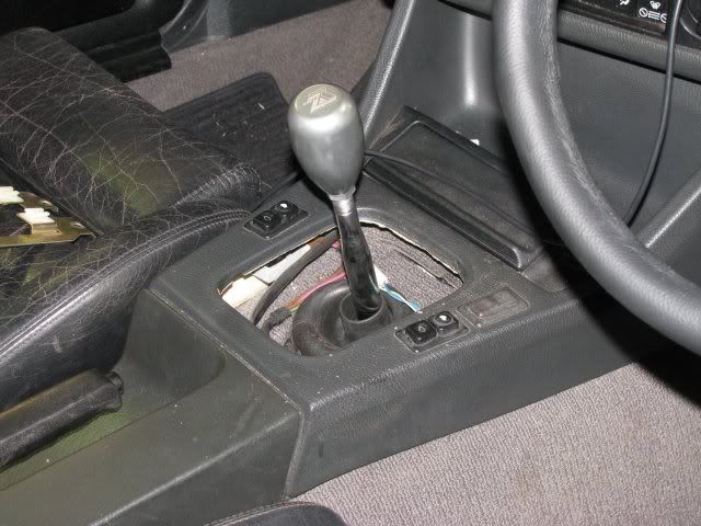

Ralco shortshifter + AKG selector rod. Boy is it tight!
Floor view.

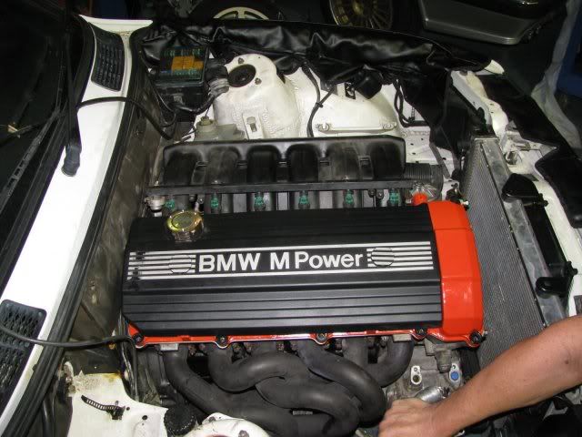

Custom extractors thanks to Rubin @ bm-autohaus.com.au, gave 20rwhp on the dyno when this motor was first installed in an e30 in '96 (yes, I do believe this engine is a bit of a slut)

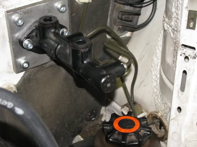

Brake booster delete plate to fit M50 manifold

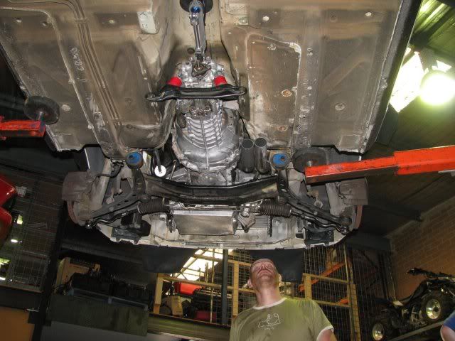

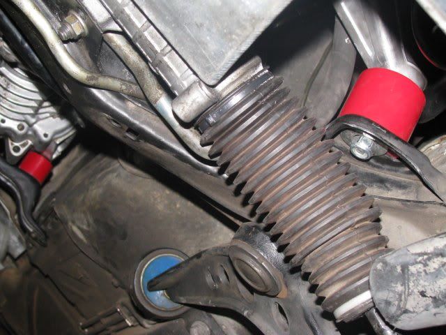

AKG Gbox and motor mounts, E36 steering rack

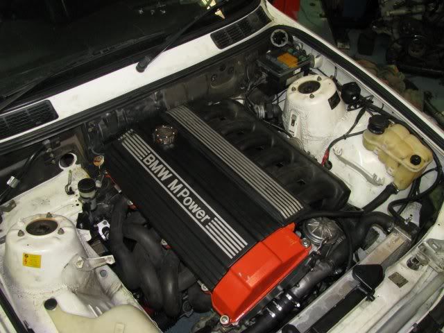

All assembled.

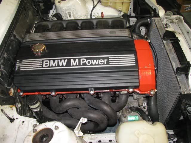

Better view of the prettyful extractors :)
