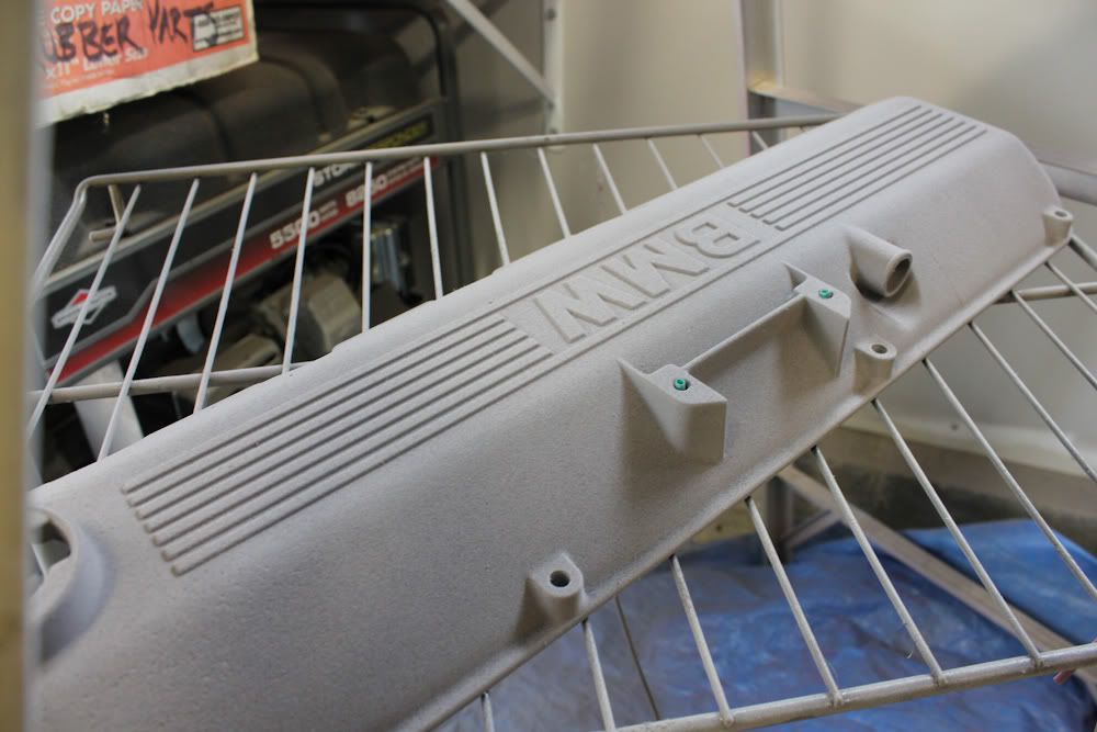

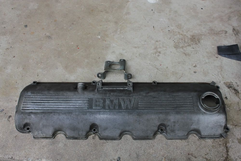

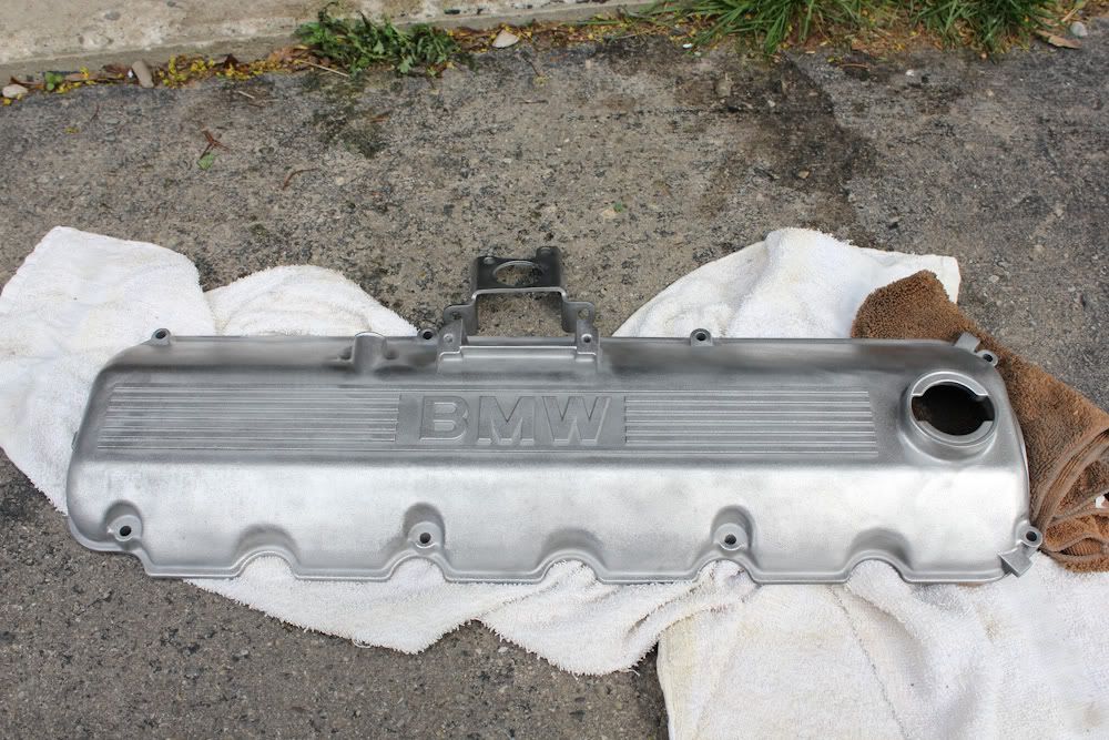

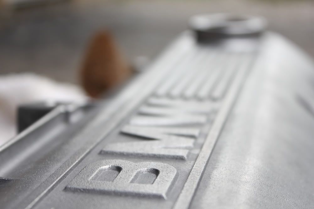

    Valve cover (dirty)
    Clean!
    shot it with some powder
    15 minutes later!

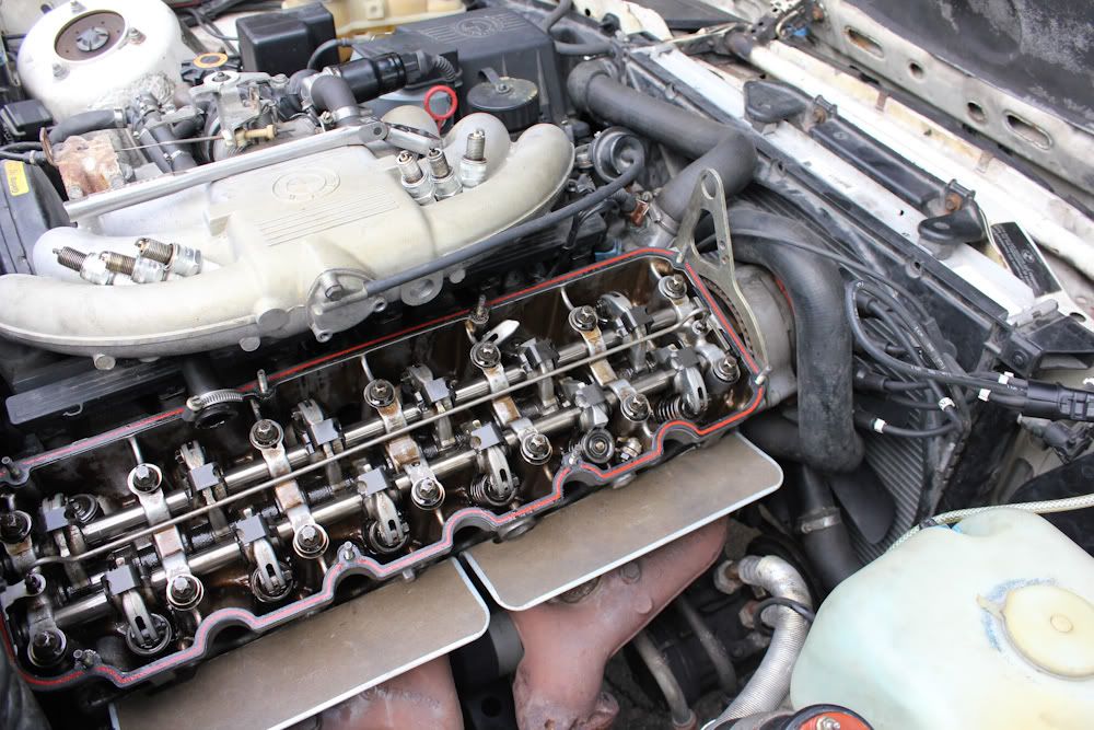

    Is your replacement head from an eta? it wouldn't work on a "I" car block. Valve cover is tits tho!

      Wow great catch! After taking a second look your right it's an ETA head.

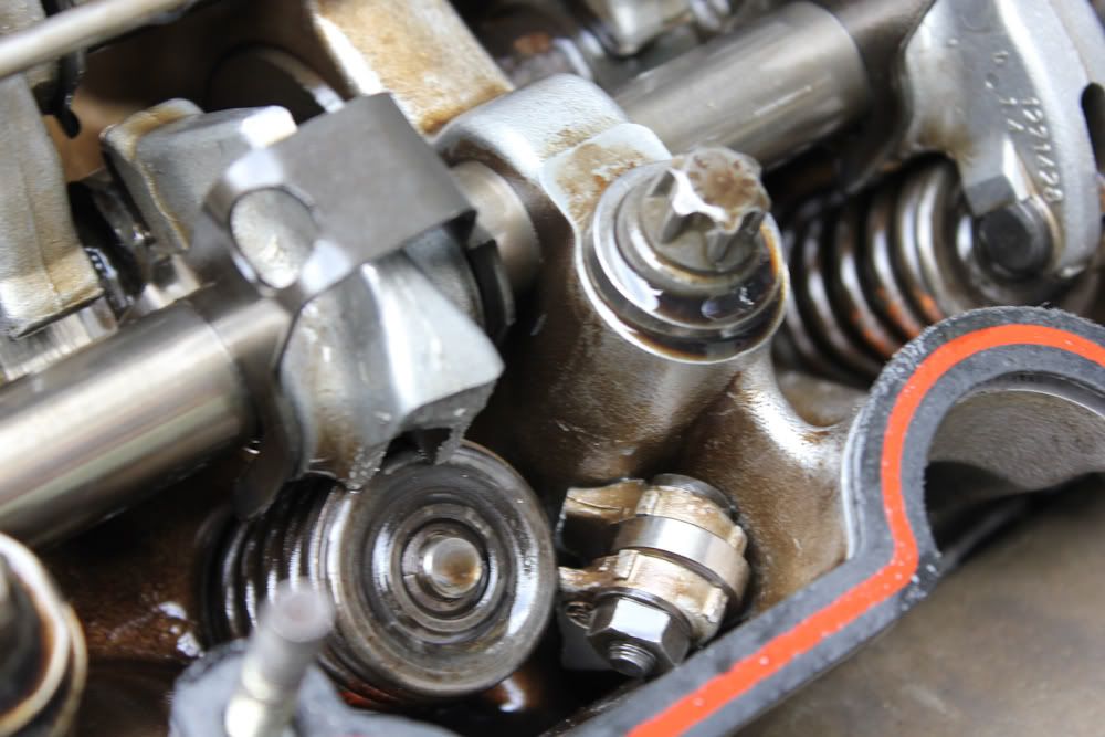

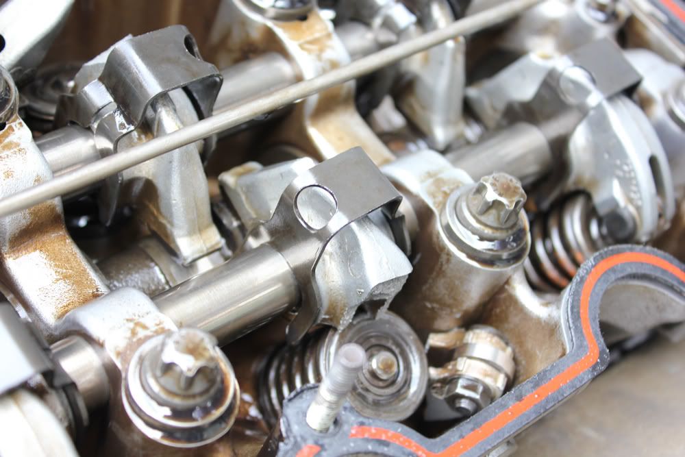

      After finding out that information I went ahead and did some of my own problem solving. Turns out the PO who replaced the rockers completely screwed up the valve adjustment causing cylinder #1 to show no compression. After re-doing the valve adjustment it started right up showing good compression on every cylinder.
      The top end still sounds like a broken factory from the 40's. The PO also appears to have only replaced a single rocker and with 200k the rockers and shafts are worn out to say the least. Since I already ordered the headgasket/timing belt kit I plan on transplanting the rockers/shafts from the ETA head, so it won't go to complete waste.

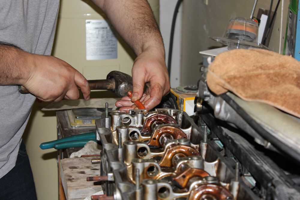

        M50B25tu
          putting in work

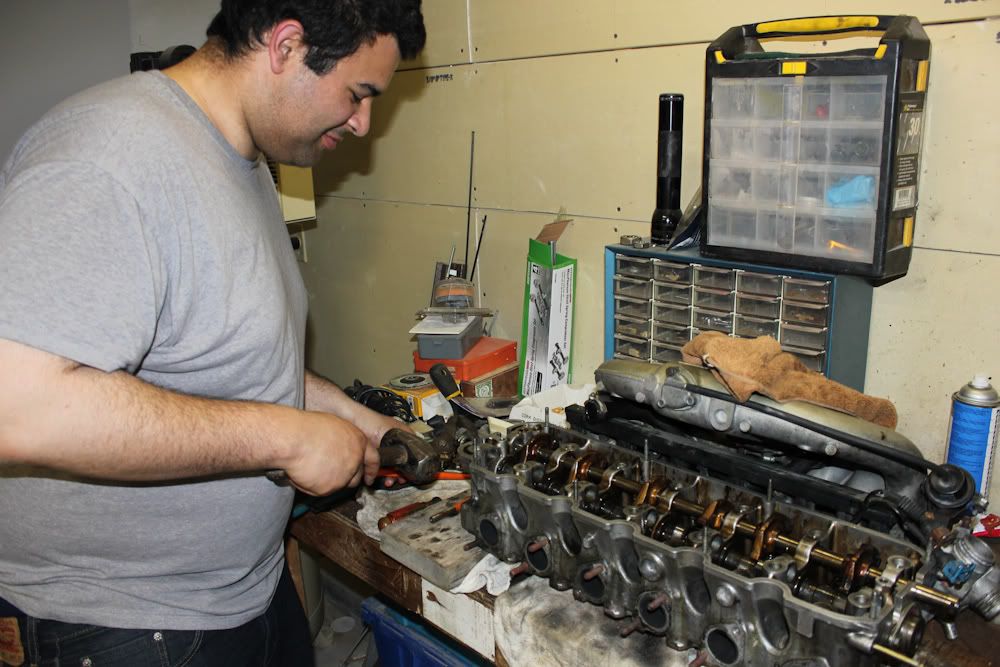

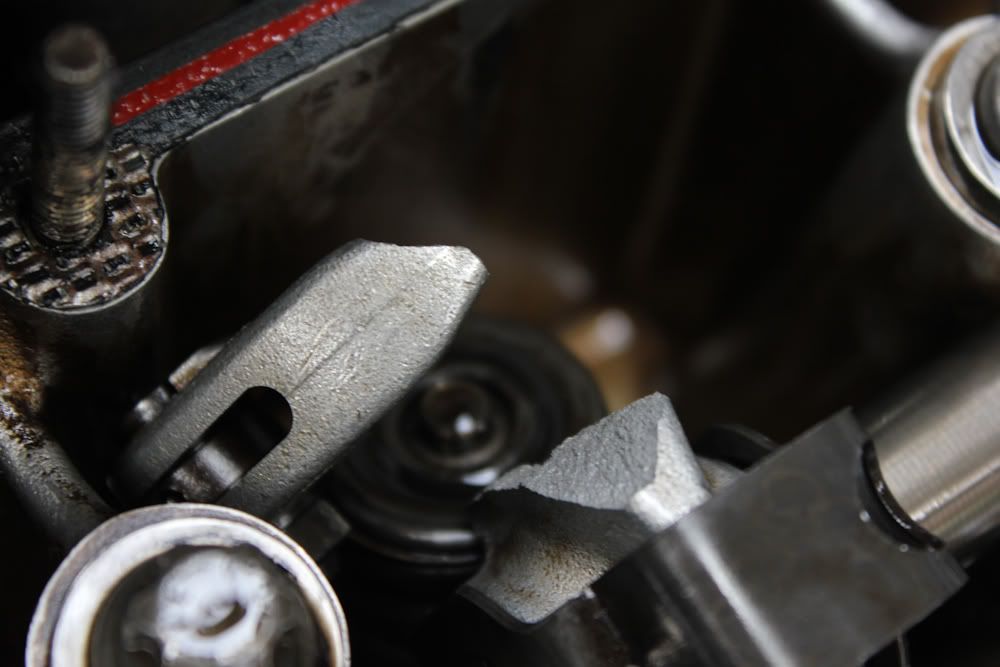

          After attempting to quite the engine down and doing numerous valve adjustments with no success I planned to swap the rockers and shafts from my E head into my current head. Turns out the rockers were on their last legs.
          A good friend of mine helping me out!
          My goal is just to get the m20 running reasonably well until I can put a twin cam swap together.

            After swapping the rockers the m20 is running much smoother! Still seems to have intermittent starting issues and is lacking a very slight amount of power at the top end. Overall I'm pleased with the results but will be investigating further into the lack of power.

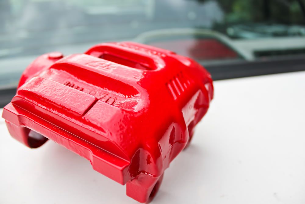

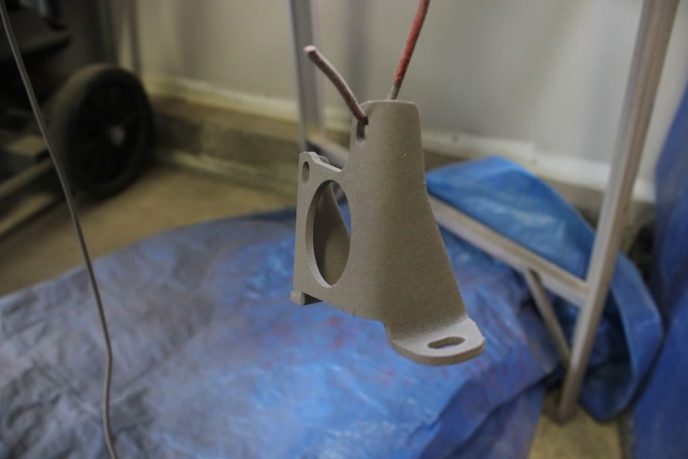

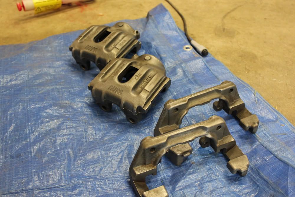

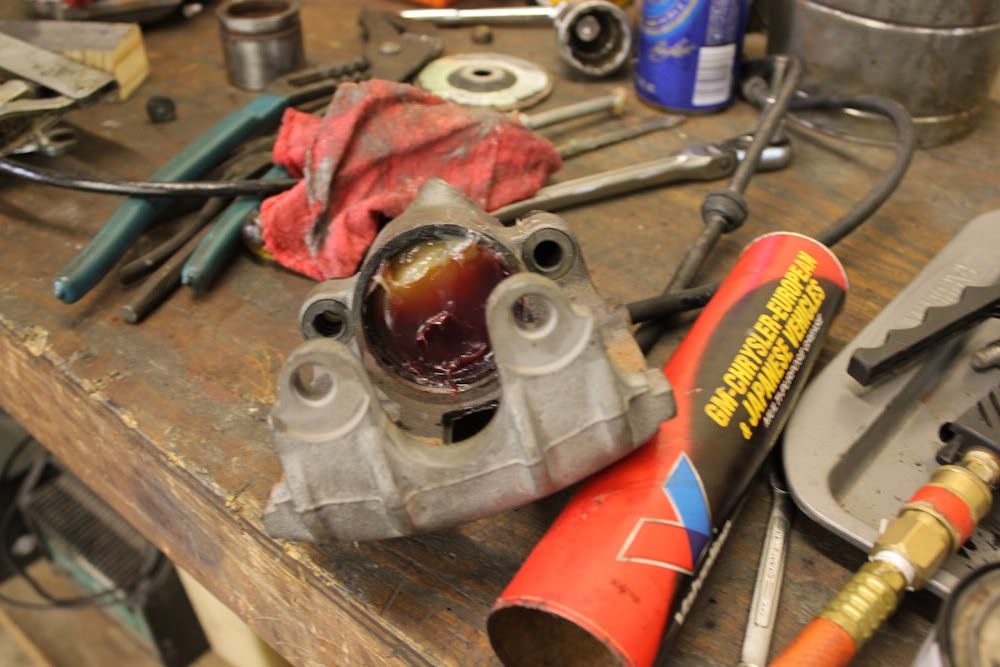

            Up first for reconditioning are the calipers.

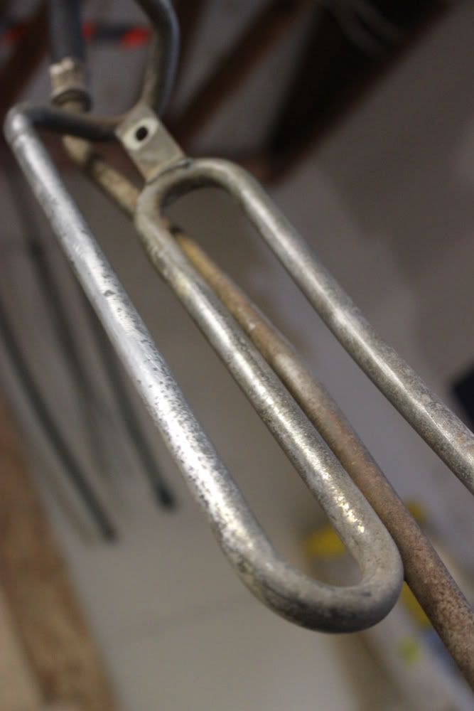

            Remove the piston with a SHIT ton of grease.
            Make a mess..
            Keep greasing until your calipers resemble this.
            Now make an even bigger mess with the powder-coating gun.
            Finished shots coming soon!

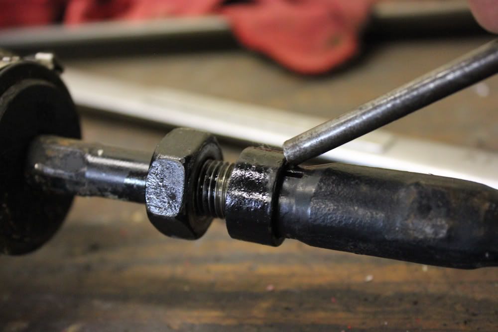

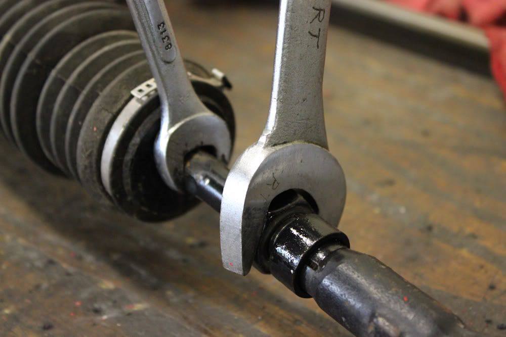

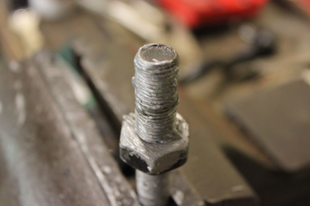

            Now for the steering rack.
            Loosen the nut
            Pound the cap off

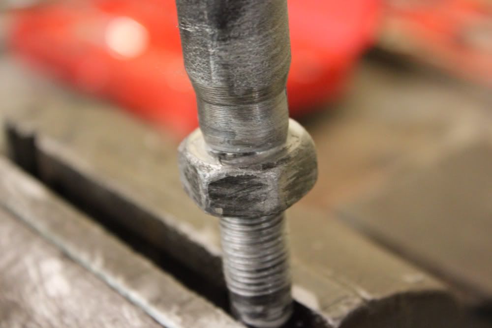

            Heat up for 10 hours hours

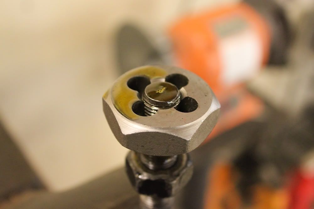

            Tap the threads after man-handling the tie-rod off
            Apply an extremely generous amount of anti-seize
            And your done! Unless your like me and forgot to put the cap back on.
            One clean, fully functioning steering rack ready to be installed!

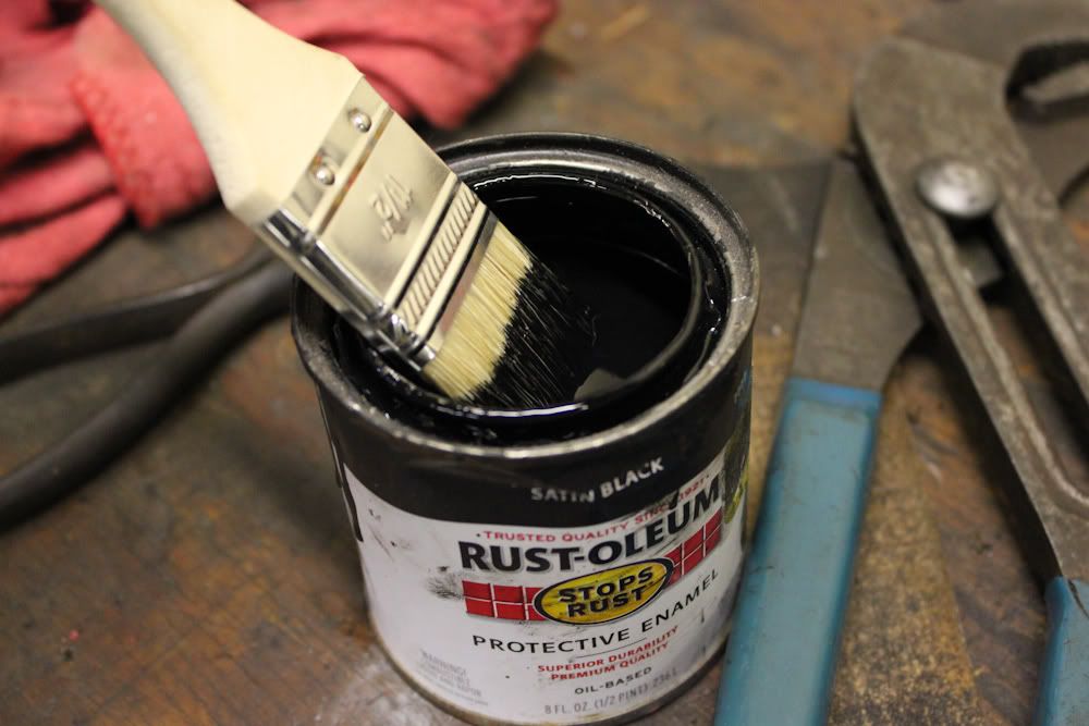

            While the steering rack was out I decided to paint he high pressure lines with RUST-OLEUM
            Finished pics coming soon!

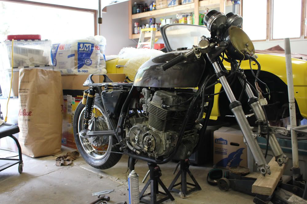

              Lookin good. was that a honda cb?
              I've got a pair of cm400/450's i'm wokring on.

                Thanks! Yea it's a 79 cb750. It's turning into a bigger project than I ever anticipated, which is usually how it always goes.

                Finished Front Calipers

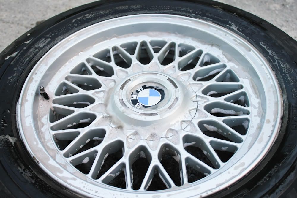

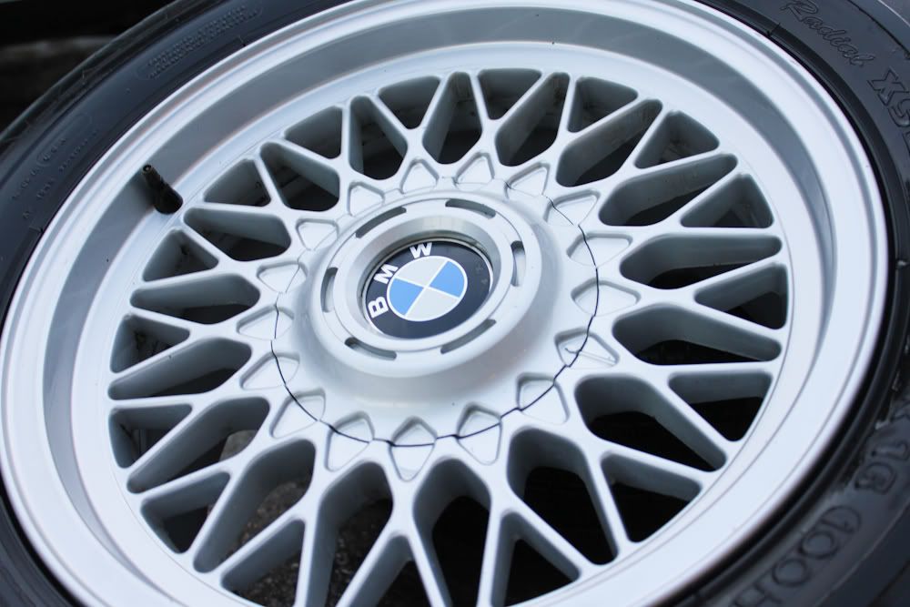

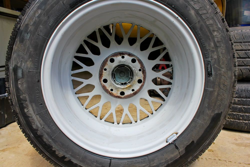

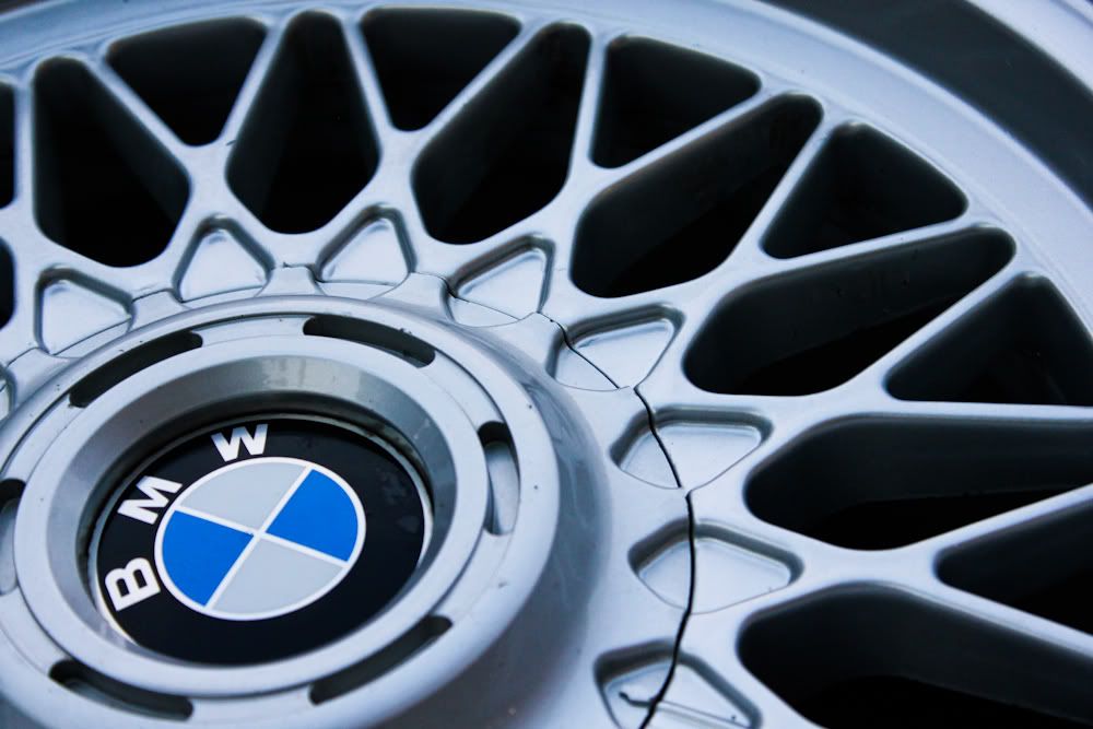

                Picked up some style 5's this weekend. Needed some serious elbow grease, other than that they are in great shape.

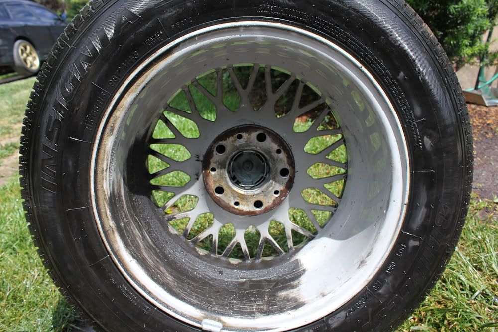

                After scraping the back of the wheel.......
                Materials consisted of degreaser, scotch brite, a shit ton of elbow grease, and a phone, to call a friend for moral support.
                Halfway there
                Inside finished, finally!
                Now cleaning the face of the wheel.
                Moral of the story is style 5's are a complete bitch to clean. They are still dirty and I need to buy some actual wheel cleaner to get them right.
                Stay tuned....
