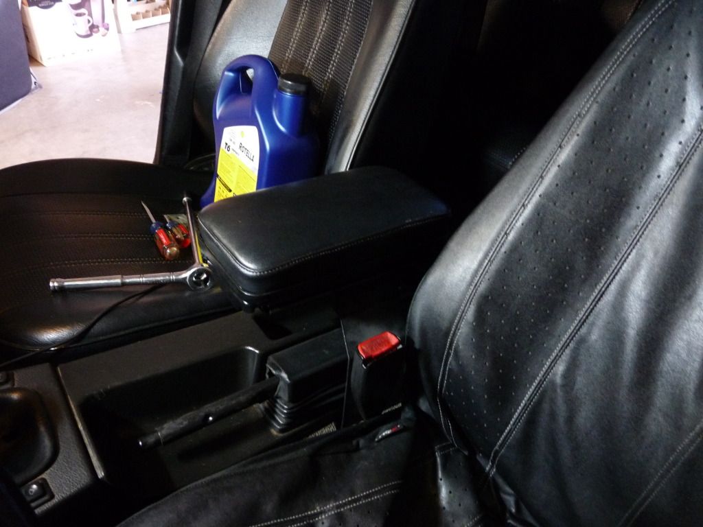

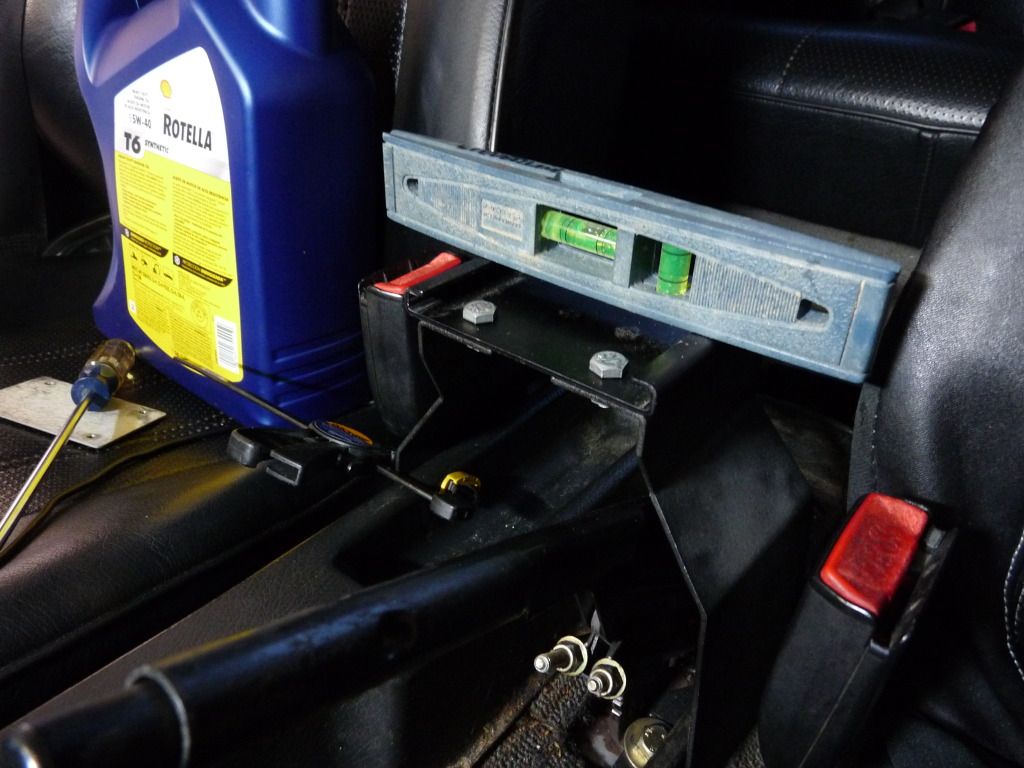

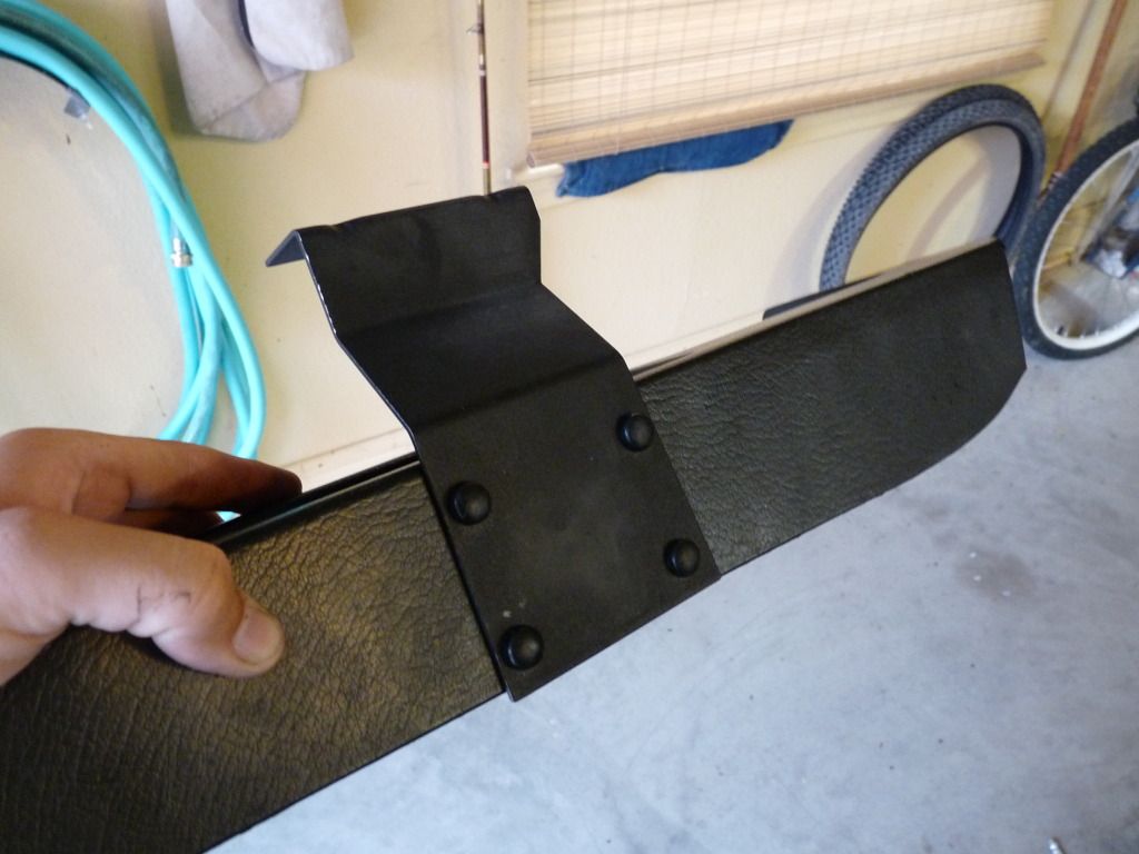

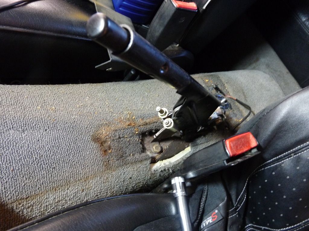

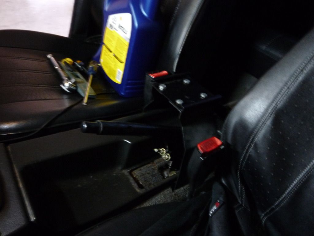

                          From there, I finally got around to installing the Husco armrest I bought off here a while back. I'll go ahead and show some quick pictures of how I installed mine, as I couldn't find any pictures beforehand.
                          First off, I removed the console and cut away a small bit of carpet around the E-brake handle:
                          Then I added the left bracket and a washer for good measure:
                          I bolted up the top plate and the right bracket, and aligned them using a level and eyeballing for straightness:
                          I marked the holes on the side of the console, drilled them out, and bolted up the right bracket:
                          I threw it all back in the car and bolted everything up nice and tight:
                          And there we go. Armrest.

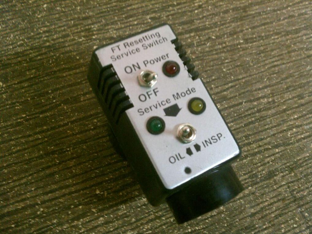

                              Found this bad boy in the glove box when I was fixing the broken hinge.
                              1991 318i SOLD
                              2003 325i SOLD
                              Racecars and stuff.
                              • Court M3
                                • Jan 2004
                                • 6713
                                Nice find! Wonder how many people still have these? Mine was in my car's glove compartment as well.
