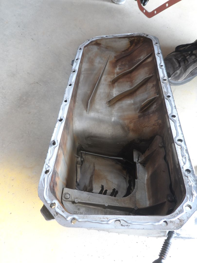

        Jon and I worked on some prep on the motor while Jason removed the old pan from the new motor.
        Had I known that we'd kill about an hour doing that, I might have tried to re-tap the pan for a larger oil plug. I will be doing that anyway to have a spare pan, but I was set on installing the crank scraper so I thought that I'd be pulling the pan anyway.
        In the end, we gave up on the crank scraper, so pulling the pan for the sake of doing that was a complete waste of time. I should have stuck with the existing pan and re-tapped it.
        So after pulling the pan, we used Right Stuff grey and a paper gasket and installed the pan:

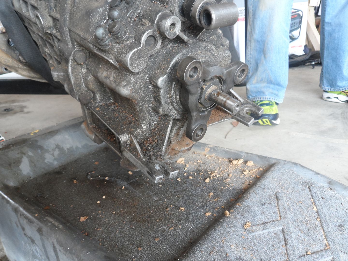

        So as mentioned a page or so back, I had the wrong flange for my driveshaft so I was trying to swap on a large flange. I bought a spare flange and the 30mm socket, but despite 3 people fighting the 30mm nut, we could not break it loose with a prybar, with an impact, or with wishful thinking. In the end, we installed the eta transmission, which was (knock on wood) working perfectly when I pulled the eta motor. We can still swap flanges later if we have to use the "i" trans, but for now we are running the eta trans.
        Dirty, but it does what it needs to do.

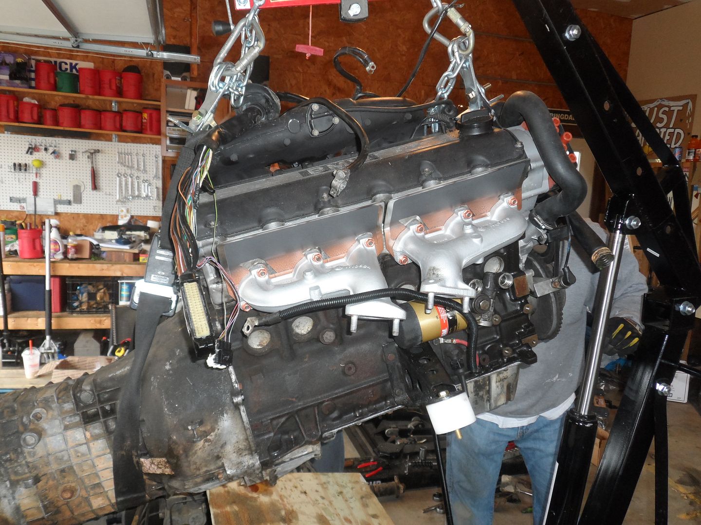

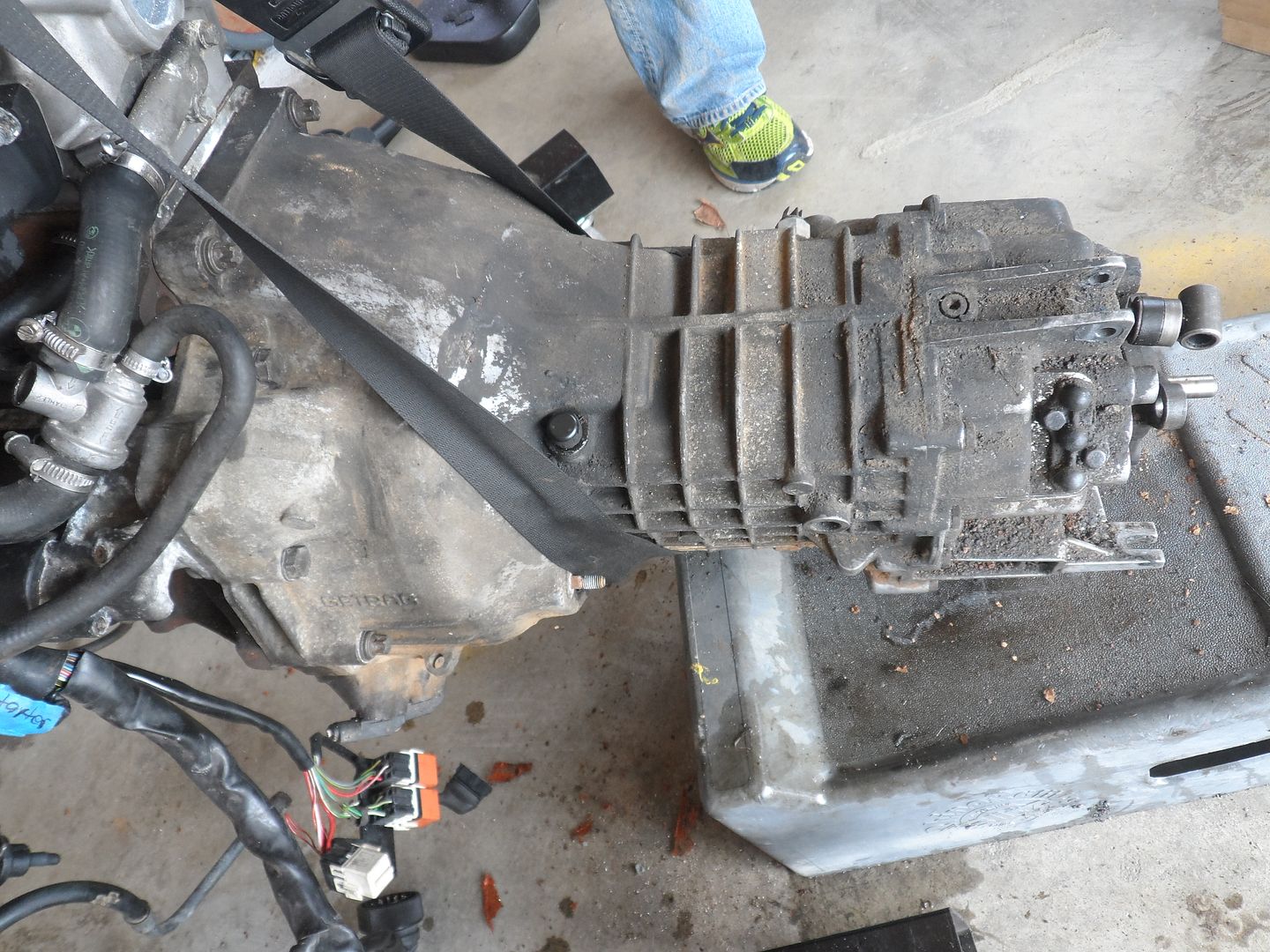

        We initially lifted the B25 by the front motor lift point and the transmission using a load leveller and the rear seat belt serving as a sling for the transmission. This was fine until we realized that we needed to swap out the transmission and had to take the weight off of the trans to accomplish that.

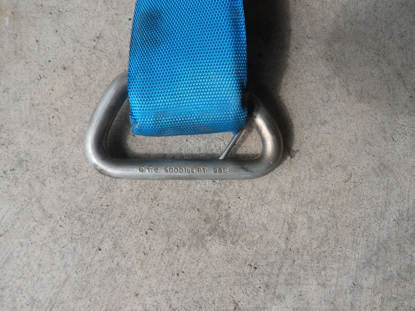

        The solution was to rest the trans on a Rhino ramp to lelease the tension, then use a 6400# rated lifting sling and to use 2 5000# rated carabiners to hook the sling to the top links on the load leveller, then to re=lift the motor with the transmission not in the lifting chain.
        The carabiners look like this:
        After swapping the transmissions, we reversed the process.

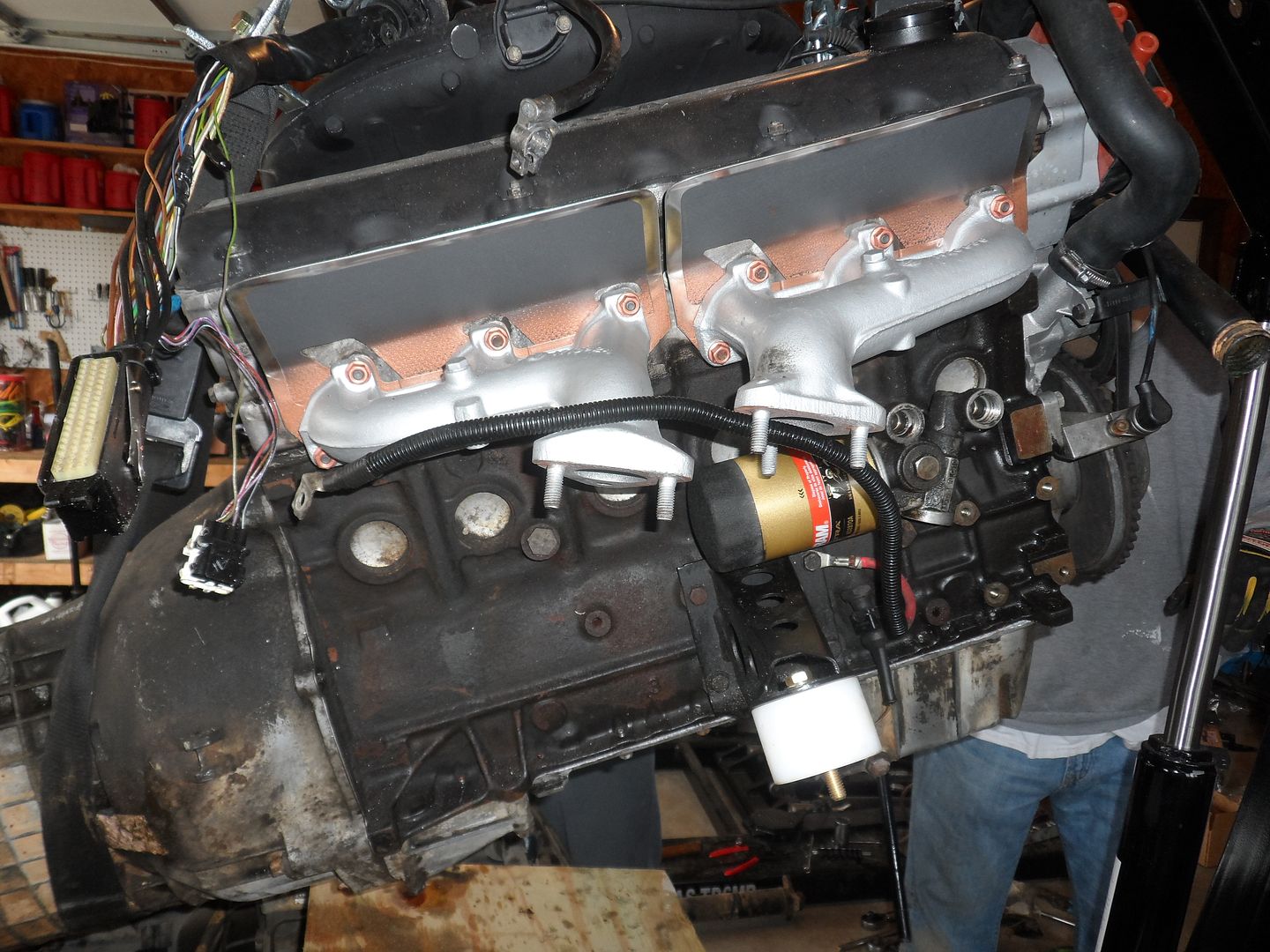

        So after some fun gymnastics with the motor on the hoist to swap the trans with the motor still hanging, we started the actual install.
        Condor Speed Shop mounts about to go in:
        And in the car:
        The installed pictures of the motor are already posted above.
        We are not 100% confident on whether the fuel line and return are in the right orientation, but flipping the is easy if I got them backwards.
