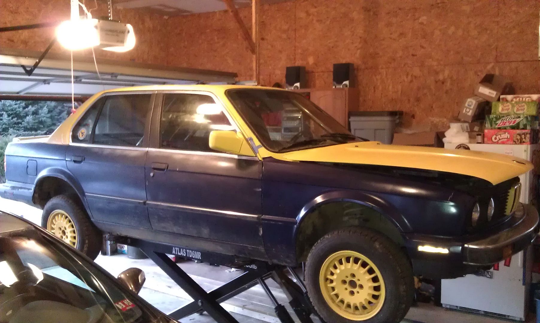

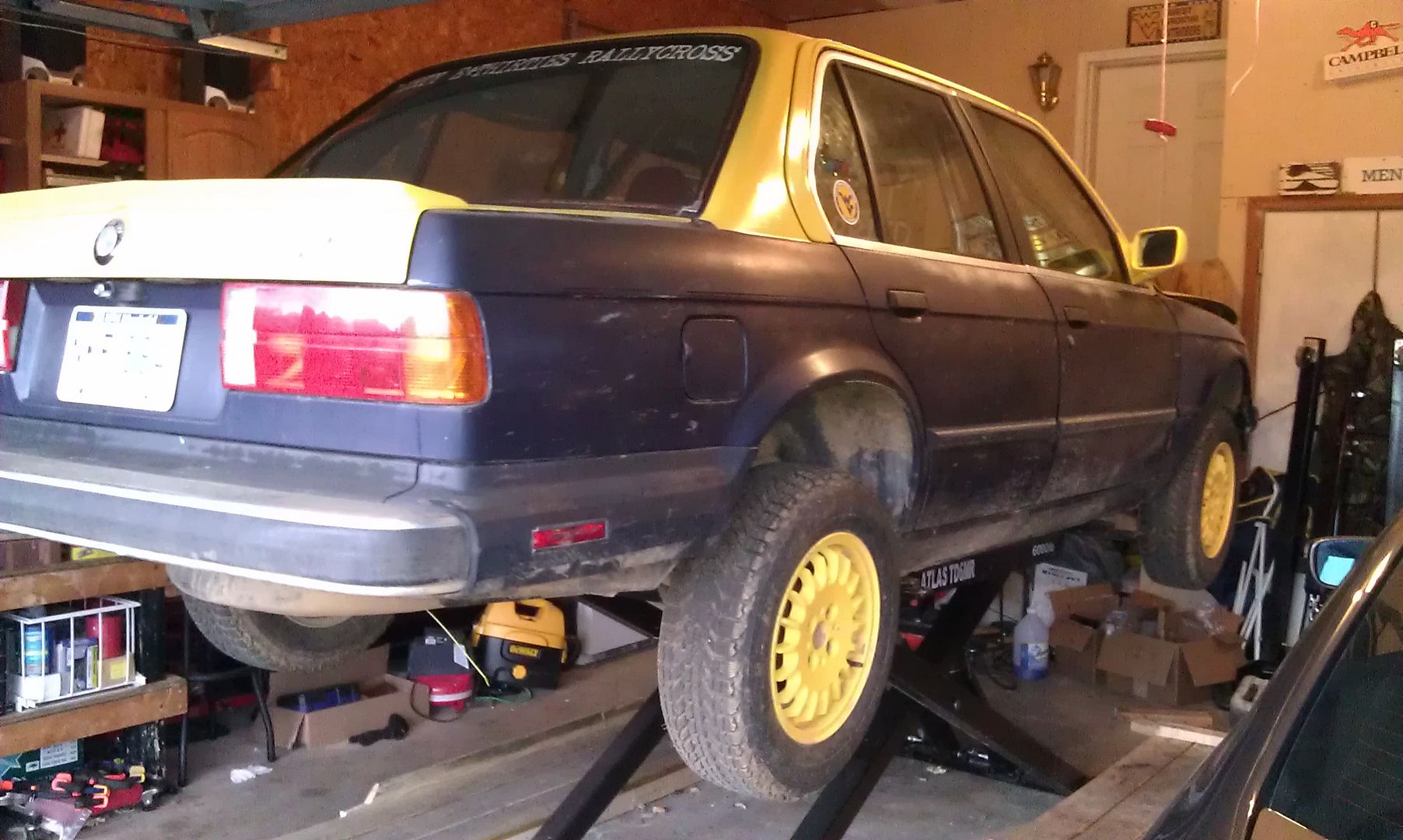

    So last night I got to get the car up in the air to work on it. It took nearly 20 minutes to get the car to run well enough to drive the 25 feet from the parking place in the driveway, onto the ramps, and to have it lined up to go up on the lift. FORTUNATELY, once it was up in the air, working on it was fairly simple and I was able to get the exhaust laid out. I need to get a few more parts lined up a little tighter, but overall I am happy with the path of the exhaust. Hopefully I can get it on the car and attached tonight, even if it isn't the best setup.
    A couple pictures...
    On the lift (not all the way up, but as far as it will go without hitting the garage door with it open):
    Muffler in roughly the final position:
