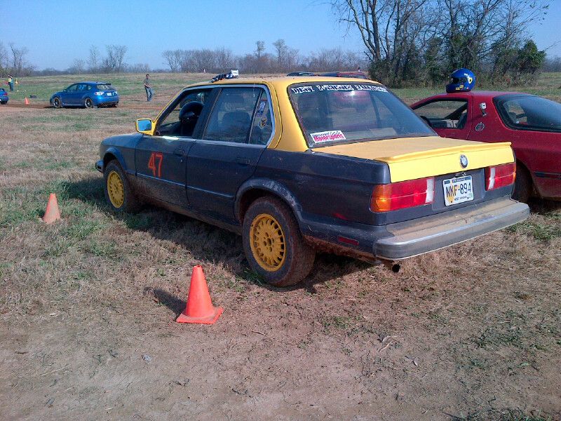

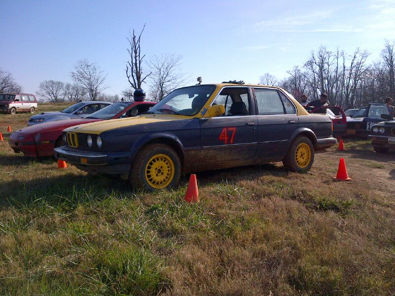

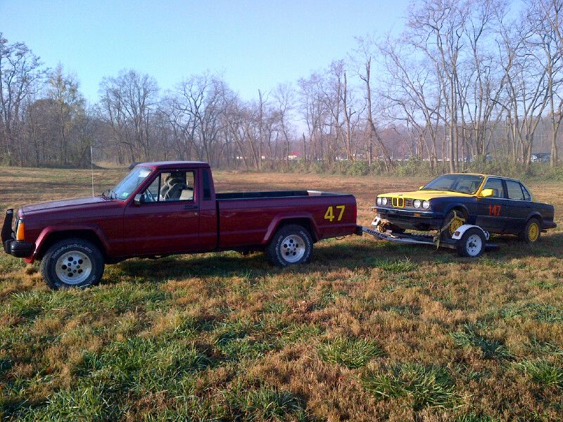

So the car survived the first actual race event, and held up well (as far as I can tell).
First, pictures:
