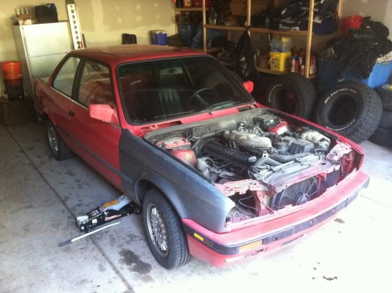

    The car started off as a late model 325i, and it spent a good portion of its life living in a very rust inducing part of the United States. Needless to say, it suffered from rust in a multitude of places. Which sucks for a car that you would like to use to get around. But doesn't necessarily suck quite as bad for a trailer, that you wont be using to get around in everyday.
    Thus, it quickly became clear that something had to happen, and the most badass of options was to turn it into an E30 trailer. There are other creations that have alreay been built that offered a relatively good idea of what to expect. So the car was taken on its final drive and dropped off in my garage, where it would change in the most radical of ways.
    Here is what it looked like after Jalves619 grabbed a bunch of parts off of it.
    The car stayed in almost that same condition for a couple of weeks as various bits and pieces were removed and the engine was prepped for removal.
