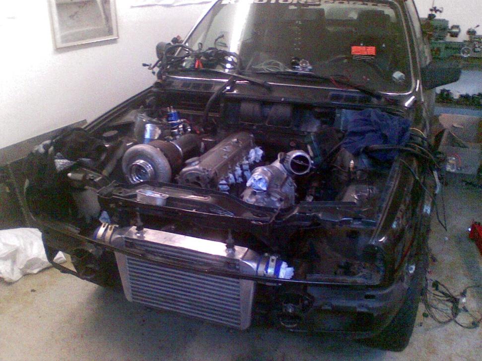

    quick specs of my engine:
    Wiseco forged pistons
    Diesel forged crank (2.7)
    "eagle" rods
    Dbilas cam
    Shimmed double springs
    Adjustable cam pulley
    LS2 truck coils x6
    Haltech E8
    630cc injectors
    Race bearings
    Athena cooper ring head gasket (separate stainless fire ring)
    12.9 head bolts/ARP rod bolts
    double walbro 255lph pumps
    I will answer more quostions on my own btcf thread so we don't get carried away here away from the original subject that is about your build.
    Thanks my friend... very very happy to see I am not alone in the M20 twincharged world, Love your built. Your engine built is a lot more serious than mine. Mine is a stock 2.5 with new gaskets and ARP studs thats why I'm limiting this beast to 17-18 PSI max until I build my spare 2.7L but I also have my winter project coming a 1990 red vert which will have a M30 (E34) M90 supercharger and who knows maybe a little turbo since I got the experience already.
    My twincharged setup is Turbo feeds the Supercharger (10 from SC and 8 from Turbo ) which gives me over 23PSI which is too much. Car drives wonderfully and cant wait to tune WOT once I install my BLV (boost limiting valve from 928 motorsport) be carefull when you first drive your Twincharged Vert word of warning boost comes in very very quick and @ very low RPM if your not careful with the throttle...my first drive I came back shaking as I almost hit the curb at full force..
    Basically its just the way I like it...brutal low end torque and tons of power overall. Keep me posted my friend your car is going to be rediculous how much boost are you planning?
    ** oh and I really dont mind you posting on my thread its all about twincharging so its all good and members here appreciated am sure

    Originally posted by slappala View Post
    The Finnish build can be found here (325i cabriolet, now 2.7L+M90+HX55):
    Can't see without logging on to the website...
    Leave a comment:
  • slappala
    replied
    Nice build!
    Advance table looks quite safe/ok
    Only Finnish sorry :)
    Some pics before adding the turbo can be found from www.1k.fi gallery.
    I have Gates polycarbon cog belt setup (36mm) for the eaton drive.
    I think I have a little different setup on boost piping. Have to go thru your thread.
    I will try to post a pic of the engine room when I have more time.
    "eagle" rods
    Dbilas cam
    LS2 truck coils x6
    Haltech E8
    630cc injectors
    Race bearings
    I will answer more quostions on my own btcf thread(free forum,but needs registration) so we don't get carried away here away from the original subject that is about your build.
    Edit: one pic from 2011 when making expansion tank, radiator and ABS-mounts etc. (A lot has been done since, must take some pics). Since then engine room has been painted and engine is back in. Final touches anymore to be done.(Painting valve cover, couple boost pipes etc.)
