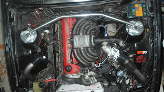

    back at work :) removed the headers.....
    Test fitting the turbo manifold... problem right now is my oil filter cooler is deleted and now my small filter hits the bottom of the manifold. So anybody have a donor filter cooler adapter?
    Out with the headers they served very well still look brand new they are now for sale!

    today I finished all the piping for SC side and started the car I wanted to compare with the AIR TEMP on idle before and with new Big intercooler. Well am not surprised to see that my new cooler max at idle is 11 degree compared to 38 degree before...I should of done this before but its ok as to twincharge I had to do the piping in taking consideration room for the turbo piping.
    Now on to the turbo side :)

    Received the rest of the piping...I'm almost done test fitting all the pipes :)
    The routing is all figured out, all fits well and hood closes very well.
    Turbo side piping is done and no problem I can keep my electric Power steering :)
    All thats missing is joining the pipe that goes from one end to another it will be right behind the intercooler I will weld some hooks to mount the 3" feet pipe..
    I'm having lots of fun building this...and at the same time I'm affraid how crazy powerful this car is going to be it was a beast with 10 PSI of supercharged boost now with 20PSI of supercharger and turbo together cant wait!!
    Stay tuned lots more coming....

    Piping is almost done for new intercooler...
    Ordered more tubing should be here soon. You can see the blow off valve that will make sure the turbo can release its boost.
    This front mount is 2.5 X times bigger then my small underhood one.
    This plus water meth injection should keep the twincharged boost heat at bay...
