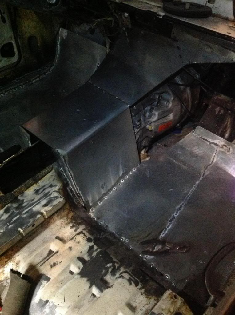

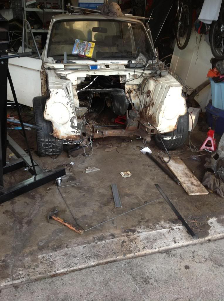

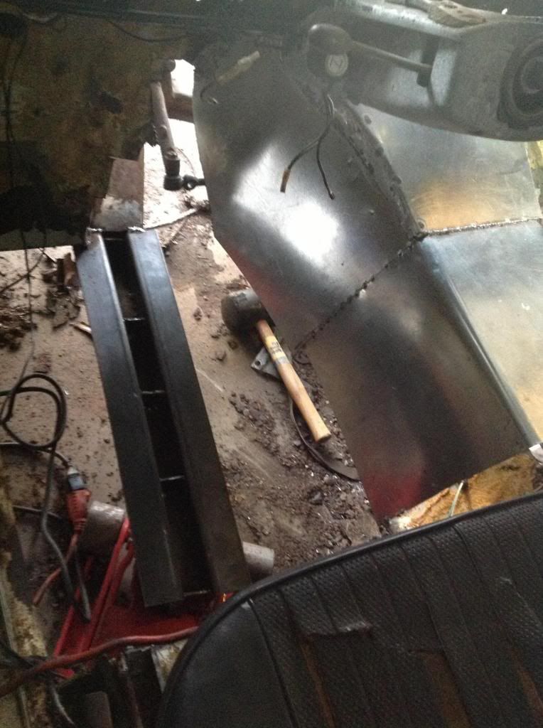

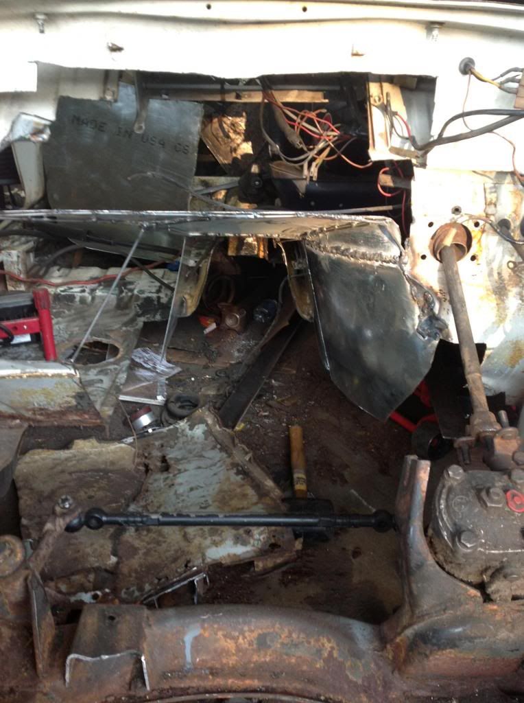

    driver side floorpan since the old is is bad and frame rail completely rusted

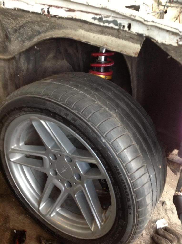

    coilovers installed

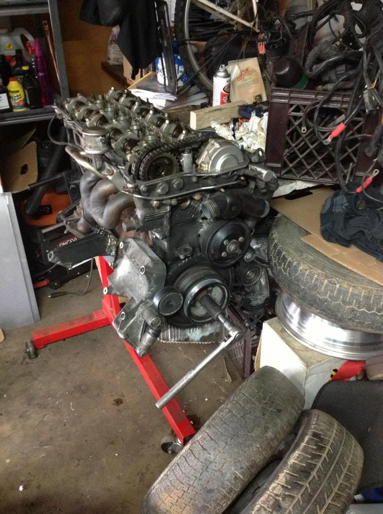

    took out the s52 today going to clean it up paint, re gasket it

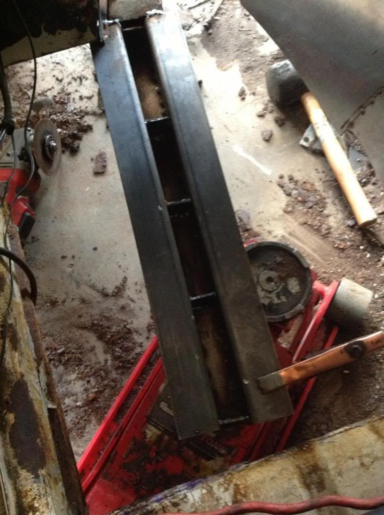

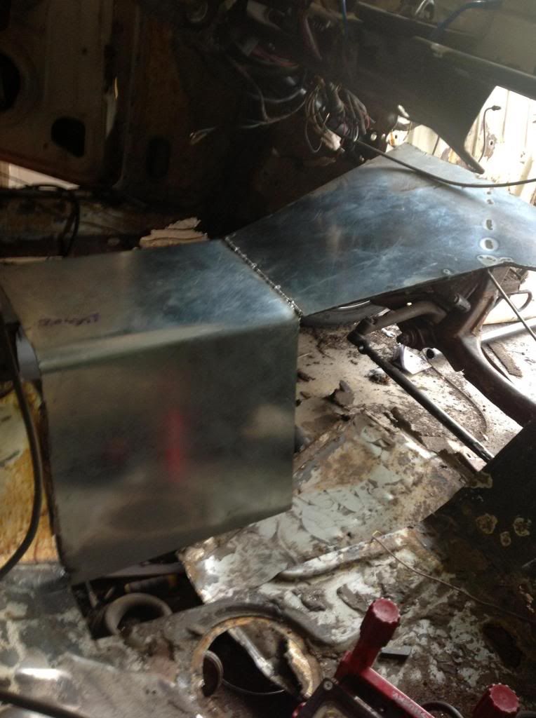

    fabed up a new floorpan
    driver side
    i am going to try to finish the driver side tomorrow and drop the front subframe for a complete refresh and clean the engine bay.
    Trust me it stock :yawn:
      #47

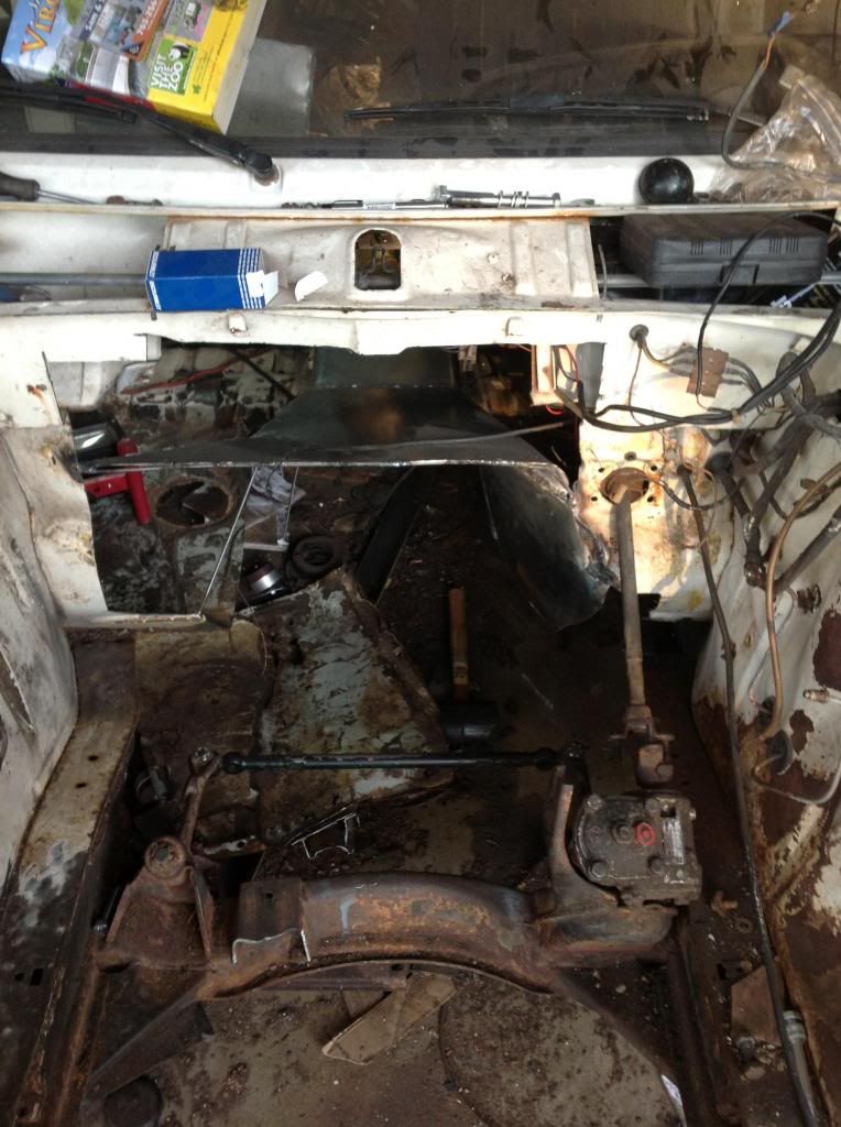

      finished the driver floor going to do the passenger the same way

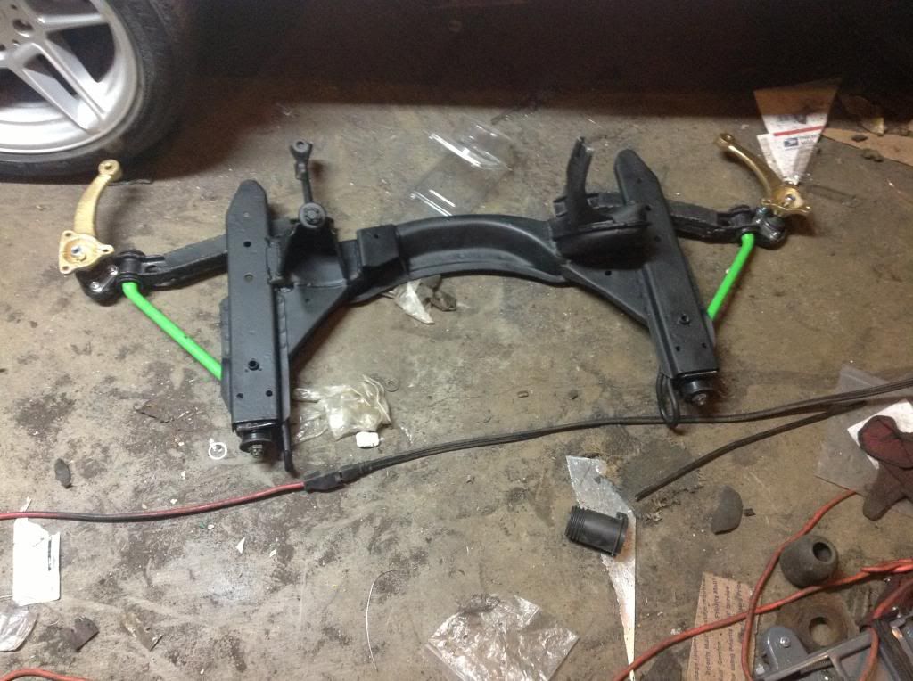

          boxed in control arms and seam welded
          refreshed the whole front sub frame
          i used ireland engineering poly bushings for everything on this car so far, thanks again Ireland engineering :D

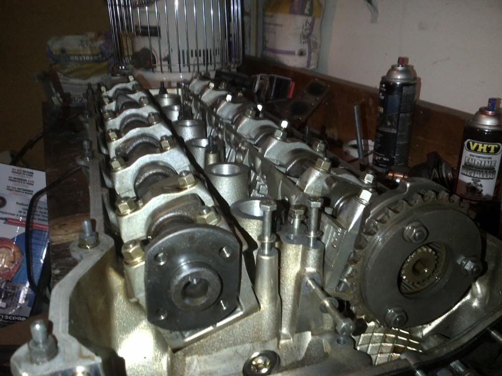

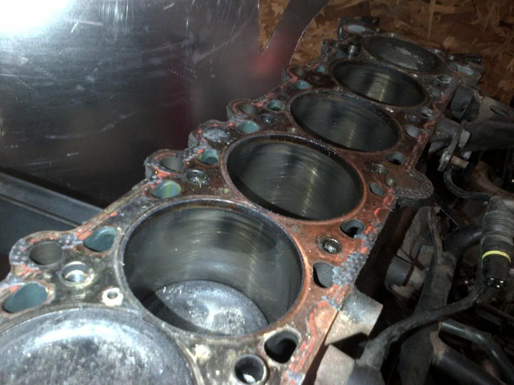

                  started working on the s52

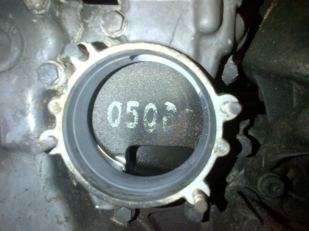

                  clean inside

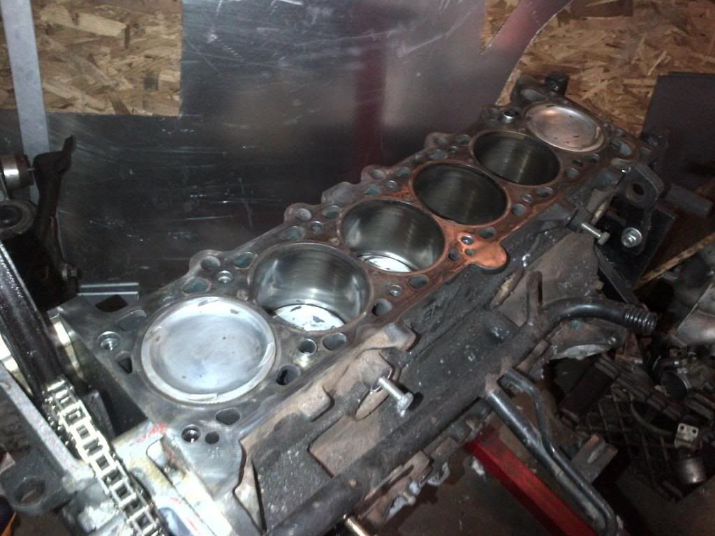

                  dirty pistons but clean bores

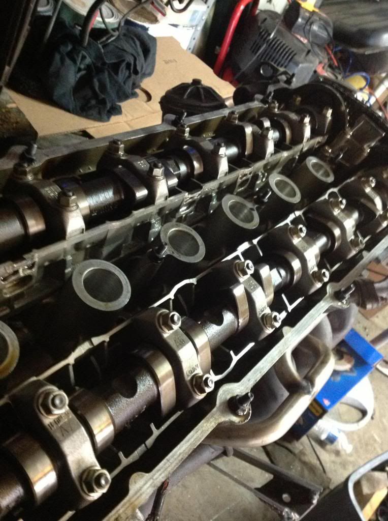

                  head is off
                  cleaned the pistons and the deck

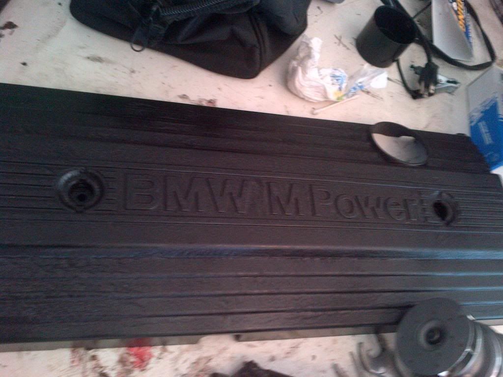

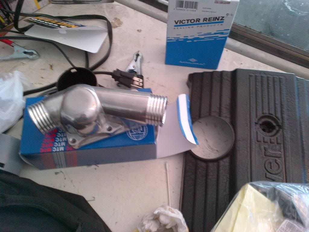

                  wrinkle engine cover

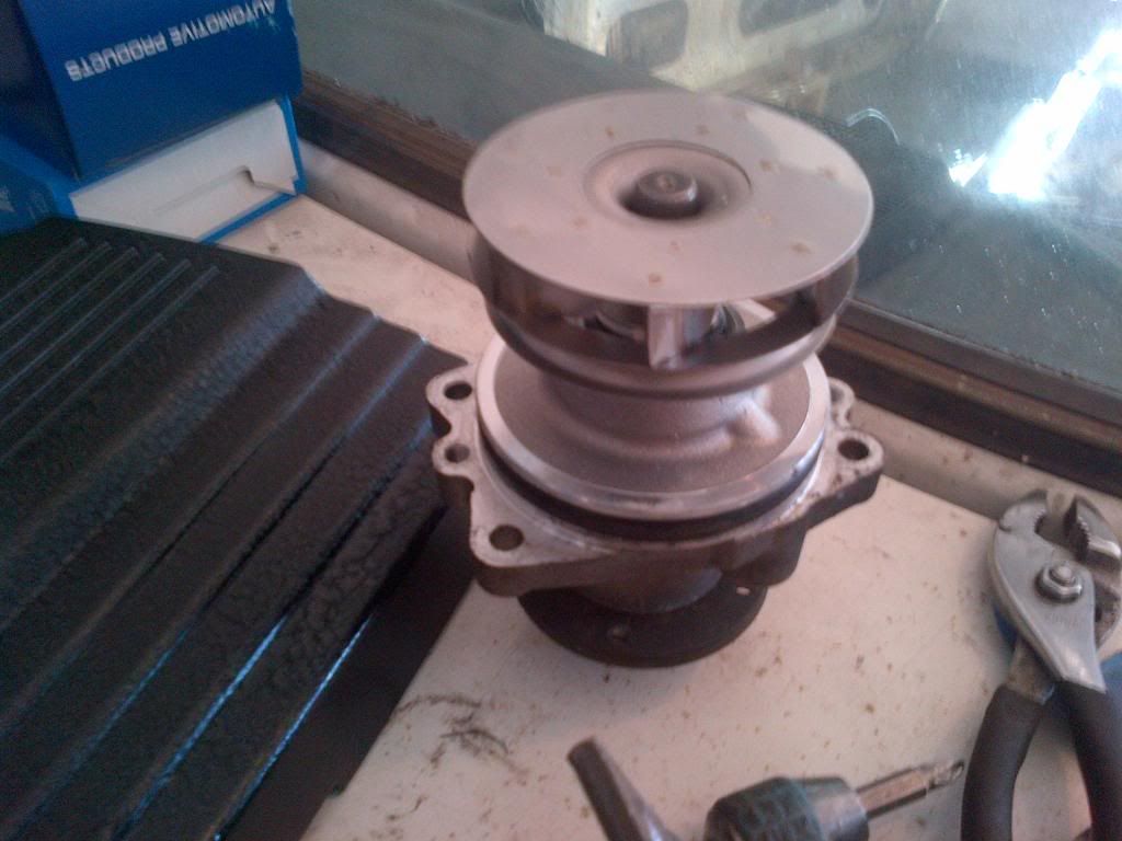

                  New water pump
                  new housing

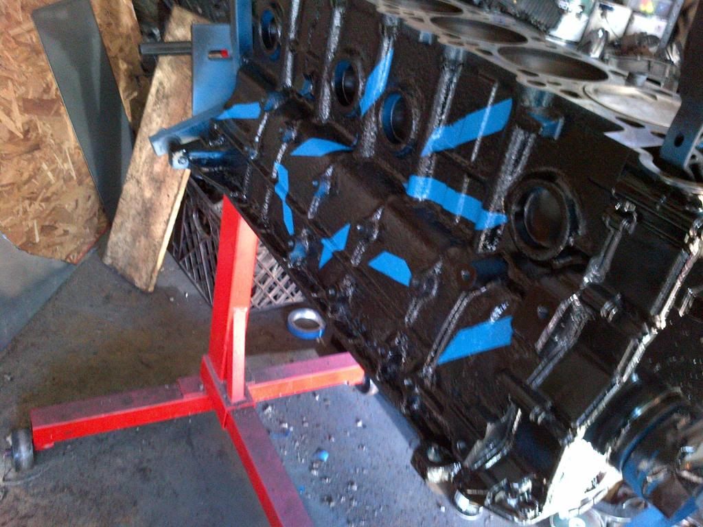

                  painted the block, came out okay :)

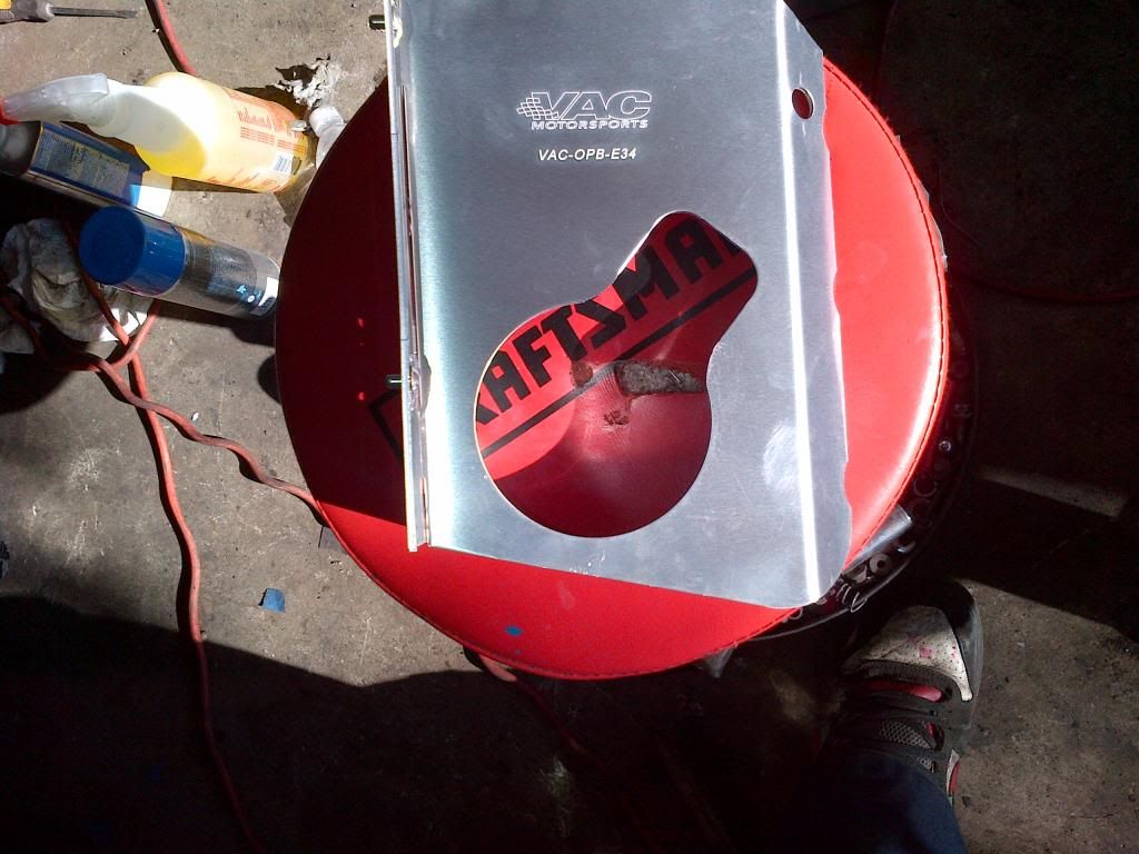

                  VAC Oil pan baffle for autox and track

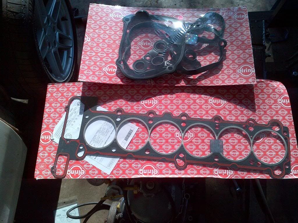

                  oem headgasket and other goodies

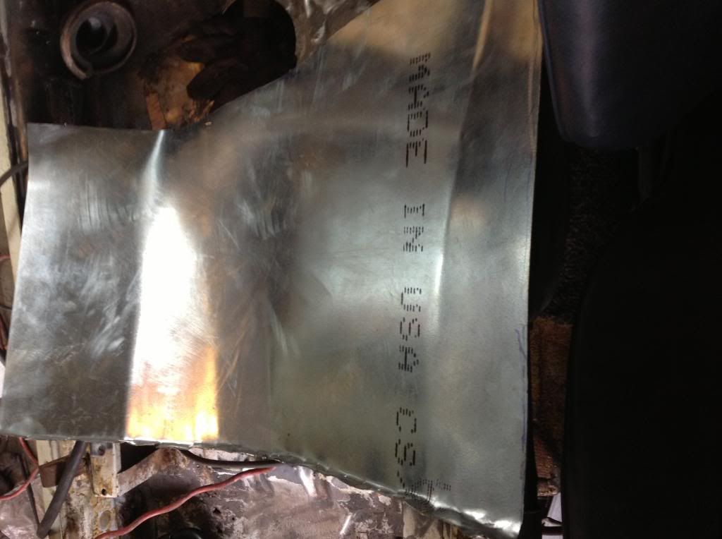

                      my awesome 16 guage galvinized hot dipped steel sheet metal for rust repair
                      You're holding your breath while you weld that galvanized steel right? haha

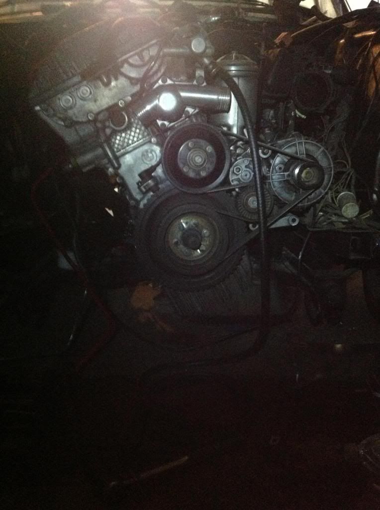

                            i already re-gasketed the s52, timing cover, headgasket ect whole nine with oem parts from bluntech.
                            after doing the engine i finished the engine bay by grinding it down and brushing on this special clear coat design to protect metal but give it that bare metal look. it looks great!

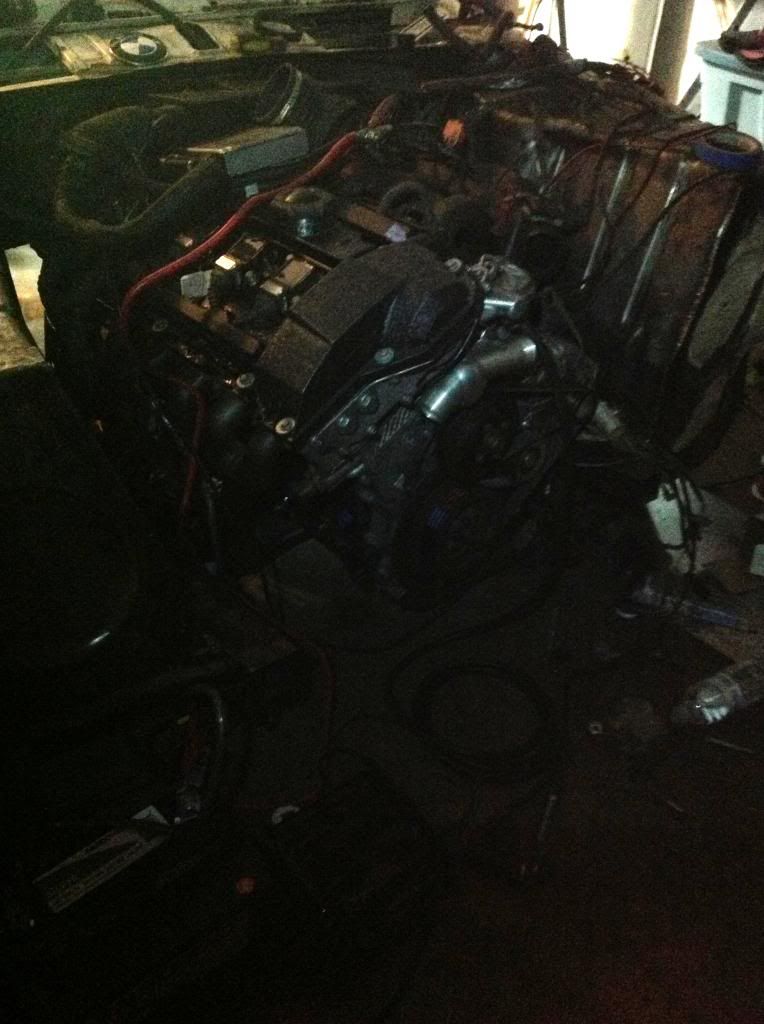

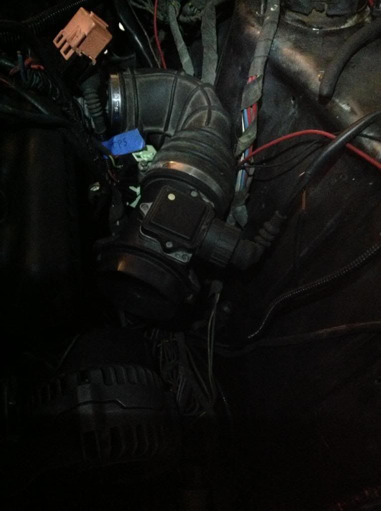

                            when the engine bay was done i decide to drop in the engine and try to start it. I got everything in and pluged up but only thing from keeping to start it is spark plugs and connecting the fuel pump up. other than that it cranks and i can hear the icv huming so that means its good soooo far.... lol i will find out soon :)

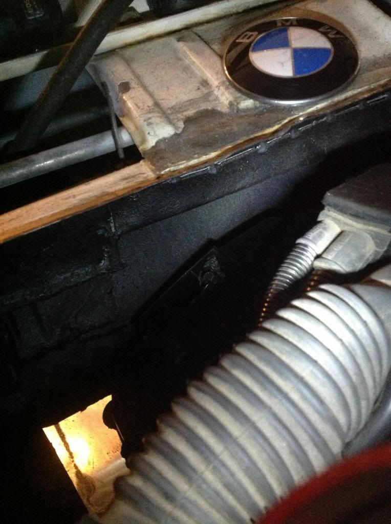

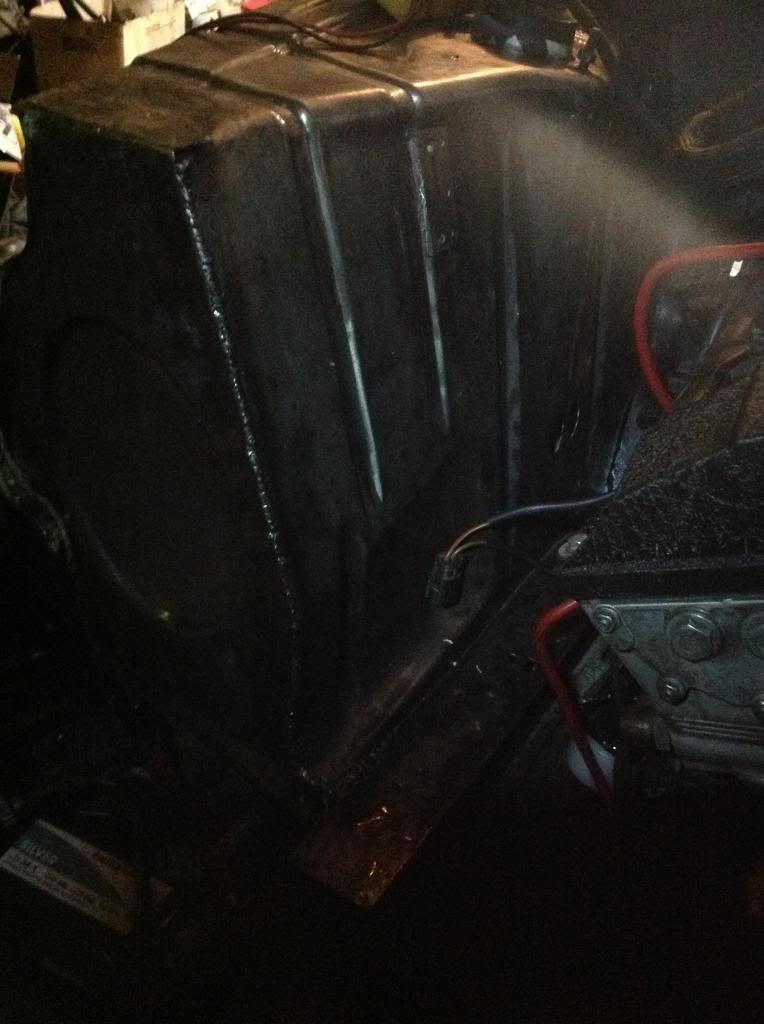

                            modified firewall

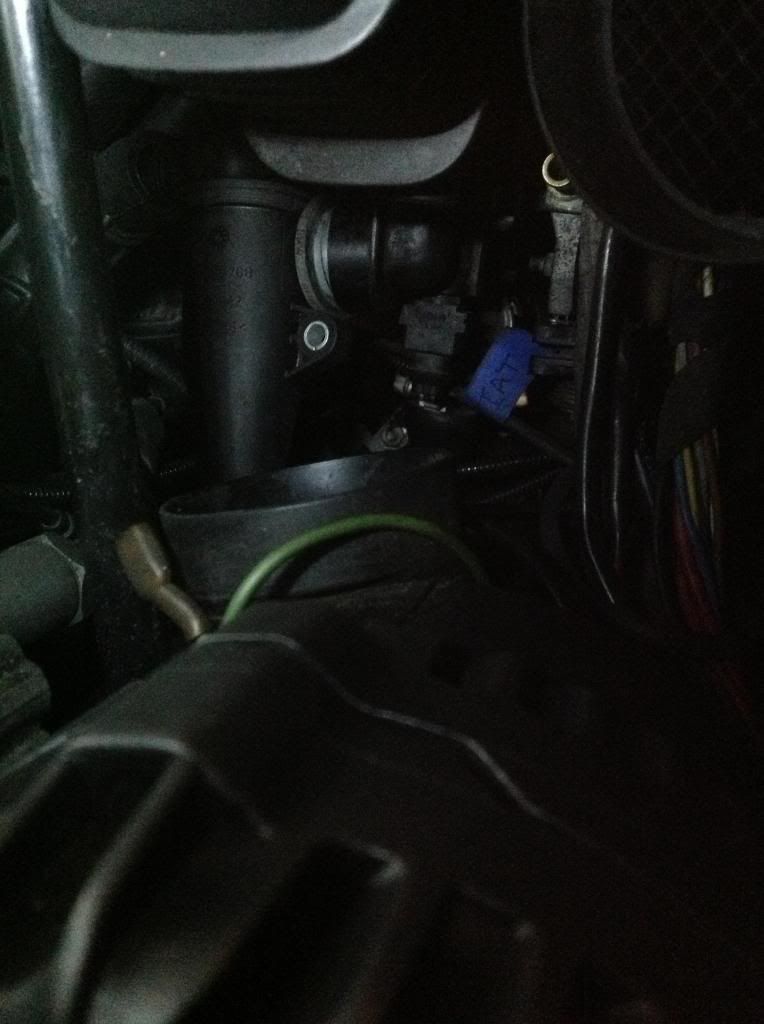

                            e39 m5 cyclone separator, supposedly a lot better than the stock separator

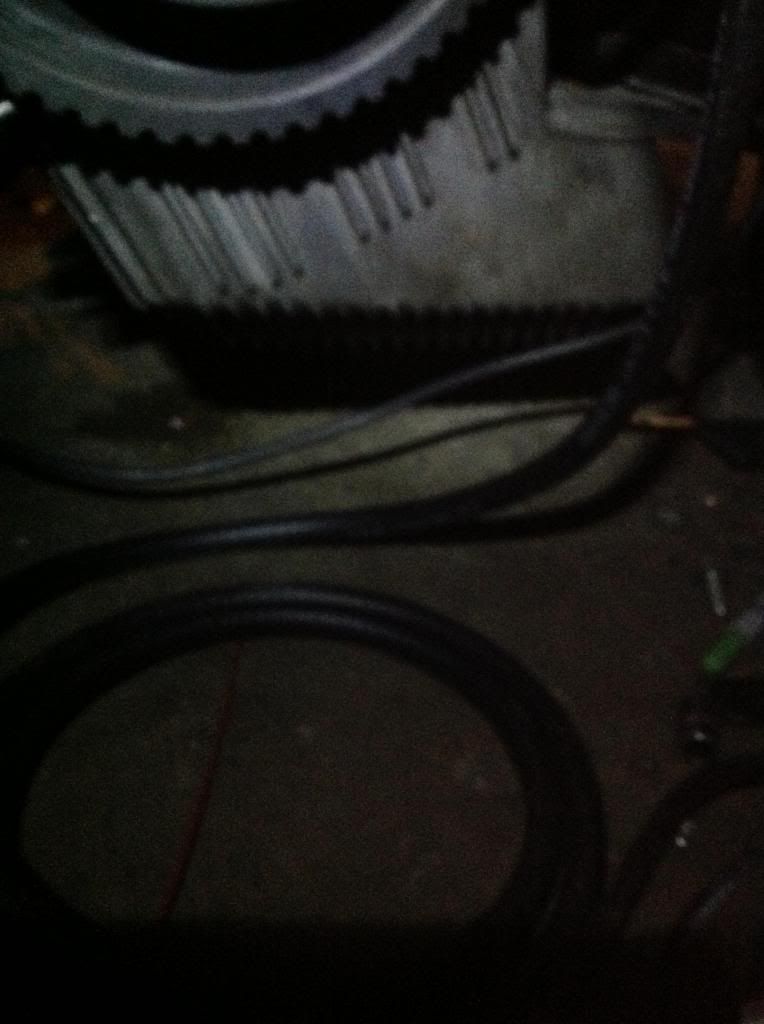

                            used mini cooper belt
                            inside
                            going to buy spark plugs and hook up the fuel lines and we shall see what happens :) cross fingers!!!! hahhhhah *screaming like a lil bitch*

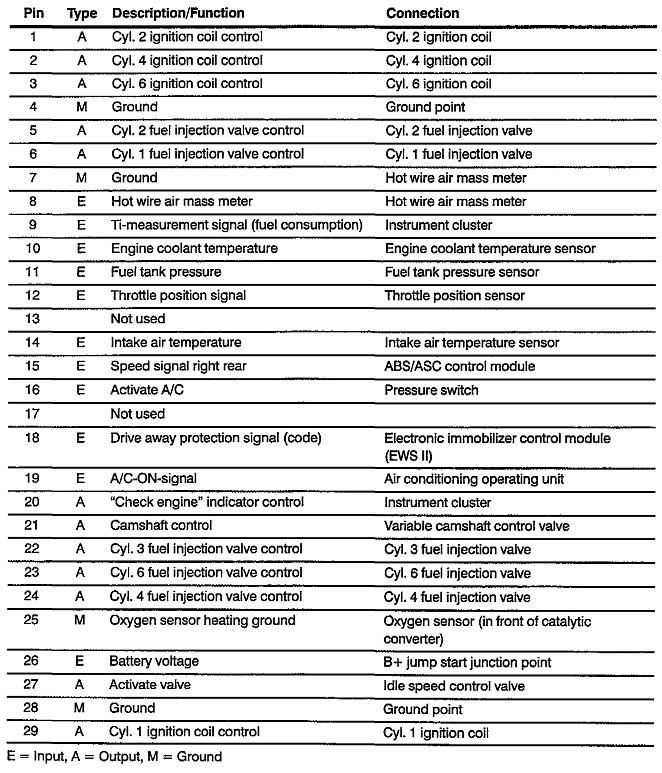

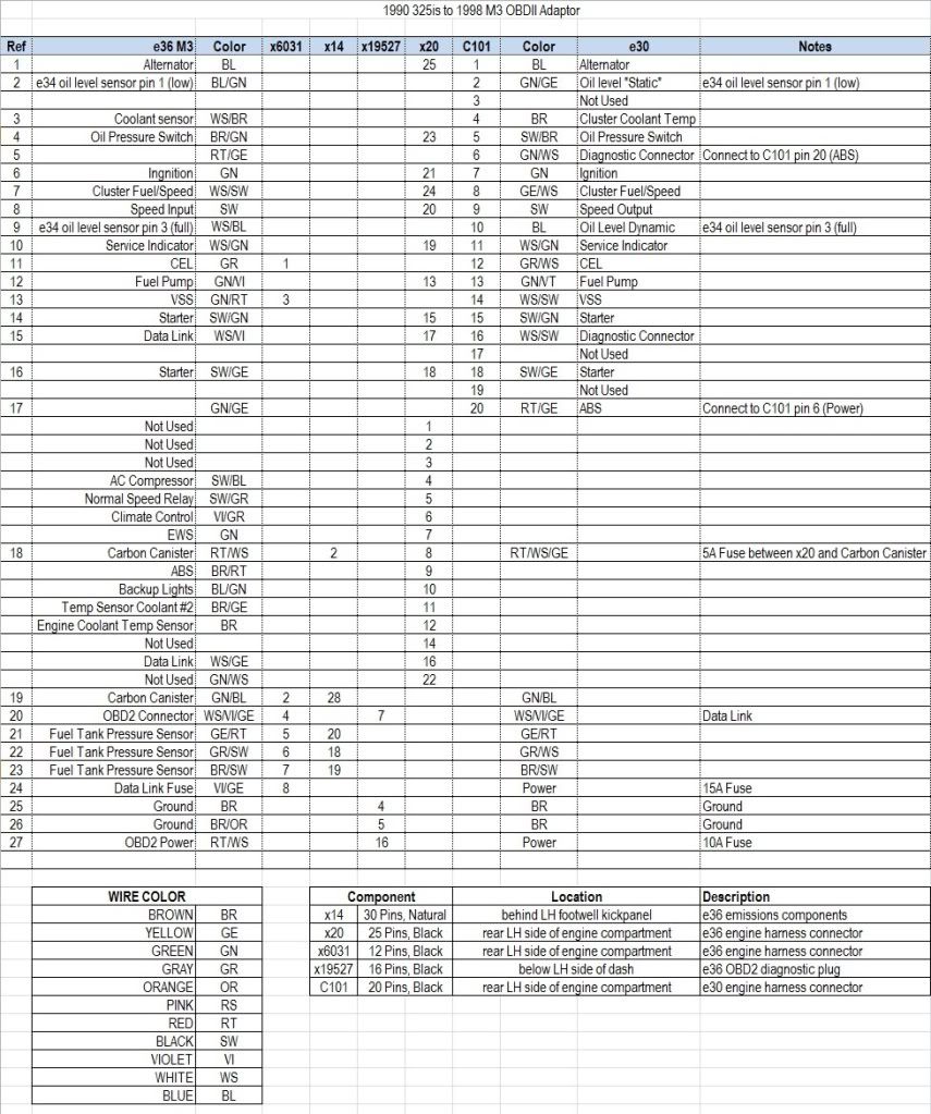

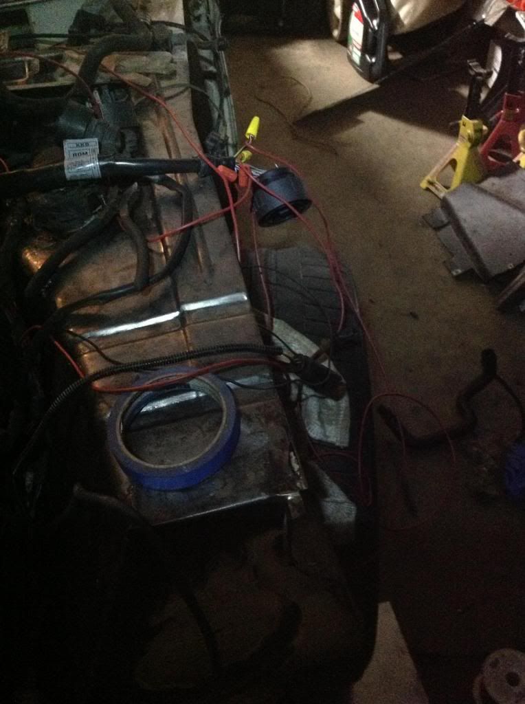

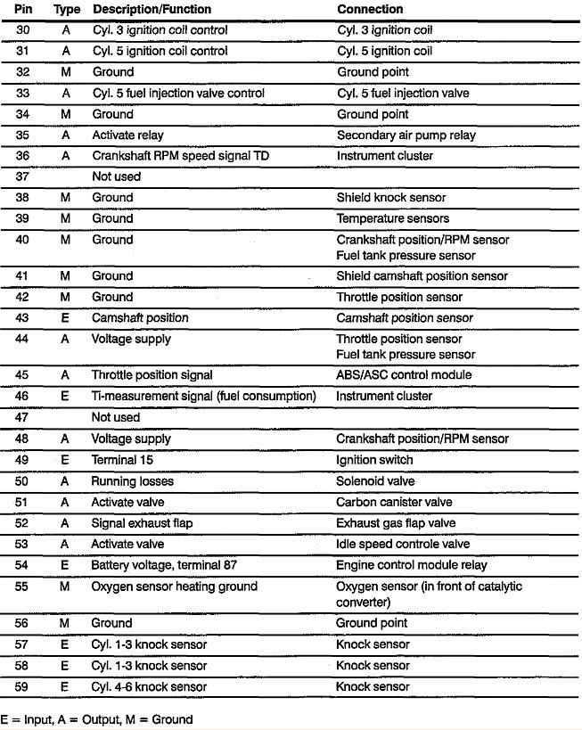

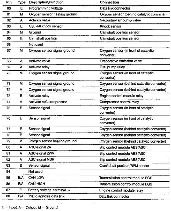

                            as far as plugging up the s52 ODB2 into a 2002
                            x20 bmw 2002 harness
                            alt 25 > blue wire that is in the voltage reg
                            ignition 21 > green wire inside the firewall or the green wire behind the ignition starter
                            starter 15 > ground
                            starter 18 > pin 50 behind the ignition starter
                            fuel pump 13 > direct to fuel pump i am using a 318is from a e30 with pick up
                            and it should work, with this done i have the icv hum and crank. i just need to plop in some spark plugs and give it gas and it should be on like bing bong jack!
                            hopefully people can take advantage of odb2 and not convert to odb1 which is stupid, only gain you get is odb 1 intake manifold other wise a down grade
                            these are what i used for hooking the s52 up
                            odb2 x20
                            ms41.1 dme pin out
                            the rest is easy and hooking up gauges to the x20 or whatever your using
                            i am using a ms41.1 ecu odb2 from DesertBMW ews delete, tune rear o2 delete and much more
                              offcourse!! :D

                                i got it started guys!!!! loud as crap!!!!! im so siked to get this on the road and drive!!! i will provide video later!
