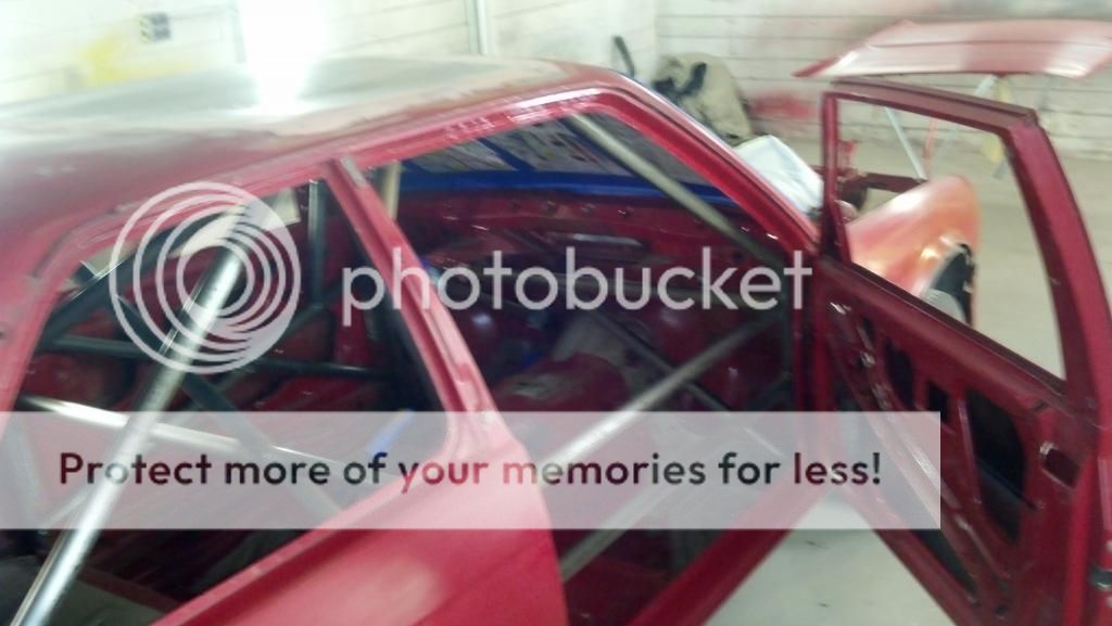

                            lol, been a while. heres an update though
                            more pics after paint
