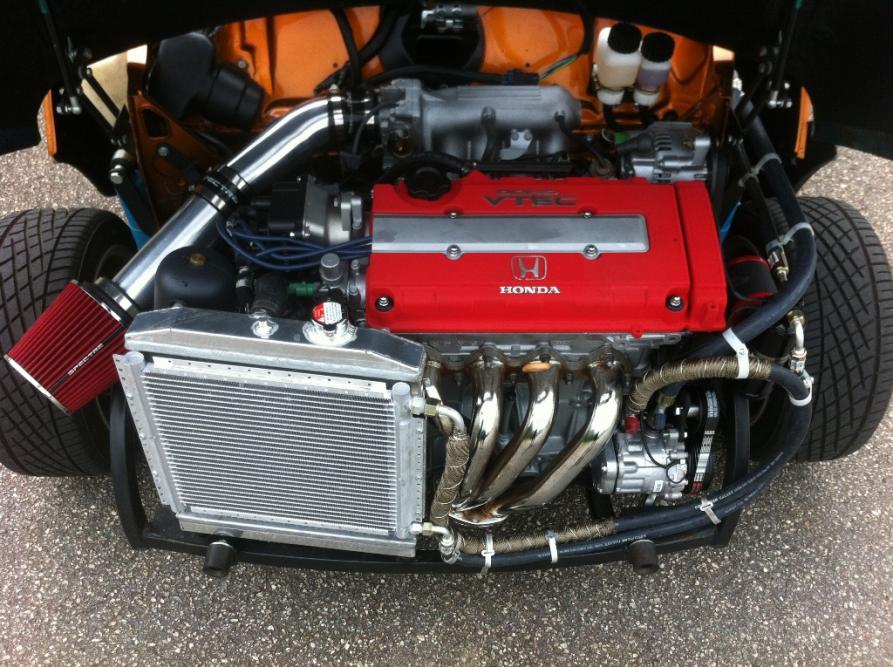

            • ZM Blue Devil
              • Dec 2006
              • 13836
              in the for the madness, these are fun little cars.
              a local buddy just did this. Its a handful.
              Levent
              %20levent@gutenparts.com
              Ladies:
              • 325ix
                • Aug 2009
                • 7783
                ^That looks like so much fun! I bet the torque steer can be a handful.
                • MT325is
                  • May 2012
                  • 1103
                  B16A!!!!!!!!! awh i love that engine.. thats in a mini im assuming! so nice! and i wonder just the speed of that thing! wow! meaning accelerating. But any news on your work OP?
