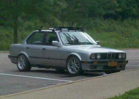

    Got this car for 700.00 two years ago, It was an Automatic with a blown engine and no options I can think of besides high end sound.. I needed a new body after destroying my red 89 two door.. So I swapped over the 5 speed, running m20, exhaust, 5 lug swap, ground control coil overs, etc...
    Now Ive found an S50 and Im working on getting that in there.

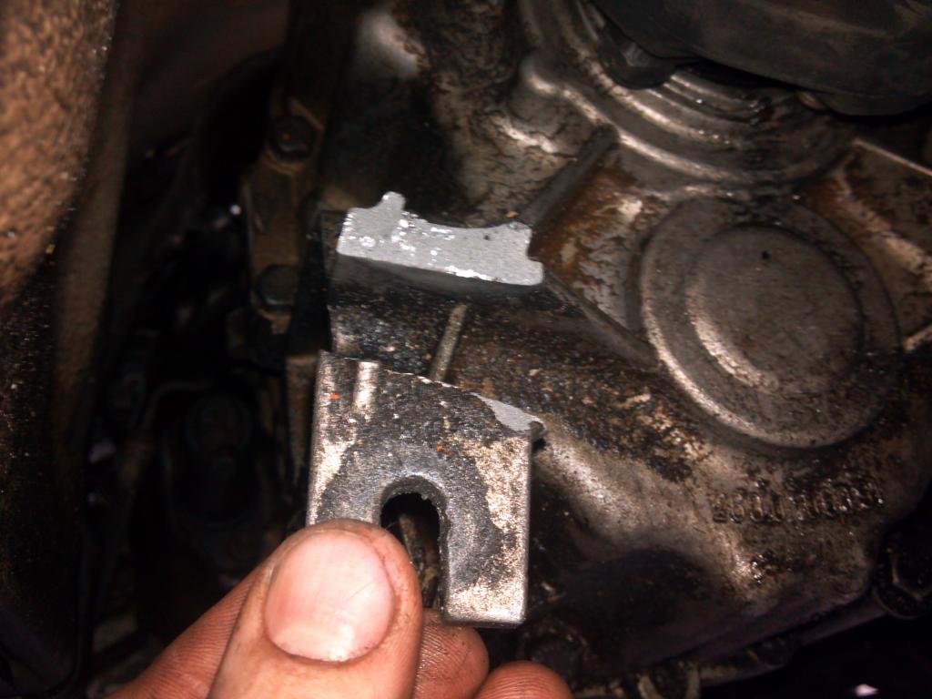

    After starting to remove the motor I found my subframe on the passenger side was sheared off at the welds, and because of the mounts Im using, It broke the ear off of the G260..

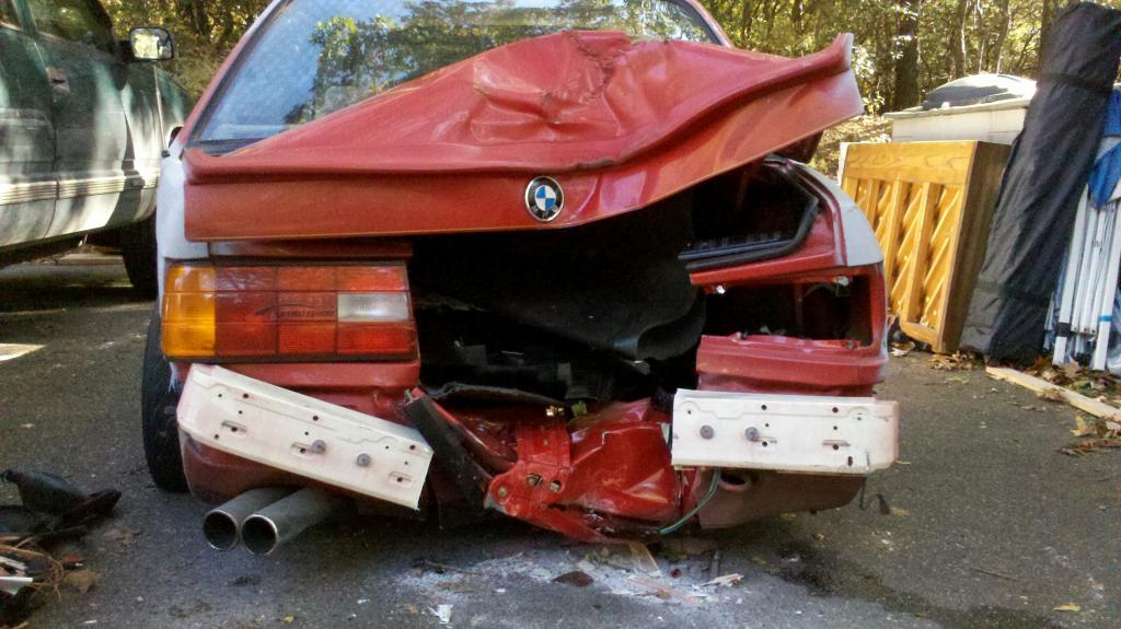

                    What did you do to that red one, ouch.
                    • bimmer630
                      • 1228
                      Spun out ..hit a tree backwards
