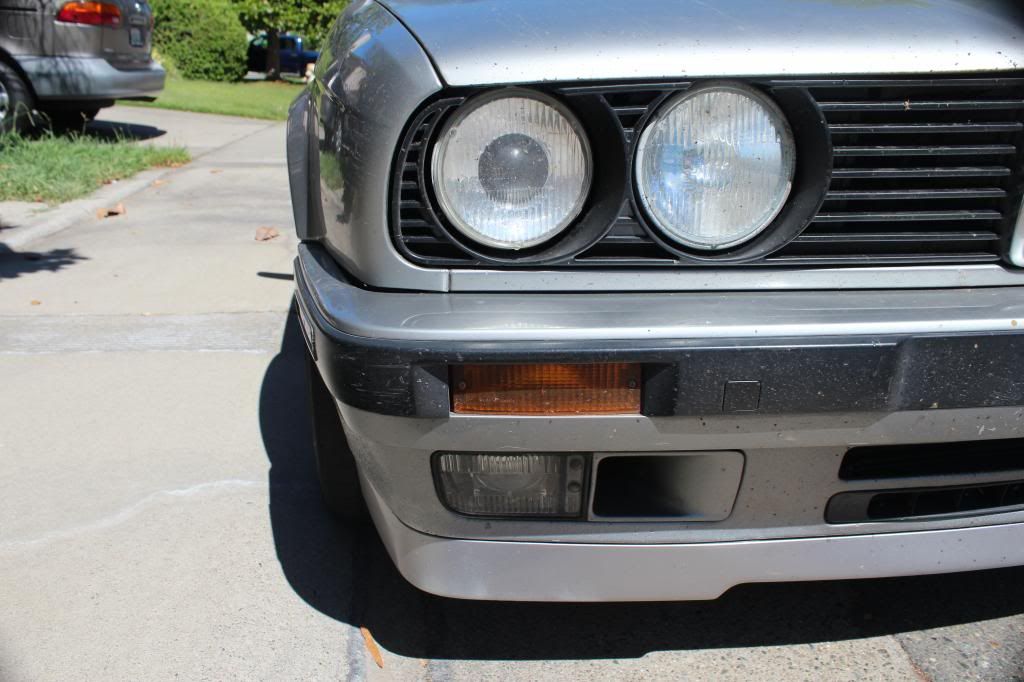

            And so it begins...
            Non destroyed rear bumper trim! (FINALLY!)
            New fogs!
            AND...!

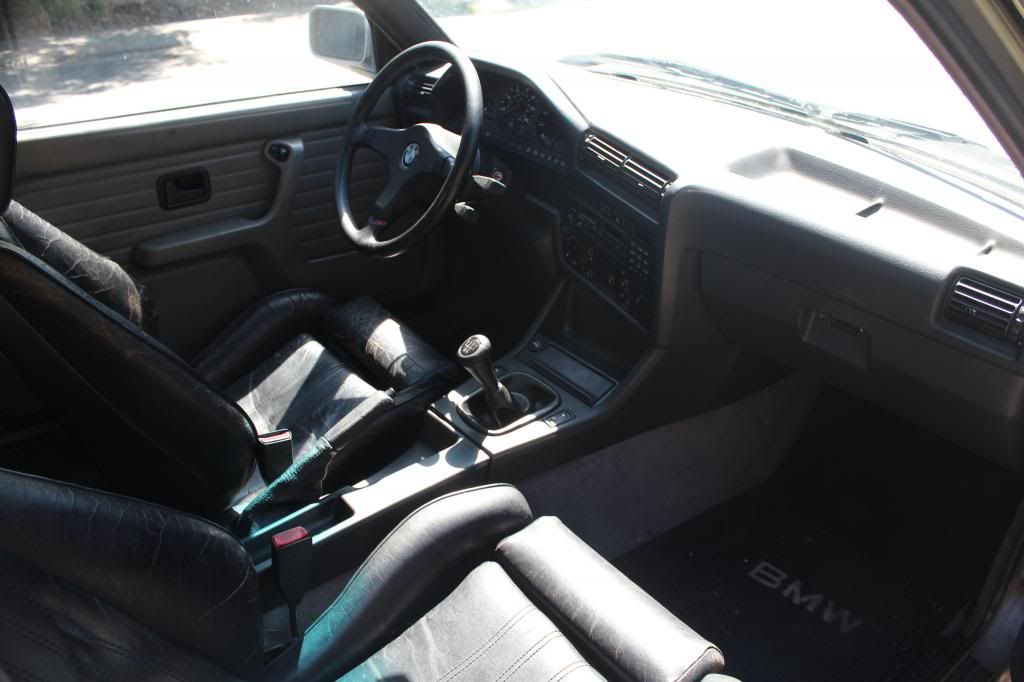

            5-Speed Swap!
            Thanks again to my good friend Dustin (rede30) of Redlands CA for the huge hookup. Wouldn't have been possible without him! Just dropped a good chunk of change for some refurbishing parts as well
            Specs:
            135k Miles
            1987 325e Getrag 260 (Late model Getrag)
            Red Label (ATF if is!)
            3.73 LSD
            So, current budget is at around...
            $500 for full swap (Including Flywheel, 3.73 LSD, and low milage clutch kit)
            -$250 for 4.10 LSD that will be sold after
            $98 to Blunttech for misc. flywheel/clutch Bolts and Z3 Short Shifter
            $25 to Topgaiters for Shift Boot
            $39 to Pelican Parts for misc. Shifter Components
            $16.09 to Garagistic for their Derlin shift carrier bushings
            $misc.95 to (insert popular autostore/hardware store here) for fluids and/or last minute bolts, etc.
            ________________
            Which puts me around $430 at the very moment. expecting it to go higher, but not over $500 for this swap for sure. Valvoline ATF and some Redline for the LSD shouldn't be more than $50, and $10 should cover miscellaneous bolts here and there that I know I'll need.
            The 4.10 LSD is going for sale straight after the swap as well, so if you're looking for one and have the patience/need to save up cash, hold tight!

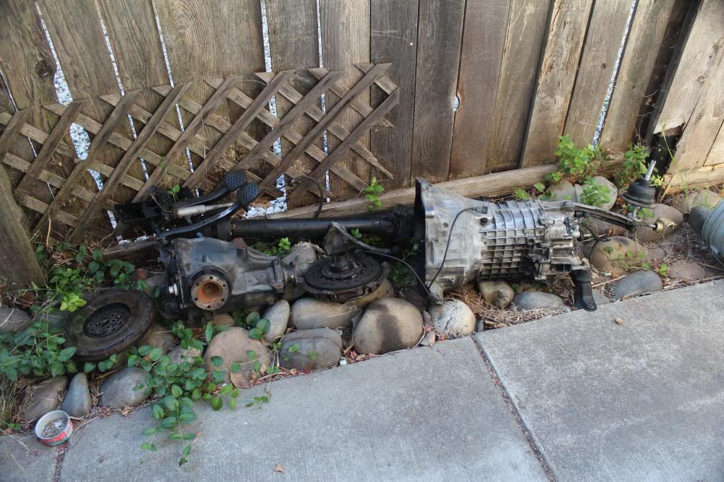

                    Spent all of 3 hours today and all day yesterday running around the yards and house doing stuff for the swap/e30.
                    My transmission didn't have an output flange, but luckily a friend and I went uarding together and found a 5-speed with a flange that was ripe or the picking. We had to grind down a 30mm deep socket to fit in the tight clearances for the output lock nut, and on top of that, jam a huge beam into the pistons of the engine to stop the crank/tranny from moving so that I could put enough torque down to break the nut loose
                    20 minutes of WD-40 soak and 15 minutes of using my leg on a breaker bar; success
                    Spent 3 hours today cleaning the disgustingly dirty tranny. Aswell as replacing my output seal and slipping on the output flange and torquing down to 25 ft/m. Got most of the crud off, and put all my parts together (Garagistic pushing a, z3 shift kit, random bolts and nuts).
                    Redline 75w90 came in the mail for my 3.73 and Valvoline Dexron III ATF for the tranny (it has a red label).

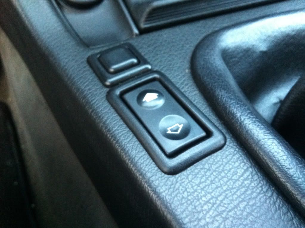

                    Also wired up some e36 switches the other night
                    Tomorrow I will be modding an early console to fit the e36 switches; still debating if I want to do this again, or delete the window breaker (wiring the wires together permenantly) completely.

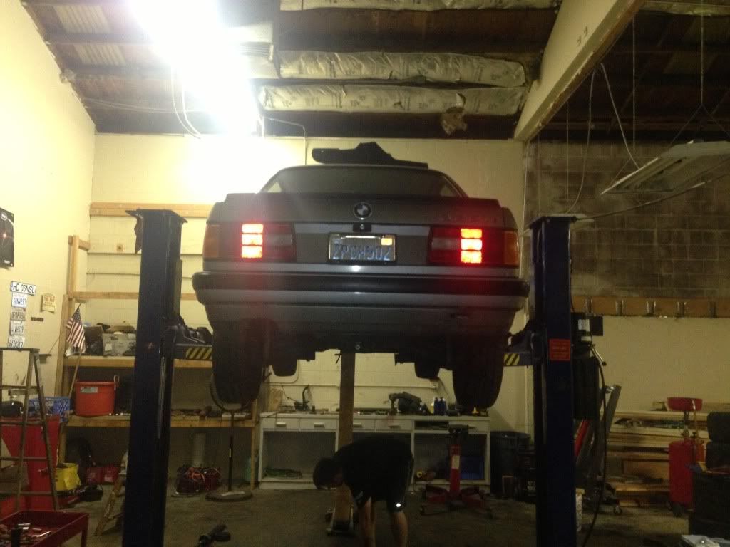

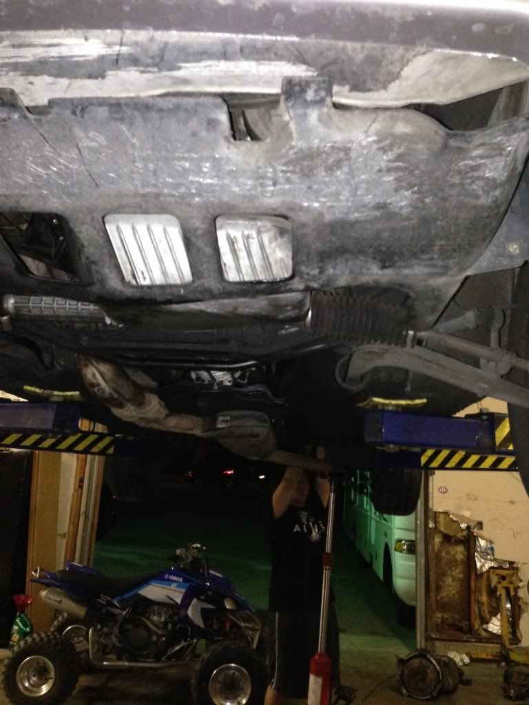

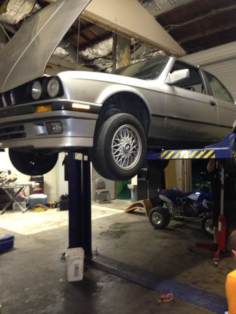

                                5 speed swap pic dump
                                (Sorry about the pics, they're not mine!)

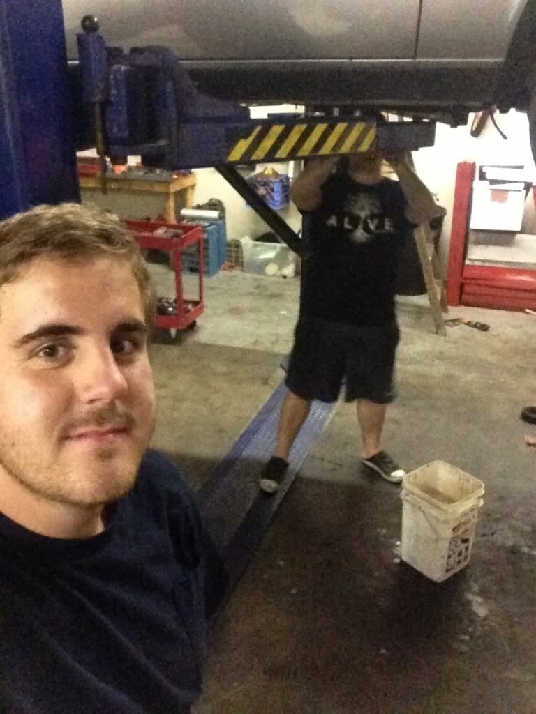

                                Getting her up and ready; at this point, just finished the diff swap to the 3.73 and was starting on the driveline
                                Old tranny coming off, bucket for excess ATF spillage, 6+ year old velcro Vans, awkwardly staring into the camera pictures of someone who is not me a-go
                                (I'm homeboy under the car)
                                Getting the exhaust off (OP welded the catback to the fore-pipe, so I had to take it off and pit it back on as a whole unit! UGH!)
