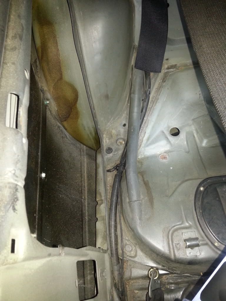

              Here are some pics of the rear subframe stud from the inside of the car. You have to pull out your rear seat. They are the black round thing. Here is a quick 'how-to'.
              First support the rear subframe with your jack.
              Remove the 2 allen key bolts from the side of the bracket.
              Remove the nut from the subframe stud.
              Re-install nut onto stud (only a few turns)
              Hit the nut with a hammer to push the stud up into the car.

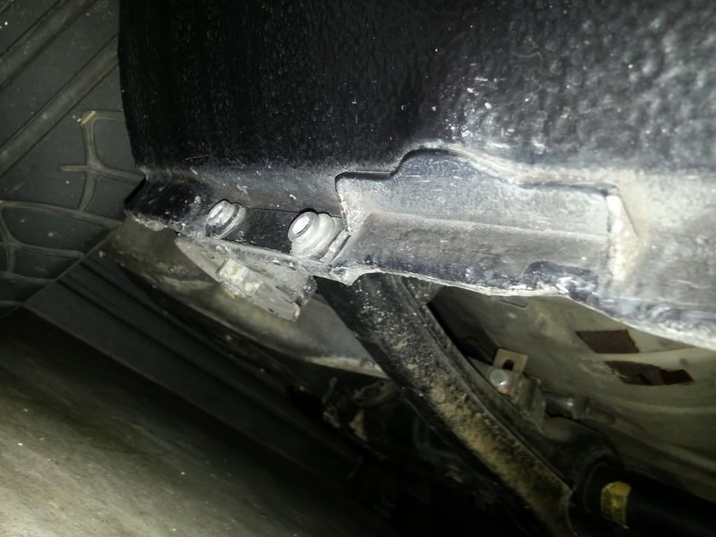

              Also put your jack stands in front of the subframe bracket. I have done this heaps of times with no problem.
              Jack stand position. (to the right of the allen key bolts)
