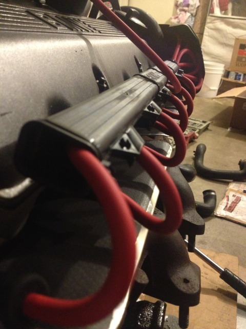

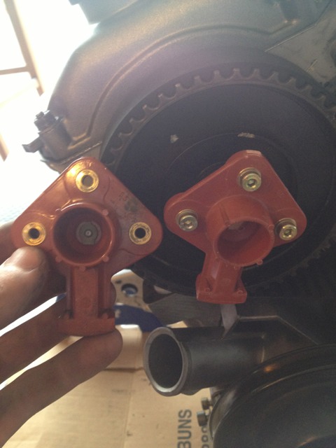

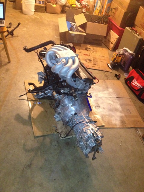

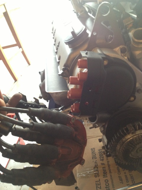

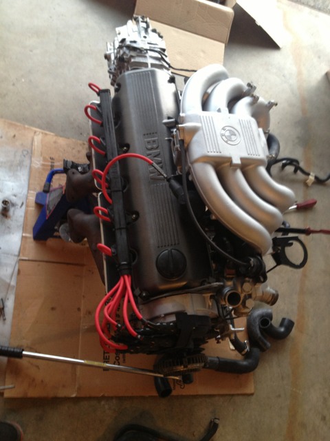

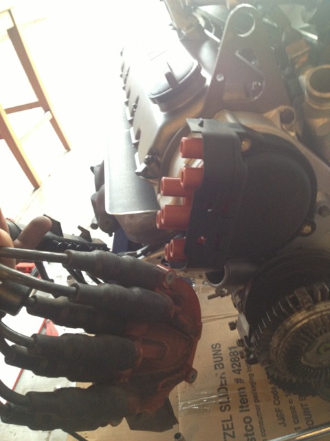

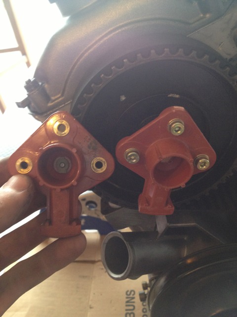

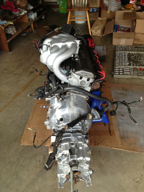

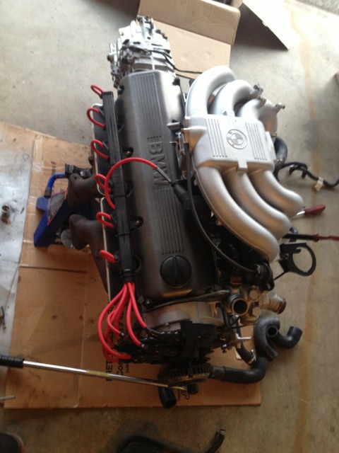

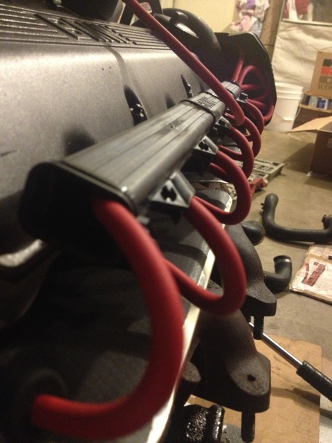

    New rotor and cap

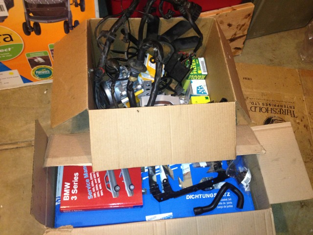

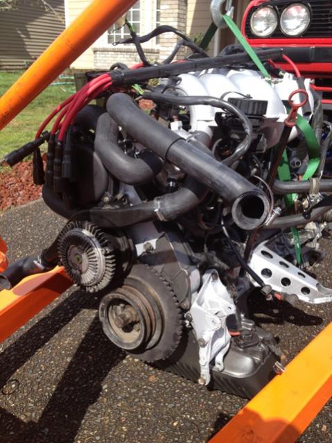

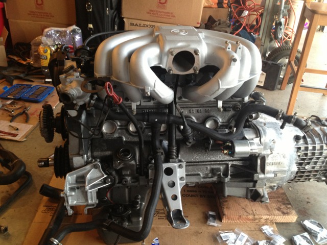

    Plugs are in:) bav auto.

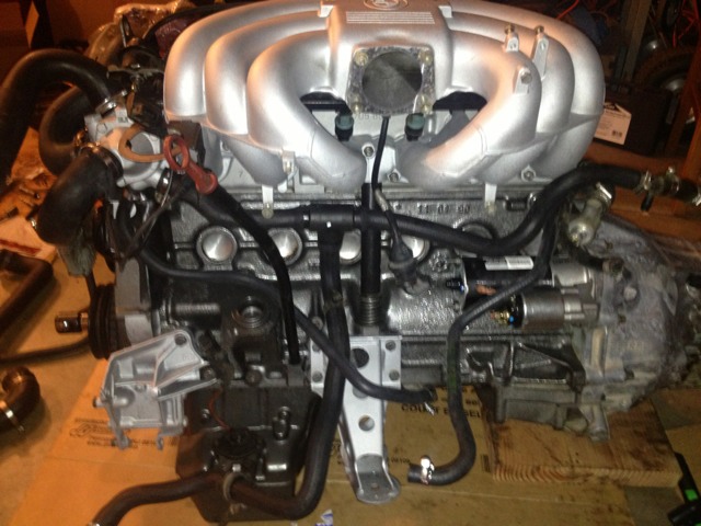

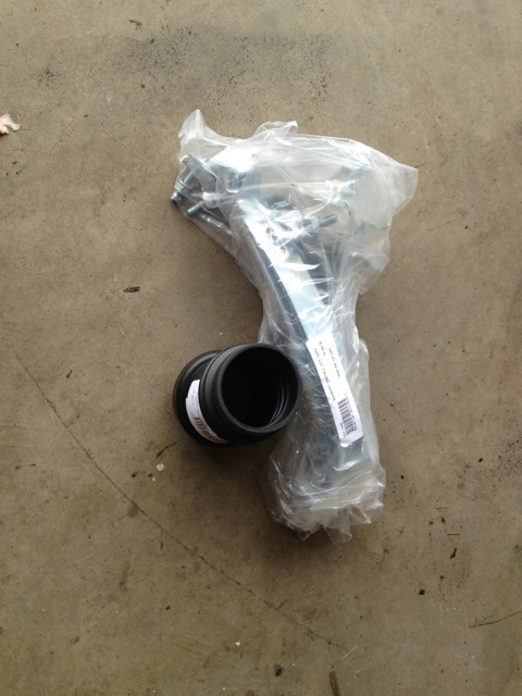

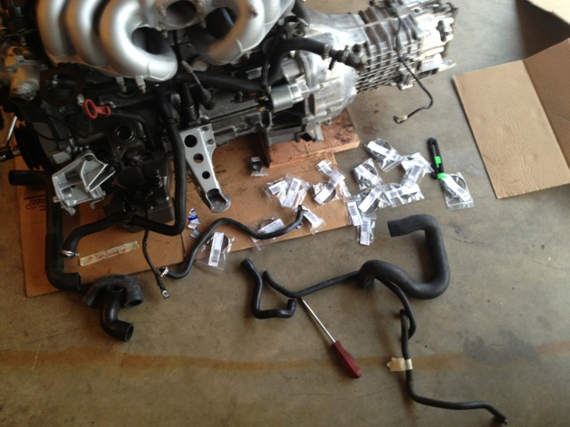

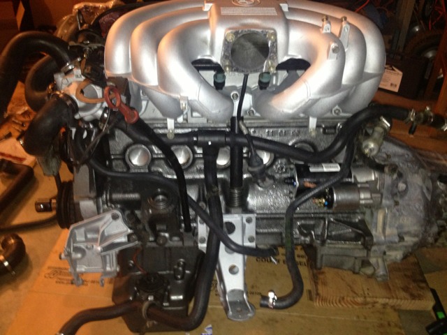

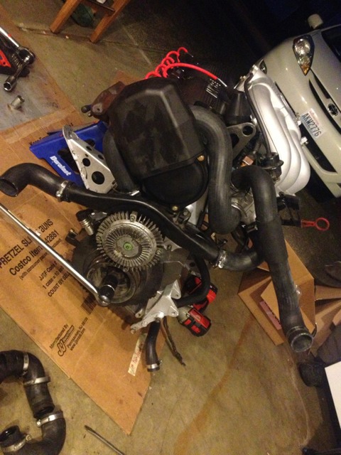

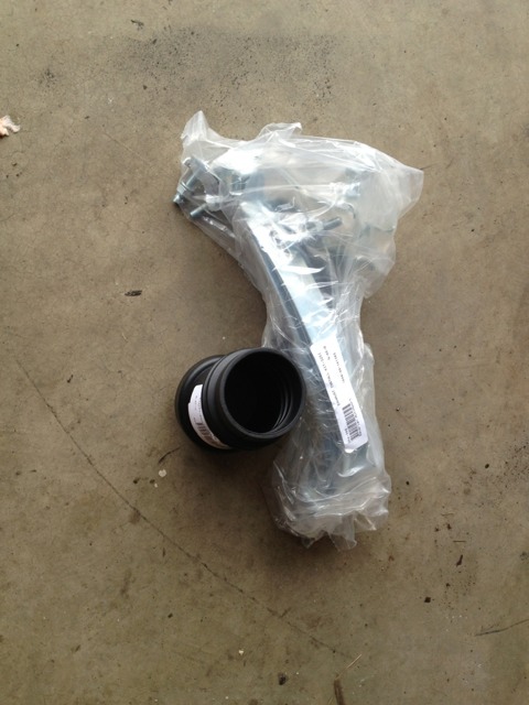

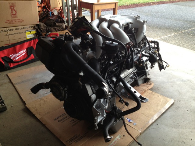

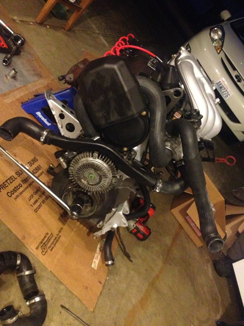

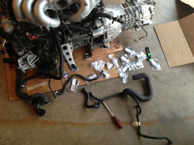

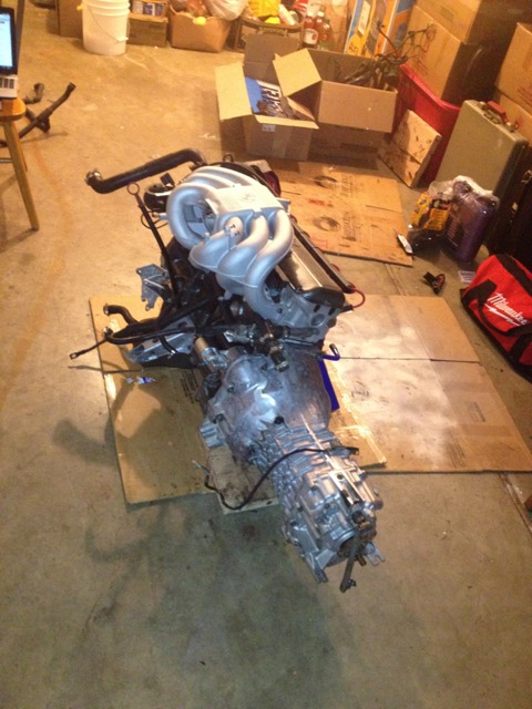

      New hoses.. That's was a little puzzle!
      Not much more left for tomorrow:)! Yes!

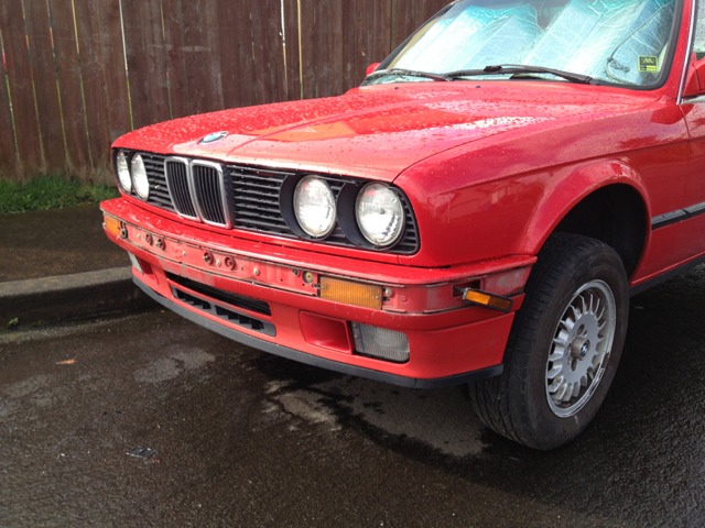

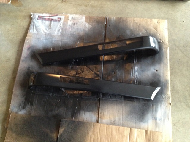

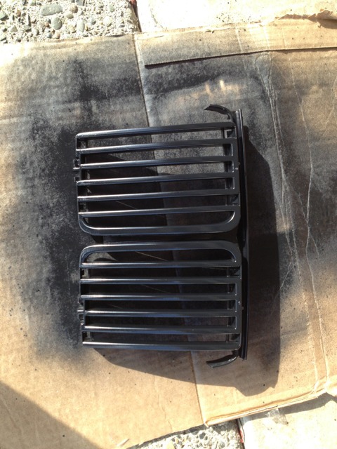

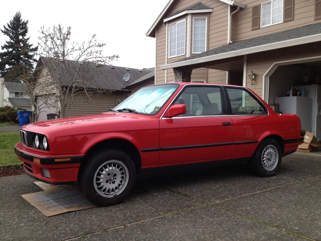

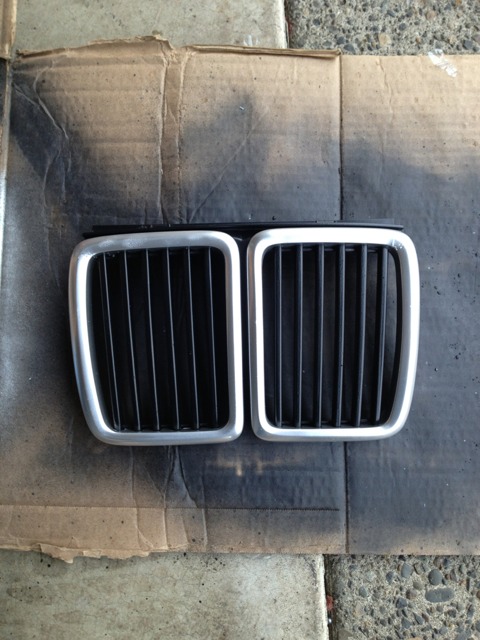

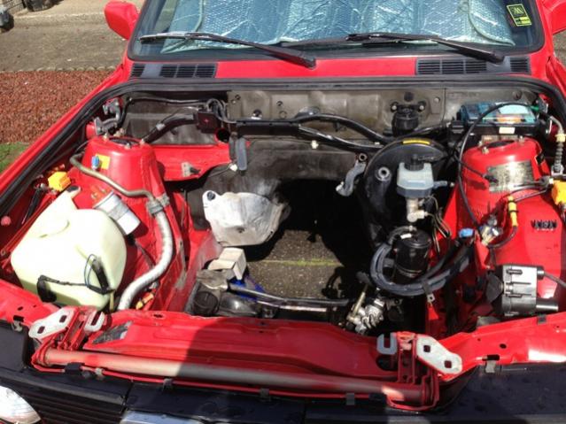

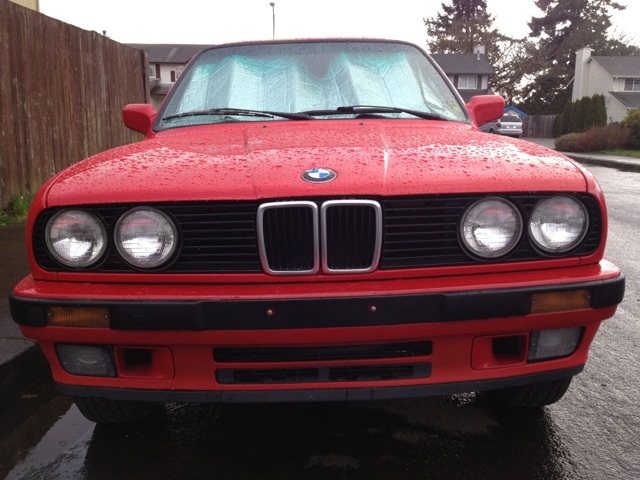

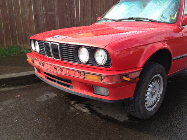

        Good day today!
        Someone once told me its the details that matter!!!

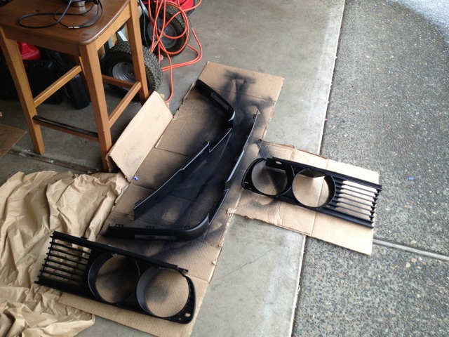

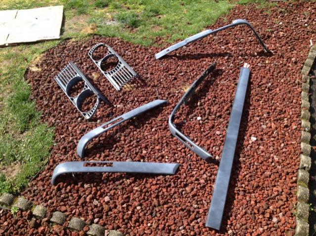

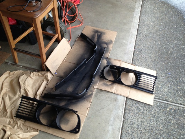

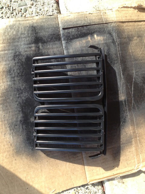

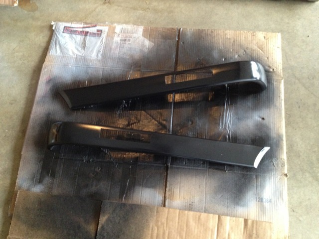

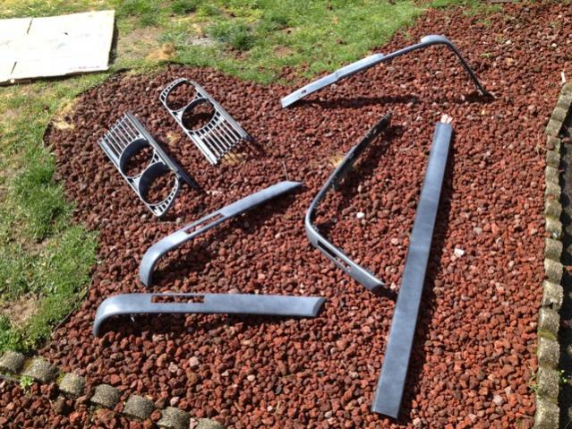

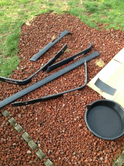

        So I looked into some details today. Painted the bumpers moldings and the grilles! Here are some pics!
        Getting ready to wet sand!
        Primered up!

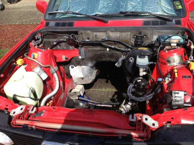

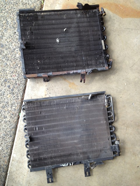

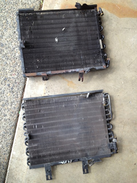

        Got the new condenser in so I installed that.
        1989 BMW 325is (SOLD)
        1992 BMW 325IC (SOLD)
        1991 BMW 318IS (STOLEN!)
        2017 BMW M2 (WEEKEND WARRIOR)
        1989 BMW 325IC (PROJECT(
        2002 FORD ESCAPE (DAILY)
        • MT325is
          • May 2012
          • 1103
          #34

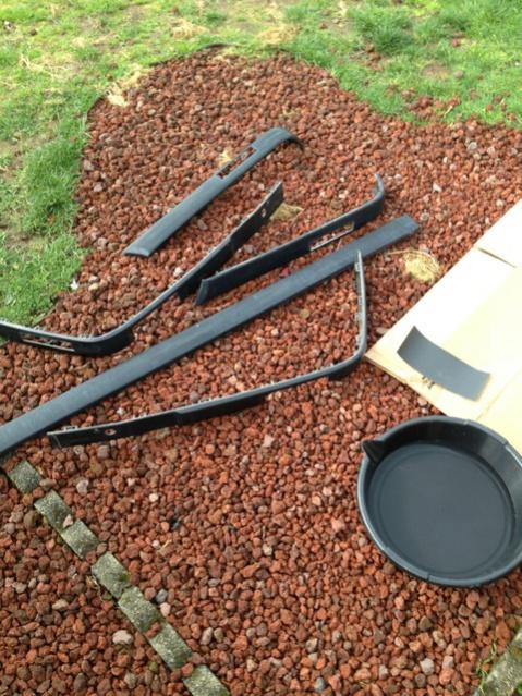

          Used some black trim paint.. Looks good I think.

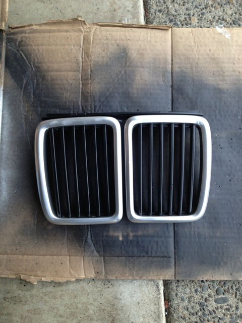

          Repainted those chrome.. So it's all shiny.
          Looks brand new! Mmmm

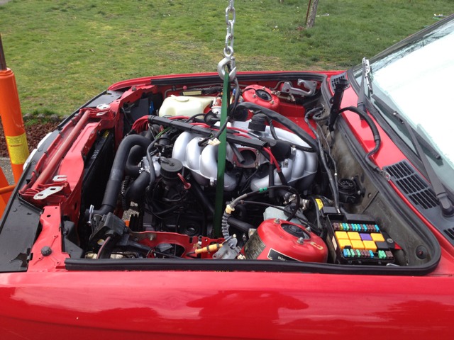

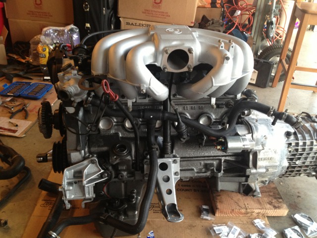

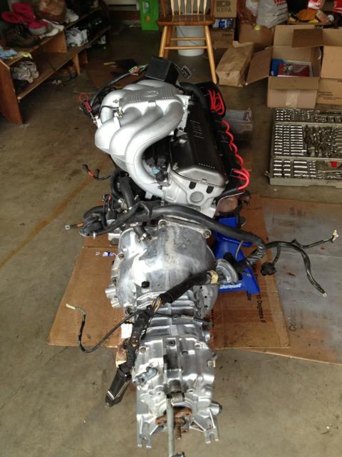

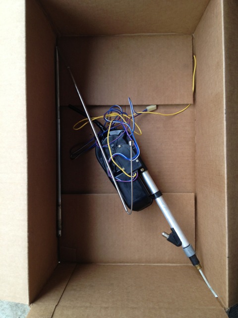

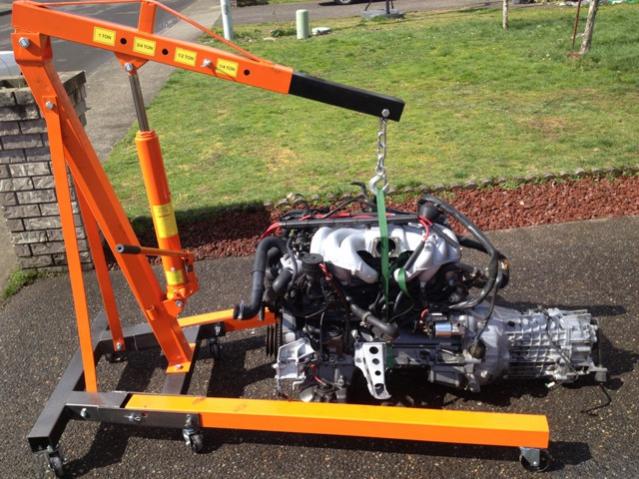

            Put in the harness.. Can't wait to try an put her back in tomorrow!

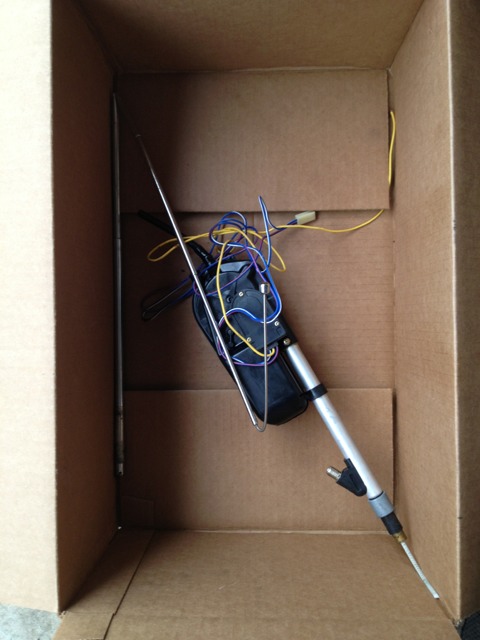

            Also... This is the bad antenna.. The new one works wonders:)

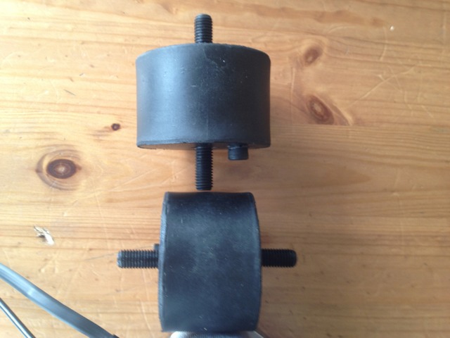

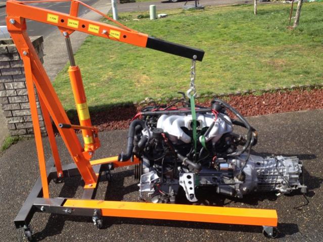

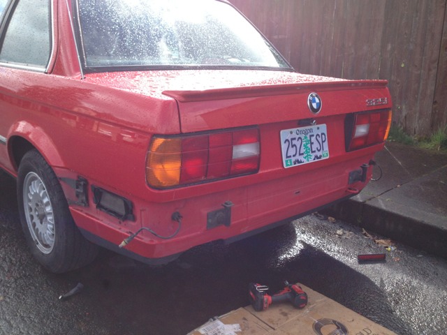

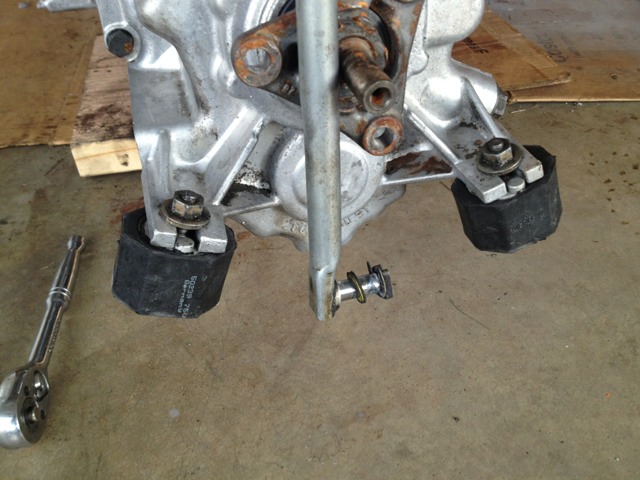

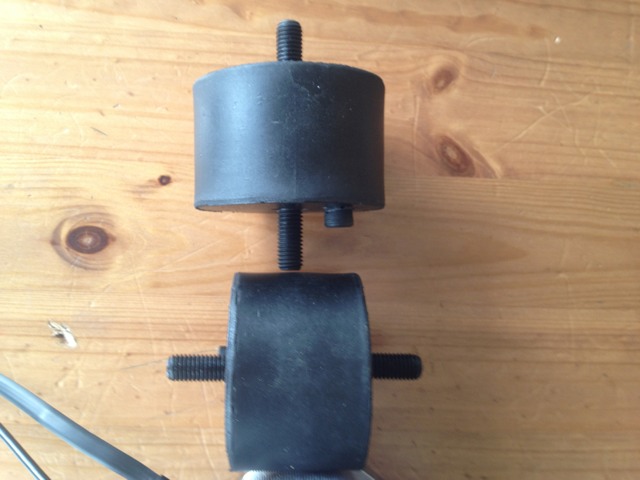

              Got some more done today... And also got my exhaust hanging kit from bav!
              Here some pictures!

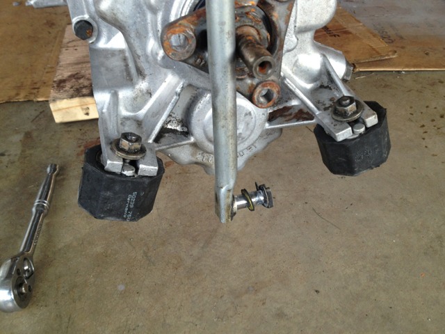

              New mounts

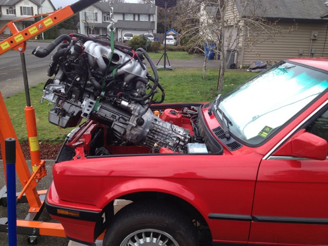

                  #38
ID:	7152930Click image for larger version

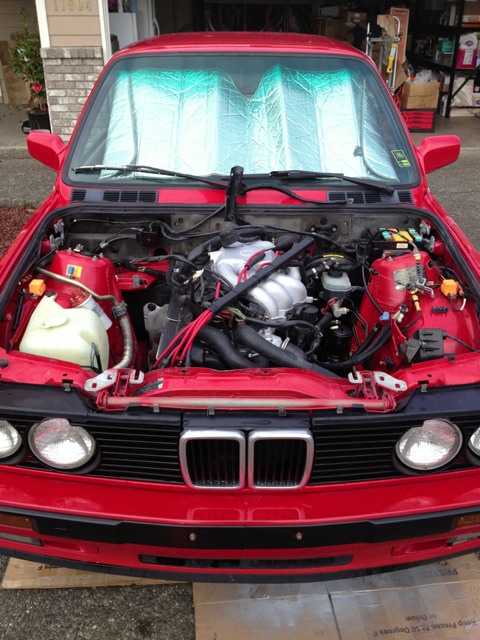

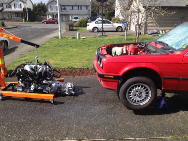

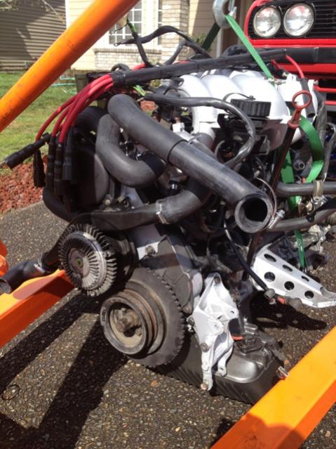

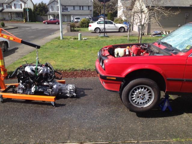

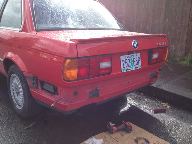

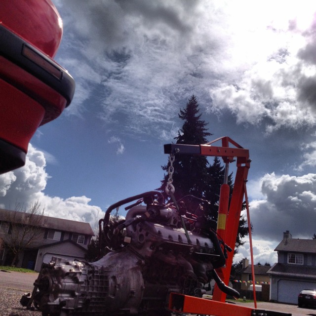

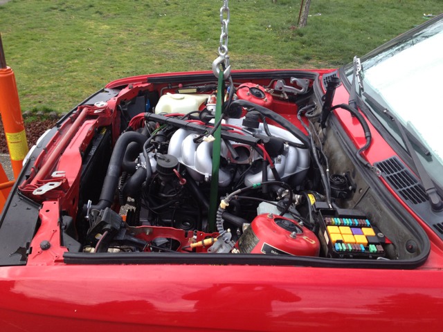

                  N she is in!!!
                  Left it for today!

                    i think you have more wheel gap than my jeep
                    suspension plans?

                      Awh your funny! I know! It seemed lower when I bought it? Hmmm.. But yes those are next.. Once I get some money saved up.. This little overhaul ran me dry.. Literally!
                      But yes next is shocks n adjustable GC springs. Wheels will be last:(

                        Don't use those sparkplugs.
                        W8LCR+ or NGK ZGR5A.
                        • MT325is
                          • May 2012
                          • 1103
                          #42
                          ^care to explain?
                          • sweet6e30
                            • Feb 2011
                            • 531
                            #43
                            Good job, and nice work. Im doing pretty much the same thing right now an a '90 Bronzit Basterd!!
                            to answer question about spark plugs, Platnium and Iridium plugs foul really easily and quickly. Keep in mind that m20 motors, run pretty rich at start up. if the spark plug tips come into contact with any contaminants ...... there goes your plugs performance. M20 motors really run best on copper core spark plugs. the bosch supers replaced the older kick ass copper cored plugs and are the proper spark plugs to run W8LCR+
                            the NGK ZGR5A. are good too.
                            a thing to also remember about spark plugs is the gap and heat range,
                            for Bosch the higher the number the hotter the plug and for NGK the higher the number the colder the plug,. Colder is best for Boosted applications.
                            The Bosch W8LCR+ plugs are a direct drop in, and are Cheap. like ~2-3 bux a piece depending on where you get them. No need to adjust gapping, only have to twist off the the end caps thats all, so the ignition wires seat properly to the spark plug.
                            Dont waste your money on platinums or irridium plugs, they are expensive and they dont even work well with the m20 motors at all.
                            Hope that helps.
