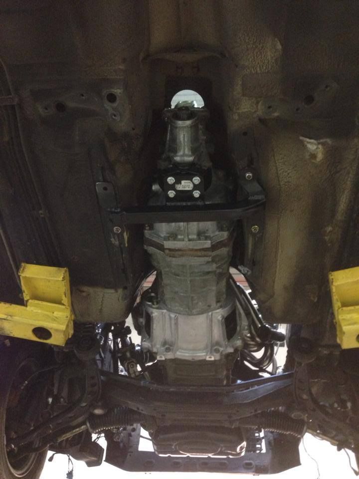

    So the polyurethane engine mounts came in and the engine mount brackets have been welded.
    Also a picture of the tranny support.

    So after we used a old block to create the engine and tranny mounts, we started to put together the engine that will actually be in the car. We are currently waiting for some parts for the clutch, but that should come in this week.
    What do you think about the turbo? hahah because racecar.
    And here a snap of the tranny.
