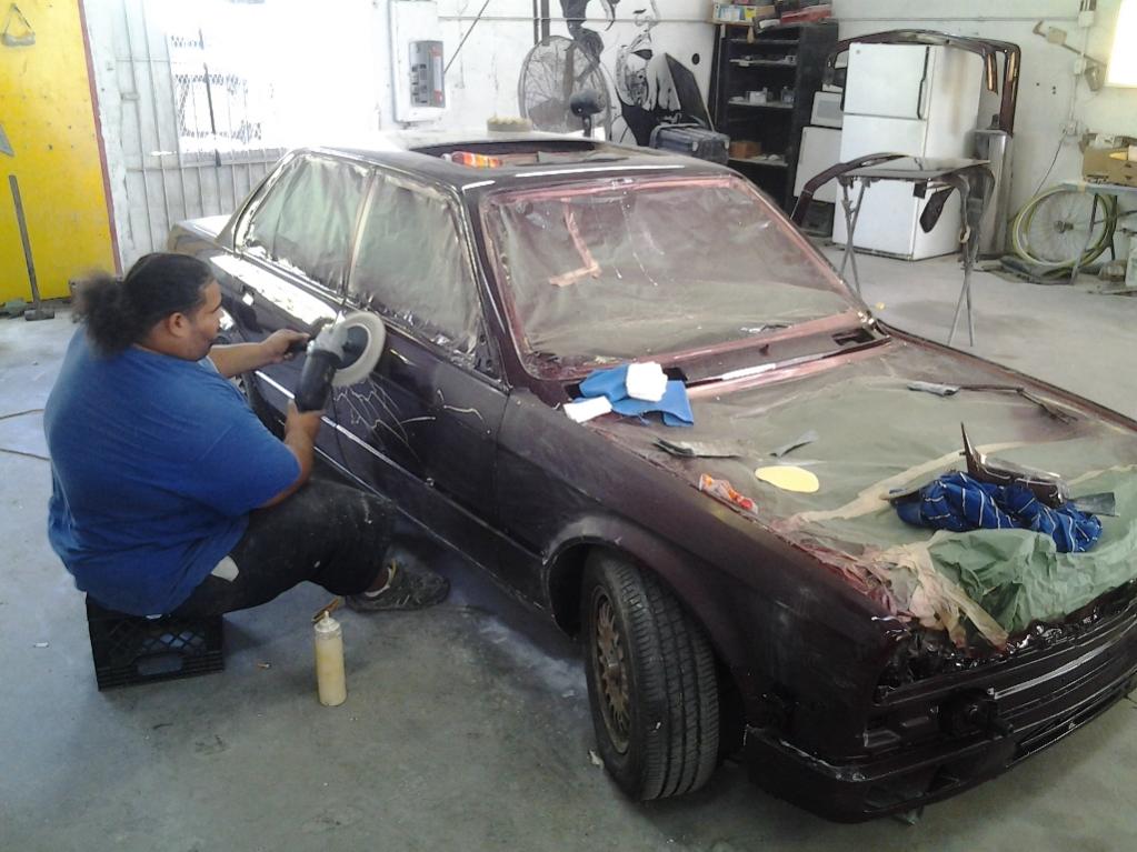

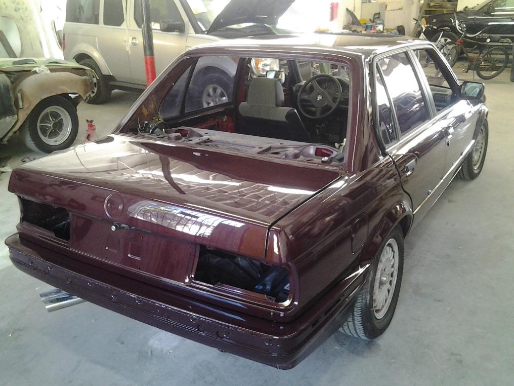

Should have got less paint, more clear... When you color sand and buff your cutting clear. So if it gets a scratch and you have more clear your more likely to be able to sand and buff it out. 3 coats of clear is a typical amount, but 10 coats of color isn't... And if a car has too much paint then it is less likely to last for a long period of time.
					my 325 build
gotcha, the guy who sprayed her said about a gallon of paintsigpic

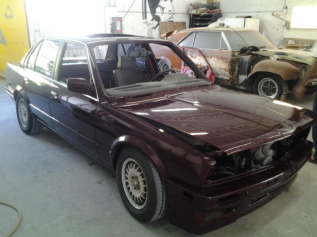

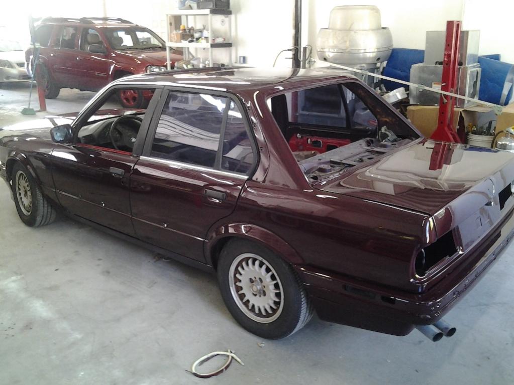

well i ve been a slacker with my updates....had the car back a week and started to put her back together with a new hood cable and an a hood alinement, tail lights went on and thats when i started noticing spots where the paint was chipped and and couple of spots where that were missed, found out the owners were have some issues with guy doing the work on my car needless to say he no longer works there and the owner is going to finish her up himself. dropped her back at the body shop on friday.

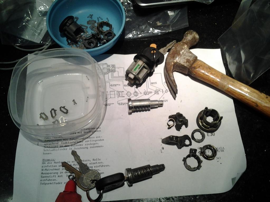

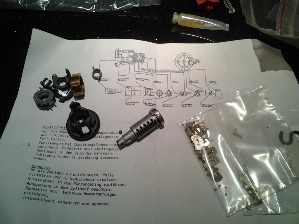

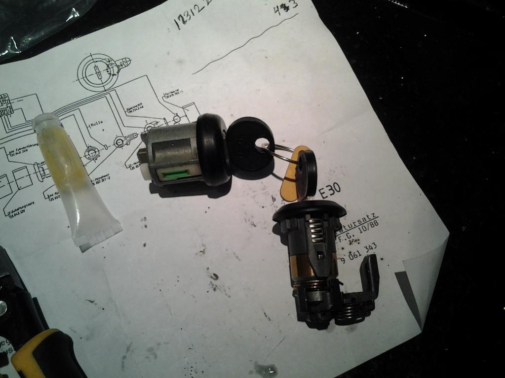

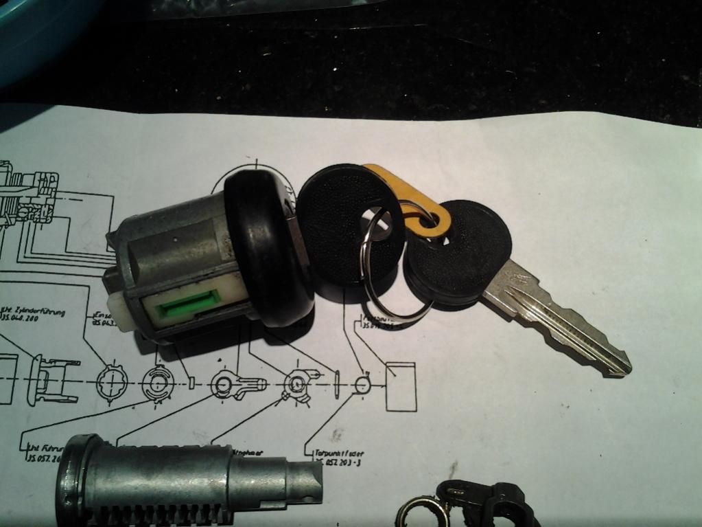

anyway while i was waiting to bring her back decided to re key the whole car. bought a key kit for the drivers door and decided to re key it to a new key that i got a few years ago with an ignition lock. passenger, trunk and glove box all got re keyd to the new key.

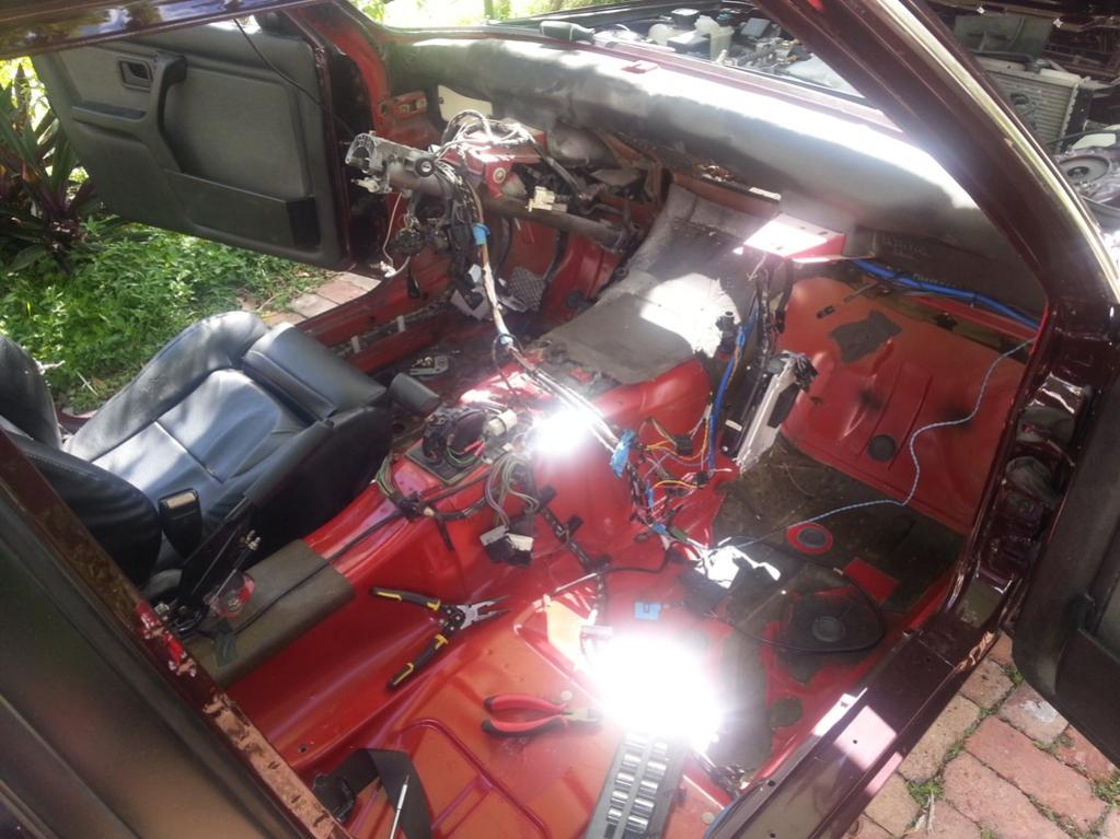

so a few months ago decided that I was going to replace the carpet due to the tear near the foot rest and proceeded to cut it out around the heating core only to discover that the floor was rusted pretty bad around the gas pedal. l had it repaired by the guys who painted her. figured out that one of the heating pipe was badly corroded and knew that was the cause of the floor rusting.
Had found a 4 door at a salvage yard that hadn't been touched yet, it was like winning the lotto, and went to work stripping her of all her goodies. ended up spending 7 hours over two days taking parts off her.
here what I got

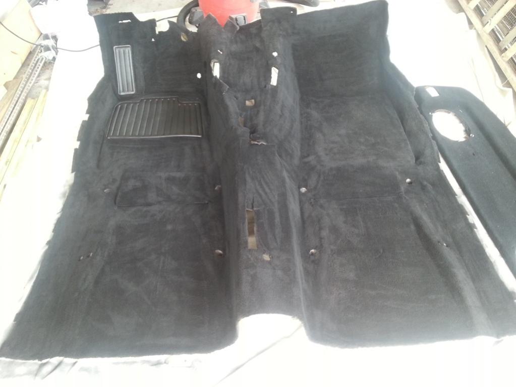

carpet - washed and painted black
headliner
4 door seals
heating core pipe with valve
rear seat with head rests
door cards
interior lights with plastic housings
cluster
here is the carpet painted black
had the dash out and back in with the carpet nicely installed underneath the heating core in one day. practiced removing the dash and heating core carefully on the 4 door at the yard so I knew what I was doing when it came time to do it on the old girl
and had repaired the heating core pipe and valve while it was out
got to say I was nervous taking the dash out but really wasn't that bad. if your going to replace your carpet it is well worth itsigpic
