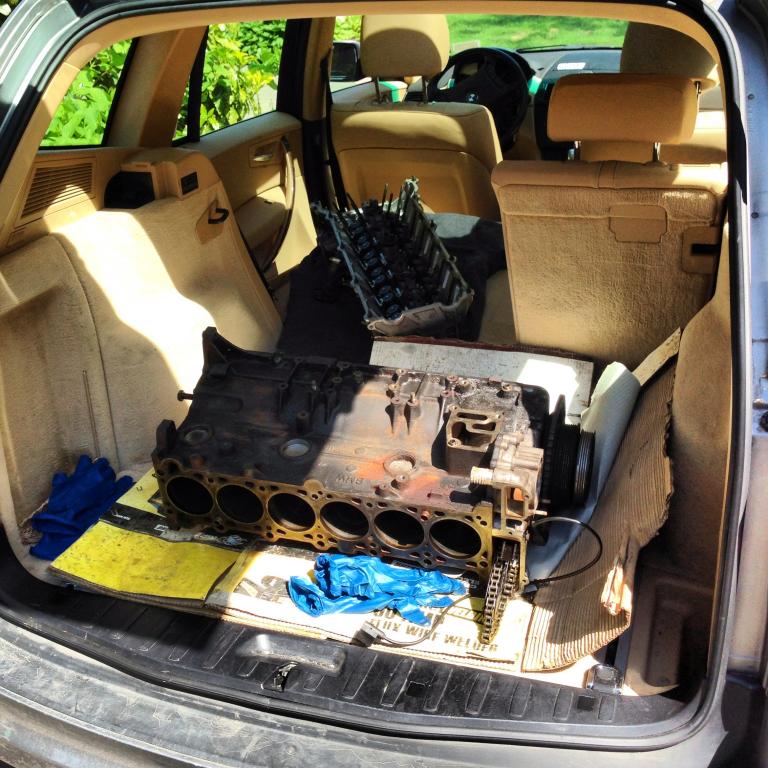

    The car started off as an m20 with an automatic trans. I bought this car last summer with the intentions of swapping in an s50 that I had from a previous car and obviously converting to manual. I decided to tear down the s50 and sure enough the pistons were all chewed up and there were 2 inch sections of piston rings that were gone. Instead of dropping the car in n.a. I made a decision to build it for boost.

    So far I have pulled the stock motor thursday and sold it to a local mechanic. Anybody have a good way to get rid of auto transmissions? I have had one for years that no matter how hard I try I cant sell. And now I have another...

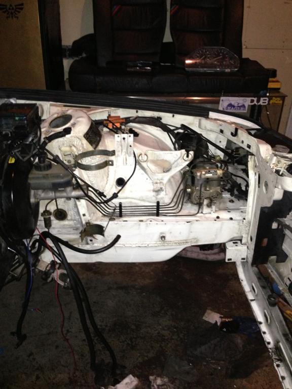

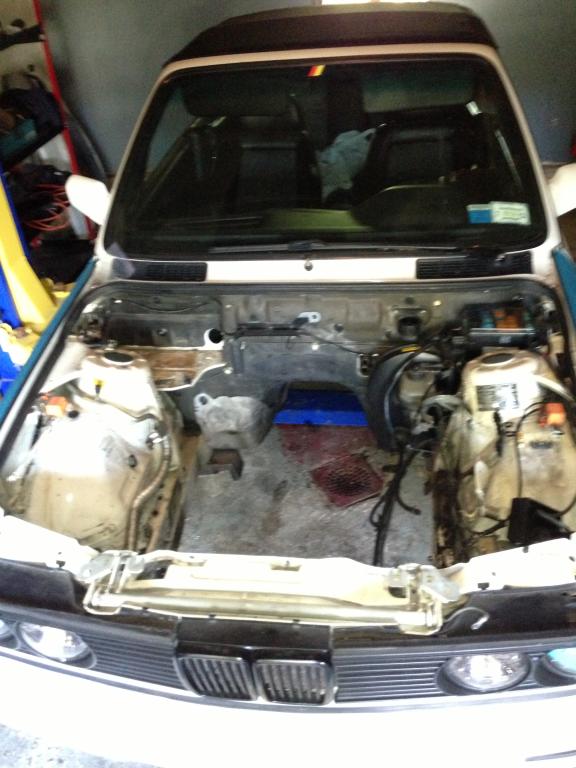

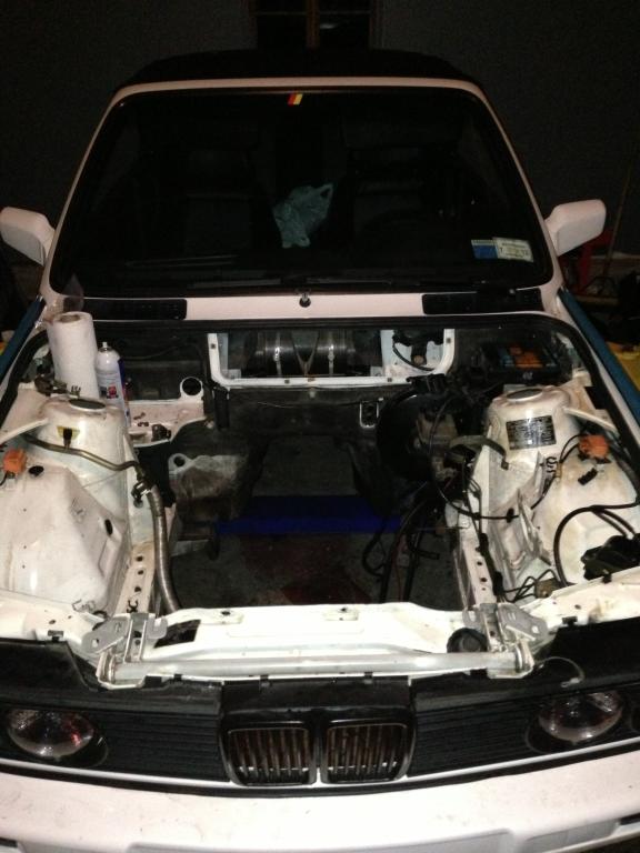

    Before cleaning the bay
Name:	2013-05-17 16.55.28.jpg
    And after several hours of cleaning(still not done)

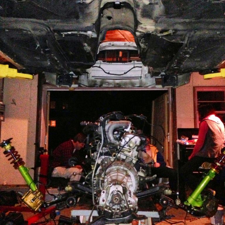

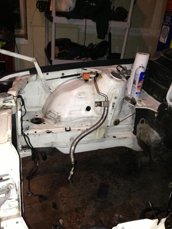

Name:	2013-05-18 20.33.27.jpg
Name:	2013-05-18 20.34.01.jpg
Name:	2013-05-18 20.34.12.jpg

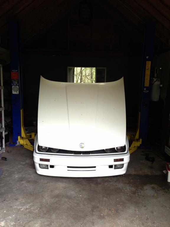

            A couple misc shots of the car
Name:	2013-05-11 15.34.41.jpg
Name:	2013-04-17 13.49.52.jpg
